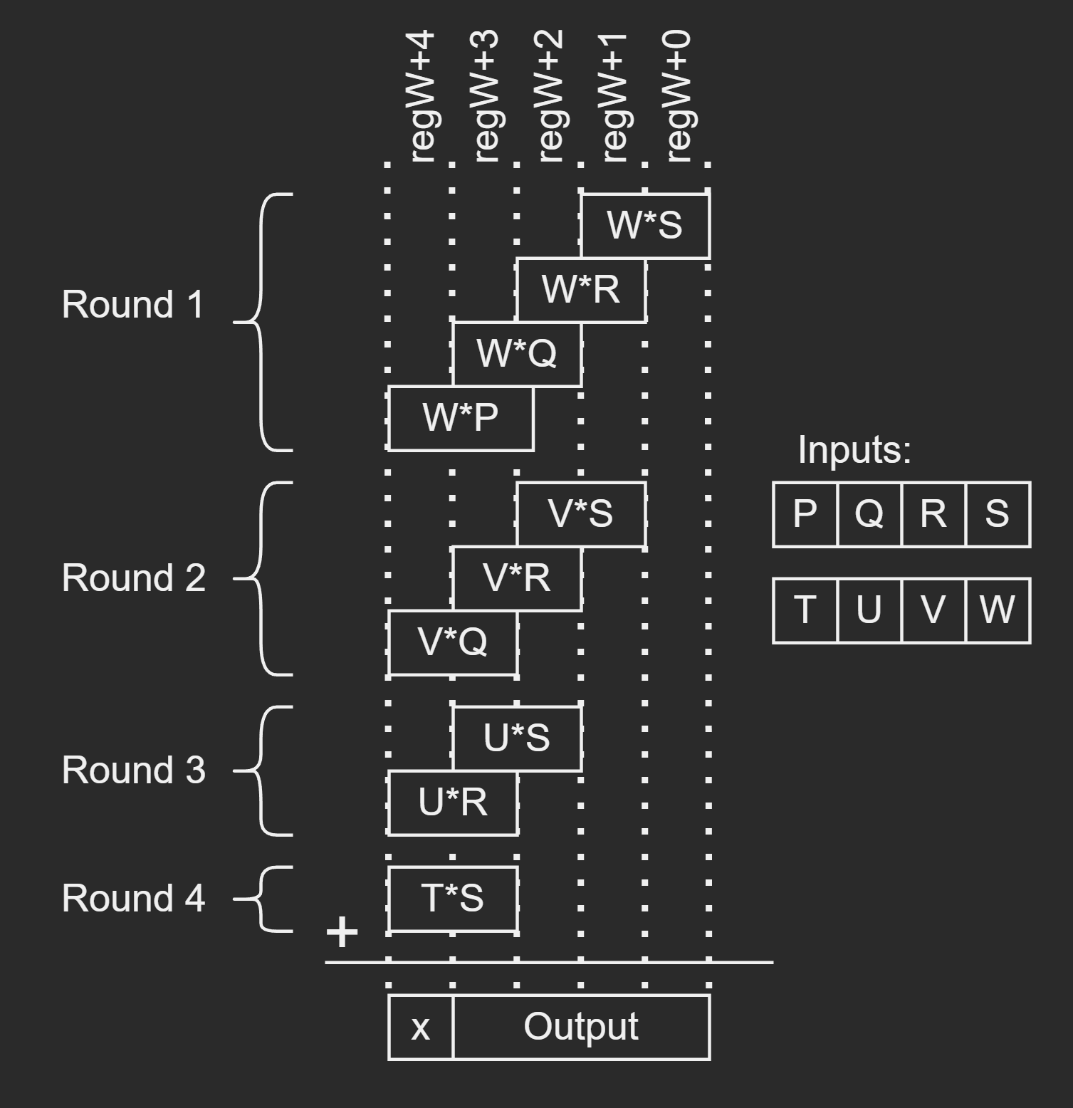

i tried to make a small diagram to better understand what is happening, is this correct for drogon's code?
(i used https://app.diagrams.net/ in case anyone was wondering. it's very useful to just quickly throw together something and have it looking "good enough")

regW here is 64-bits wide - that code is "optimised" for a 32x32 multiply to give a 32-bit result, so it's truncating the last (overflow/carry) byte.
The way it works is the same as my school-days long multiplication, so there it was Hundreds, Tens and Units, Here it's er. bytes. (as I have a "hardware" 8x8 lookup table multiplier)
; 32-32 multiply of
;               P  Q  R  S
;             x T  U  V  W
PQRS and TUVW are 32-bit hex numbers - with each 'digit' being $00 through $FF, so it might be: $12345678 where P = $12, Q = $34, R = $56 and S = $78. (ie. each letter is a byte)
Here I start with 'regW' being all zeros. Multiply P Q R S with W and put the result into regW, so
regW[0] = W * S
regW[1] = W * R + carry
regW[2] = W * Q + carry
regW[3] = W * P + carry
The next line, er move up a place, like putting a zero down under the S,W column, here it's a byte to the left.
regW[1] = regW[1] + V * S
regW[2] = regW[2] + V * R + carry
regW[3] = regW[3] + V * Q + carry
At this point, in that code, I abandon the final step as it doesn't contribute to a 32-bit result, but if I needed the 64-bit result, I'd do the last stage:
regW[4] = regW[4] + V * P + carry (noting that the add would be redundant, but I use a macro and I zero'd regW to start with)
And so on.
This: https://www.mathsisfun.com/numbers/multiplication-long.html has a sort of animated version of decimal long multiplication, rather then decimal digits 0-9 we're using hex numbers 0-255.
I think your diagram is on it's side.

honestly i haven't done long Multiplication in such a loooong time, that link was actually helpful in getting a better understanding of it!
no it's right side up, it's supposed to be regular addition with the line and plus sign at the bottom, each square represents a byte, so the 1x2 rectangles are the 16-bit results from the 8x8 multiplication of the 2 values inside of them. and the 1x4 rectangle at the bottom is the 32-bit output.
but it was still wrong, so i adjusted it and also added some "byte lines" and specified the "rounds" to hopefully make it a bit clearer.
so i assume a full 64-bit result version would look like this (ie the same but without the truncated multiplication "rounds"):

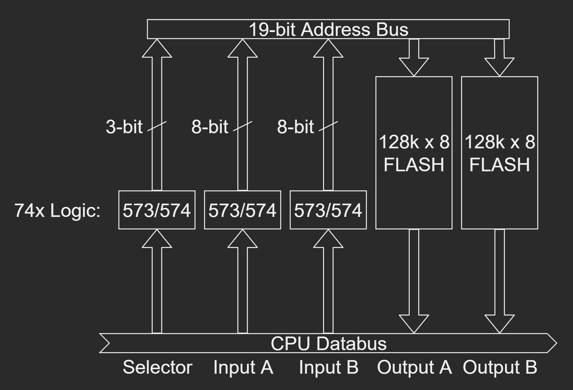

and speaking of lookup tables, i have been thinking about how cheap it would be to use 2x SST39SF0x0 FLASH ICs to hold lookup tables for some math operations and then use a few octal D-Flip Flops to access them (and select between multiple "operations" like 8x8=16 MUL, 8/8=8r8 DIV, maybe even 16->16 SIN, COS, TAN, etc) so the whole thing only takes up around 5 Bytes in memory instead of 256kB-512kB. making it also useful for a 65c02 and avoiding the need to manually calculate the values at runtime.
