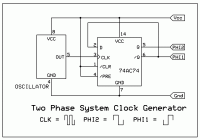

Your clock generator is likely not producing a signal that meets WDC’s requirements due to the use of 4000-series logic.  I recommend you use a single 74AC74 or 74AHC74 flip-flop, driven by the oscillator, to generate Ø2.  The flop will produce the required rise/fall time, as well as a symmetric output.  See here for some working examples of clock generators. Can I put a 74LS74 (I have 1 in my parts bin) on the 4000 series output to bring it into line with WDC's requirements?
Please reread what I posted about recommended logic families for clock generation.  :D
WDC MPUs are somewhat fussy about clock quality, even at low frequencies.  Ø2’s rise/fall time should not exceed 5 nanoseconds, and should be at CMOS levels.  That means Ø2 high should be at least VCC × 0.7 and Ø2 low should be no more than 0.3 volts above ground.  The VCC × 0.7 requirement is not reliably achievable with 74LS logic (VOH with 74LS logic is theoretically 3.4 volts, unloaded, with a guaranteed VOH of 2.4).  Hence the 74AC/AHC recommendation (74ACT/AHCT will also work).  Slow clock edges and/or insufficient voltage swing may result in unreliable operation or outright failure.
Here is the clock circuit I have used in several of my POC designs:
File comment: Clock Generator
The above would replace the 4000-series devices you have in your present clock generator.  The Ø1 output wouldn’t normally be required in a 65C02 circuit.
I recommend that you not use 74LS logic with WDC devices.  Although the WDC 65C02 seems to be fairly forgiving about what it will accept as valid input, Jeff’s (Dr Jefyll) tests confirmed that the 65C02 and 65C816 are not TTL-compatible—their perception of where a logic transition occurs is slightly above VCC × 0.5.  That threshold is well above the guaranteed VOH output of a typical 74LS device.
