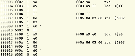

Hi everyone — new to the forum, and inclined to hack first and ask questions later, so am probably doing a lot wrong — be gentle.
I have dedicated this past week to building a breadboard 6502 around the W65C02S CPU and I have a mostly satisfactory set up with in-circuit reprogramming of the ROM, three clock generation options, and a debug monitor that shows bus activity and disassembly as I step cycle-by-cycle through the program (see attached image of the monitor).
So the things I need to complete the project are a video display and keyboard, and I plan to do the video display card next on an RP2040 embedded in the Raspberry Pi Pico dev board. This will either speak VGA or MDA to a connected monitor (I hope to get MDA working but have an example of working VGA which may distract me into that path first). The video card will provide a simple text mode - perhaps 80x60 lines or similar - and it needs to read the characters that are going to be rendered into the frame buffer by DMA from the RAM of the 6502 system.
I've built the basic system so that when the clock is low it is possible to bring BE low and then enable the RAM chip, and read RAM in the monitor in this state. The plan is to use this same method from the video card pico, but the RDY pin documentation in the datasheet says "A negative transition to the low state prior to the falling edge of PHI2 will halt the microprocessor with the output address lines reflecting the current address being fetched. This assumes the processor setup time is met. This condition will remain through a subsequent PHI2 in which the ready signal is low. This feature allows microprocessor interfacing with low-speed memory as well as direct memory access (DMA)." (Jan 2022 version) It doesn't seem to specify the state of the address bus if RDY is disabled when the clock is already low.
I seriously don't understand what they're trying to tell me. How does the processor asserting the address bus help me with DMA? The behaviour I'd want is for the bus to be in high impedance mode so that the video card can be the bus master(*). The mystery pins page on Garth's site didn't enlighten me either.
My tentative plan is to use Φ1's rising transition to disable BE and RDY, control the bus for as long as I need to (but ideally be done before the rising edge of the Φ2 clock), and then restore BE and RDY, doing the video RAM DMA entirely during the low phase of Φ2. Worst case scenario I miss this target and the CPU misses a cycle, a situation I can catch in the video card and log in some way so that I fix it.
The question is: is this approach workable, or if not, what's wrong with it? Alternately, even if workable, is there a simpler approach that I'm overlooking?
Thanks in advance for any pointers.

File comment: My 6502 monitor output as I step cycle by cycle.

RDY and BE are separate features. RDY controls the internal state, and has no effect on the external signals. BE controls the external signals, and has no effect on the internal state. To do DMA, you want to use both: pull RDY low to halt the processor, and BE low to remove it from the bus. (Why are they separate? RDY is also used to pause the processor to give slower memories a chance to respond. You want the bus to be driven during that)
RDY can be a tricky signal to use. When they say "A negative transition to the low state prior to the falling edge of PHI2", they're telling you how to use it. Pull it low at the right point in the cycle, and the processor will halt. Pull it low at the wrong point, and anything could happen. So don't do that.
And on the 65C02, it's also an output. The WAI instruction can pull it low regardless of what your external hardware is doing, and it's probably safest to use an open-drain output with a pull-up resistor. Even if you don't intend to use WAI, if there's a bug in your code it might run away and hit one anyway.
Controller / Peripheral seems a popular alternative.

It sounds like what I might want is to just pull BE low and be sure that I am done with the bus before the next rising edge of the clock - if I pull BE low when Φ1 goes high, and restore it before the next clock pulse, that should enable DMA during that window?
I don't really want to halt the processor, I'd like it running at full bore while the display gets the frame buffer between cycles.

John West gives a good answer on BE and RDY.  I will just add, based on what you imply in the head post, that you must give the address lines and address-decoding logic time to become valid and stable before Φ2 and R/W\ allow any writing to memory or I/O (as mentioned in the address-decoding page of the 6502 primer).  Otherwise you could corrupt addresses you didn't intend to write to.

In that case, yes, only BE is fine. The 6502 only needs the bus during half of the cycle, and you can do what you like with it in the other half. This was very common for doing video in the home computers of the 1980s.
One more thing to watch for: BE also tristates RWB. You'll have to pull it high while you've got the bus, or your video might end up scribbling all over memory.

If you want to just access memory during phi2 low, you can just use BE to tell the CPU to relinquish the bus and you can control it. In earlier CPU variants without BE this was done with address bus multiplexers.
What you need to make sure is that one the address lines become active - on either switchover - select logic needs some time to get valid, and you need to make sure you don't get any spurious accesses. I think that has been mentioned above.
One way to do this is to create a phi2d that is delayed at least as much as the longest delay in the select logic. Then allow accesses only when both phi2 and phi2d are high. This has been done for connectingba VIA6522 to the C64, as the C64 shares the bus between phi2 low = video and phi2 high = CPU - but the VIA requires valid addresses at risongg phi2 already.
Delaying phi2 can be done with various methods, e.g. shift register clocked with a higher clock.
