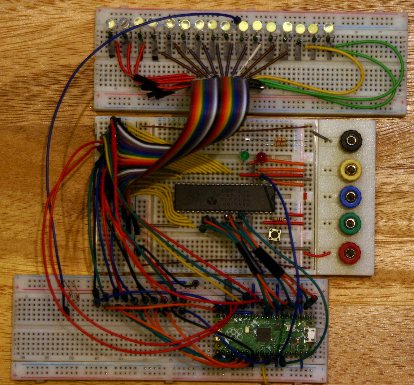

Hey guys.
I'm hoping that a picture paints a thousand words and that this will pretty much tell you what you need to know.
What is absent here (because I had to move the rig to a different location, in order the photograph it) is the power and ϕ0 IN hook-ups.

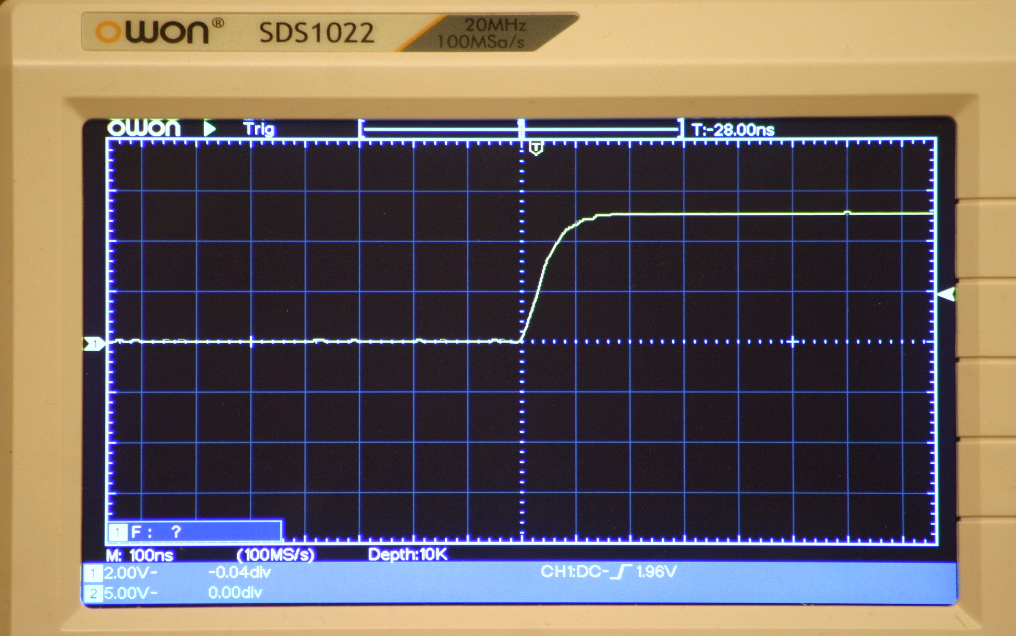

Here, you can see what the ϕ0 IN signal looks like. It's up to TTL logic levels well inside of 50ns (sorry, I've got the scope set at 100ns per division; opps), the peek voltage is 5V and it's a nice clean signal.
What else can I tell you? I suppose, if something is not clear, you'll ask me and I can post back. Given time, I'll better understand what you guys need, without you having to ask.
These are medium resolution pictures, as I didn't want to burden the servers with high res, but I think that they should be good enough for you to be able to see enough detail, without a circuit schematic, which would take me hours to prepare, given that I like to have things as good as I can get them, and I've never prepared a schematic before.

BTW, in the photo, I don't see any bypass capacitors located nearby the 6502. It is in your interest to remedy this, as it may be causing trouble we haven't yet pinned down. Signing off for now,
I don't fully understand what this means, but I will take steps to find out. I trust that you'll advise me, if I can't figure this out for myself.
I, once again, thank you for your time, your trouble, your excellent input, as well as taking an active interest in what I'm doing. I'm sure that I'll need more help, as I move this project along.
Thank you, Jeff, for pointing to this. I found a bunch of very useful threads about this topic, right here, in these Forums.
As should be very obvious, I have next to zero experience with building electronic circuits, but with this build, that will change. As you can see, from my posted pics, I bought myself a Digital Storage Oscilloscope (as I 60th Birthday treat), which I see as an essential part of my test equipment. I've not had it for long, and using it for this build will teach me how to use the scope.
