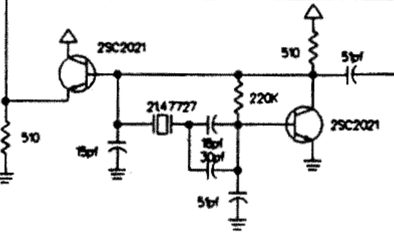

Does anyone know how to clock A Ricoh 2A03 "NES CPU" with an Arduino UNO. I was on this forum and saw someone with the same problem but, he just copied the NES clock. If anyone can help me thank you.
Links
Deceptive Forum: https://community.element14.com/technol ... k-and-2a03
PS
NES clock file below.
File comment: File of NES clock.

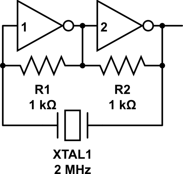

It looks as if the person who "copied" the circuit copied the wrong transistor ;)
the original circuit passes the clock signal to two circuits, but it can be simplified or a functional equivalent designed.
For example this one
https://www.circuitlab.com/editor/#?id=77hzacxtnxer
