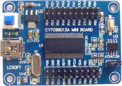

I picked up two inexpensive logic analyzers from Amazon. An 8 channel one, and a 16 channel one. Both of these boards use the open-source Fx2lafw firmware. The 16-channel one is the same board recommended for use with Hoglet's decoder, since you really need 12 channels to get the best results with it. The 8-channel board came with a USB cable and some female/female Dupont wires. The 16-channel board came with... the 16-channel board. Neither board had any kind of manual so I had to dig around through a whole pile of excessively bad documentation to figure out some basic things. In particular, the Lcsoft Mini Board is just a devboard with all of its microcontroller pins broken out into headers. It's not immediately obvious which of those pins are used by the FX2lafw firmware as the logic analyzer channels. At long last I found what I needed buried in this guide:
Note that pins PB0-PB7 and PD0-PD7 on the board act as channels 0-7 and 8-16 respectively.
In order to capture data for Hoglet's decoder to decode you need some software such as sigrok-cli or PulseView to communicate with the logic analyzer hardware. This is where things get sticky. The SIGROK project appears to have been all but abandoned. The SIGROK wiki suggests that for best results you should use the NIGHTLY build packages, rather than the stable release versions. Unfortunately, the nightly build links on the SIGROK downloads page have been broken since February 2023. That page suggests using an Archive.org snapshot to download nightly builds from December of 2022. Unfortunately, those Archive.org links are also corrupted. So I spent the next three days typing into my MacOS terminal trying to trace the dependency chain in order to build from source. (I could have done this with one command in Ubuntu! :x ) The SIGROK wiki suggests that the best (only) way to do this is to use Homebrew, which failed immediately for me. I went through a whole process of cloning git repositories trying to build the dependencies by hand, and finally determined that the actual problem is that two upstream packages (QT5.5 and Python2) have dropped support for MacOS Catalina. :evil: And... that's pretty much where I am right now. I can't use sigrok-cli (there is no release version of it for Mac) and the release version of PulseView (0.42) is truly truly awful. As in, can't type into configuration fields because all keypresses are captured and interpreted as navigation commands for the main window, awful
The laptop I normally use for my retrocomputing activities is a Thinkpad X41. It *does* have USB 2.0, but it only has a 1.5GHz Centrino processor and 1.5GB of RAM, so I'm not sure it will be able to keep up. I guess my next project is to install SIGROK on it and find out!

I got that 8-channel Saleae analyzer to work with sigrok under Windows 10, but my Hantek USB scope doesn't work with sigrok. The bundled Hantek software is adequate though.

The other, arguably better, option for capturing data from a FX2-based logic analyzer is a standalone program called fx2pipe written by Wolfgang Wieser.
fx2pipe allows the FX2 to be clocked from an external clock, which would typically be the 6502 phi2 clock. One sample is taken per 6502 bus cycle, at exactly the point data bus is stable (i.e. on the falling edge). This greatly reduces the volume of data that needs to be captured. It's not possible to use this mode in sigrok. I rarely use sigrok myself now.
Here's the original website:
http://www.triplespark.net/elec/periph/ ... 2pipe.html
I have included a slightly modified version of fx2pipe in my 6502decoder repository:
https://github.com/hoglet67/6502Decoder ... er/fx2pipe
I use this program on Ubuntu 18.04.
To enable the external clock capture mode, you need to:
- connect Phi2 to the RDY1 pin of the FX2
- connect the PA4 pin of the FX2 to ground
- pass the -a option to fx2pipe

I actually have two boards.
With the jumpers off, they both report 04b4:8613, which is the ID in the Cypress FX2. It's this ID that the USBTEST kernel modules binds to.
With the jumper on, they report whatever ID is programmed into the SPI EEPROM:
- Board #1 (bought in 2017 from Hobby Components) reports 1D50:608D (Sigrok 16-bit capable FX2)
- Board #2 (bought in 2019 on ebay) reports 0925:3881 (Salea Logic 8-bit capabile FX2)
Both of mine look like this:
Can you post a photo of your board?
Looking on ebay, I can find some versions of this board where one of the connectors is labelled differently. For example, RDY0 and RDY1 are swapped, and one of the 3V3 pins has changed to be a GND pin. I'm wondering if this is an error on the silk screen, or whether these are a real pinout changes.
In particular, can you check that the RDY pins are connected to the correct pins on the FX2 chip itself? RDY0 should connect to pin 8 and RDY1 should connect to pin 9.
The full set of signals to configure the FX2 to capture using an external clock on RDY1 is:
- PA5 = high (FIFOADR1)
- PA4 = low (FIFOADR0)
- PA2 = high (SLOE)
- RDY0 = high (SLRD)
- RDY1 = Phi2 (SLWR)
On my board unconnected inputs seem to float high, so I have only needed to jumper PA4 to GND. But it's possible relying on this is dodgy!
Dave
