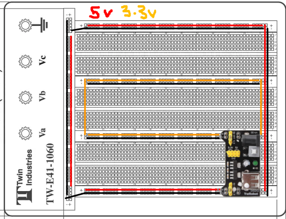

Twin makes a good product.  Be aware however that the metal backing does not qualify as a ground plane for this kind of work.  Not at all.  I'm not in favor or using solderless breadboards for this kind of work, and the parasitic (unwanted) inductances produce a certain percentage of mysterious and frustrating failures that the newbie has a hard time understanding when the connections are schematically correct.  But if you feel you must go that route, take the advice in the first point of the AC performance page of the 6502 primer at http://wilsonminesco.com/6502primer/construction.html, especially in the few paragraphs starting with "If you really must use solderless breadboards,".  It could save you a lot of grief.  We want you to be successful.
So for where I am now, I think it should be okay. I like circuit bending and tinkering so it will get a lot of use.
Based on what I read, I think I do want to go ahead and get a 1-4MHz Can, it sounds like there would be 'interference' or such trying to use a 12MHz clock on a breadboard. Still not deadset on what speed to get, 1MHz is just kinda nice really, though Id like to be a bit faster for the display...
this was already my plan for layout, I like the backplane for ground as much as I do for having a solid thing they will not move around on. Actual ground wise, its better than the air. Probably. I am trying to not be on mains at all if possible and only run on batteries, usb etc. though a wall wart exists too...

The MHz is not the problem.  The problem comes from the fast rise times, ie, the short amount of time it takes an output to swing from a logic 0 to a logic 1 or vice versa.  Jack Ganssle's YouTube video, "I Only Probed the Board With a Scope - Why Did My Board Crash?," the part from about 2:20 to 3:00, graphically shows on a high-end oscilloscope that the ugly ringing remains unaffected as he turns the clock frequency up and down.  But if you mean having two clock frequencies on the same board, it won't be a problem if you do things right.
Not for this kind of work, since you cannot run each IC's ground pin down to the sheet metal below it, nor make the signal wires hug the ground plane.  Just connecting one corner of the sheet metal to ground somewhere will not improve signal integrity at all.  The phenomena at play at these rise times are entirely different from what goes on in audio circuits.
The attachment breadboard layer 1.png is no longer available
Now add these connections I drew in:

The MHz is not the problem.  The problem comes from the fast rise times,...Jack Ganssle's YouTube video, ....
Ok, noted,
so after looking around, for my first build on the test bench here, the "proof of concept" is going to use HC series ICs.
I am also planning to run at 1-2 MHz, certainly 5 MHz or less based on what I can order easily. I rather like just getting a nice 1-2 Mhz "Can" for the breadboard stage.
yeah totally. a couple of those corner connections were already in the plan, and I get what you mean about the rails across the middle of the board.
I also looked at several articles, gifs and videos on debouncing and line interference from resonant frequencies and similar topics.
there are some debounce chips iirc, and the method of doing it with discrete components did not look difficult from a glance. "nothing fancy" needs to be done. I was planning on using an old PSU from a kiosk I picked up somewhere. Its a modern switching PSU that uses standard "PC Power Cables" and some molex connectors. It has GND, and 24v, 12v and 5v lines plus a 'battery' line for something or another. There are 3 different connectors, one just has GND and Battery +/-. The other has 24v for some speakers I think, its labeled SND. I might use that when I get to the USB C 20v charger stuff or similar "high voltage" needs. For the moment, I was going to use the connector that has +/-12v, +/- 5v and two GNDs. I was also going to tie a few different places to the metal backplane, not just a corner. I have a really nice metal base plate that came out of a National Weather Service station that had been decommissioned I got from one of my ex-girlfriend's dad. He fixed F-18s on a boat for 20 years and taught electronics. I used to hang out with him and talk shop on service calls at different site. I got a standard server racks that breaks down to a shoe box for storage too. I was told this particular piece of metal would make a good ground plane for electronics work. Looking at it, Im going to say its probably a specific alloy, poured at a certain temperature and cooled a certain way so the metal crystalline matrix is certain size or grain. Im not an welder or blacksmith or anything though. Something about how it feels and sounds in my hands. Its not like a lawnmower blade or scaffolding.
Anyway, tying the TwinIndustries breadboard to a NWS/NOAA radio baseplate in multiple places (and using other bypass and decoupling techniques) might help mitigate (though are unlikely to ameliorate) the problems associated with such hardware. After reading up on Wire Wrap technology, which belongs in an episode of the Outer Limits and about the Twilight Zone of alternate reality, I have great respect for it and the craftsmanship involved. I am currently learning to sew and bake; I plan to stick to breadboards and then probably perfboard or just custom PCBs. There a 'desktop CNC mills' now, and conductive 3d filament, I might try picking up a nice desktop mill for PCB work. Idk, maybe Ill build one the uses a 65xx mcu as a controller.
For the moment, I'll just use the breadboards. Ill stick to HC series CMOS and avoid TTL chips or anything built for high speed. I might try some wire wrap sockets when I move up to faster CMOS technologies; its a lot of extra tooling though.

The sheet metal below the solderless breadboards won't really do you any good at all, performancewise, unless you had a way to bring every ground pin down directly to it, like <1/4" below the IC pin, straight down through the bottom of the breadboard, ie, not going around the side.  It would of course be totally impractical.
