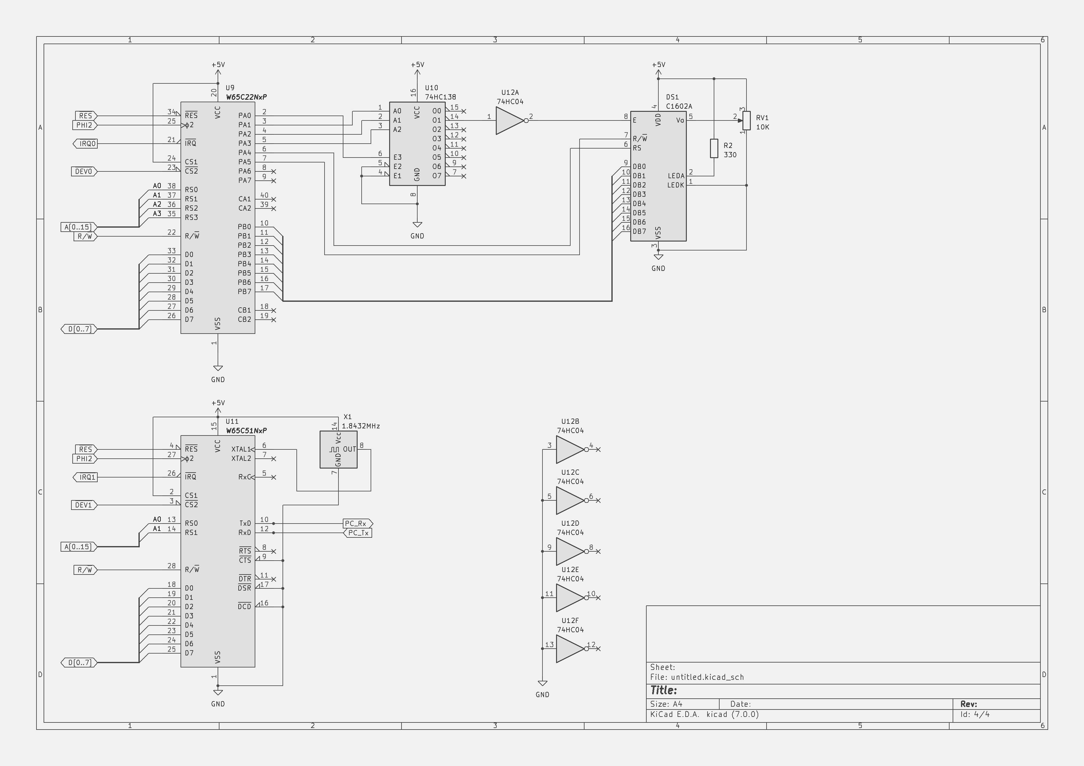

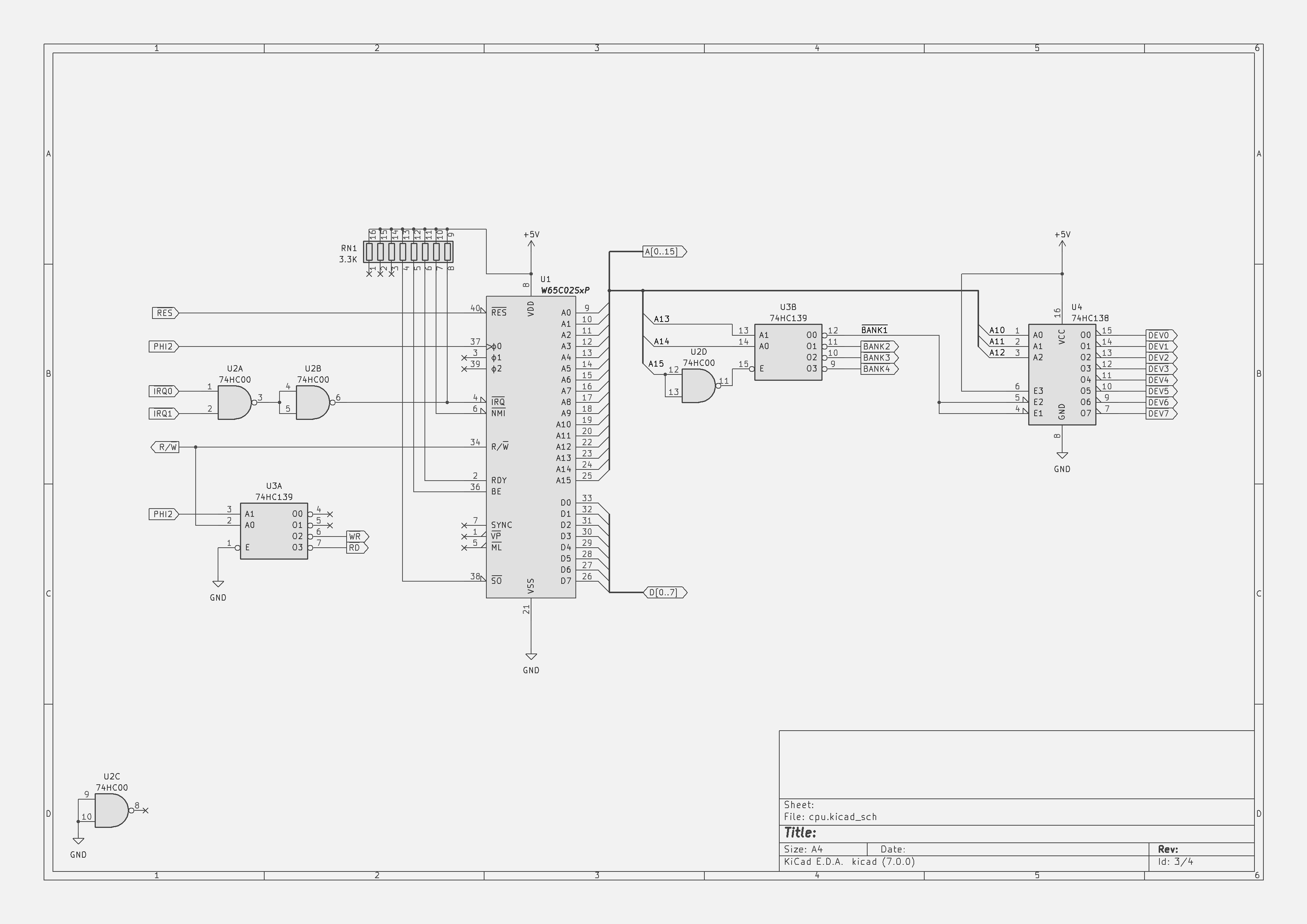

Okay,
Things are pretty stable. The only issue I've run into is that it seems that if I have the 65C51 hooked up to my PC in anyway, it prevents the 65C02 from starting. It works fine if I connect the PC after the 65C02 has had a chance to start.
I've tried using a DTECH USB to TTL serial converter cable as well as my Arduino Due as a dummy pass thru serial port, and both have the same issue. If they're plugged into the system before power on, the 65C02 won't start. I have to disconnect them and power the thing down (reset doesn't work) and then back up.
I've checked the power rails and they appear to be good. (The current power module is delivering 4.97V)
All other things being equal, the code is working fine and the system has been very stable with the replaced ICs and power module.
I've attached the current version of the circuit with my IO devices. I'm pretty sure I need to tie down some other lines on there before I move on.

A shot in the dark, but... is your interrupt routine in eeprom or does it vector through ram? I'm wondering if there may be stray characters in the 6551 input buffer causing an interrupt which isn't being handled correctly...

A good question, and one I had considered myself after I adjusted my serial program to output what it was reading to the LCD instead of looping it back. I saw quite a number of garbage characters come up when I had the serial port plugged in.
On the other hand though, it seems to not matter much if it's the receive line or the transmit line that's plugged in that causes it. Additionally, I don't think it's the interrupt line, as the 65C51 isn't (yet) connected to the IRQ1 pin on my NAND gates; that gate is currently tied hard to ground while I debug this stuff.
Right now my current working theory is I have some sort of odd grounding issue? I'll double check but I think I was able to reproduce by simply connecting the lines from the PC to some pull up resistors.
Pulling Up/Down the lines on the 65C51 end didn't have an effect.
I think the oddest part is that it works if I power on the 6502 w/o the lines connected and then connect them. At which point it behaves completely as expected (at least until I power it off)

Perhaps your valid address decoding is allowing a clash on the data bus for when the UART is selected. I will have a look through your design and get back. Cheers Mark

Always open to a critical eye to make sure I didn't make a mistake anywhere, though I think BDD got it right with my mixing of logic families. Moving to HC parts settled most everything out. As for the weird interrupt issues, that seems to have calmed down.
I did figure out that I needed a pull up resistor on the 65C02's INT pin despite driving it with an IC. This was some head scratching on my part as the 65C02 datasheet doesn't seem to mention the open-drain nature of this pin, but the 65C22 docs seemed to suggest you should be using IC gates to drive the pin now and not the wire or with a diode (for performance reasons). But the interrupts weren't working until I added a pull up resistor; so it would seem I still need to wire or the logic?
Would be nice to get confirmation on that before I add more devices to the mix. Or when I switch to TTL which would let me use the 16550 which I think would be a nicer UART to use.

I'm quite late to the party here....
Looking at the recent schematic pics, it appears you are using the W65C22N part along with the WD65C51N. Both of those parts have open drain IRQ outputs. As such, both parts require a pull-up resistor +5V. If you delete the two 74HC00 gates feeding the IRQ pin of the W65C02, you can just connect both IRQ outputs from the 'C22 and 'C51 to the CPU IRQ pin and all should be fine.

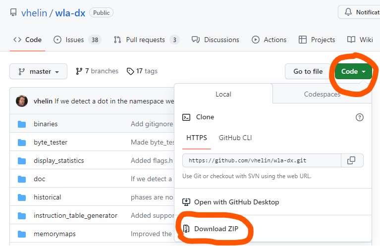

I don’t do GitHub. I can never make head or tails out of it. :D[/color]
The easiest way of handling this is to click the "Code" button/dropdown and choose the "Download ZIP" option; this will give you a ZIP file with the latest version of the code from the branch you're looking at. (The default branch you see when you go to the project, often called `master` or `main`, is usually the one you want.)
If you use Git, you can ignore all the GitHub functionality entirely and just clone the URL directly (git clone https://github.com/vhelin/wla-dx), treating it like any other URL (GitHub, GitLab, static site, whatever) that provides a Git repo via HTTP. I mostly do this, though I do find the ability of GitHub/GitLab/etc. to let you link directly to a page showing a file fairly useful when I want to show someone a particular bit of code without making them download anything. (And the ZIP download option is of course also useful for those who don't use Git.)
