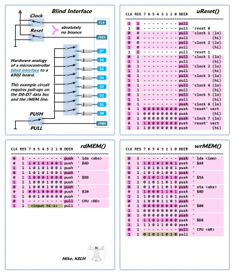

PostPosted: Tue Jan 10, 2023 9:19 am
Posts: 589
I noticed one anomaly (or feature?) while manually clocking a 6502 through the reset sequence using a microcontroller with a "blind interface" to the 6502. When I accidentally started the reset sequence with CLK lo instead of hi, effectively issuing 1½ clocks instead of 2 full clocks while RESET was lo, I needed 8 clocks instead of 7 clocks to load the reset vector after setting the RESET pin hi. Knowing exactly how many clocks is important for synchronizing the uC "blind interface" functions to the CPU.
   *  uC 'blind interface' core routines                                        *
   void uReset()                      // ****************************************
   { clk(1);                          // clock = 1                              *
     res(0);                          // reset = 0  ~~~~~~~~~~~~~~~~~~~~~~~~~~  *
     uPull(ram);                      //                                   (1)  *
     uPull(ram);                      //                                   (2)  *
     res(1);                          // reset = 1  ~~~~~~~~~~~~~~~~~~~~~~~~~~  *
     uPull(ram);                      //                                   (3)  *
     uPull(ram);                      //                                   (4)  *
     uPull(ram);                      //                                   (5)  *
     uPush(lo(0x8000));               // address $FFFC (reset vector lo)   (6)  *
     uPush(hi(0x8000));               // address $FFFD (reset vector hi)   (7)  *
   void wrROM(u16 address,byte data)  // ****************************************
   { uPush(0xA9);                     //  lda <imm>                             *
     uPush(data);                     //   "                                    *
     uPush(0x8D);                     //  sta <abs>                             *
     uPush(lo(address));              //   "         address lo                 *
     uPush(hi(address));              //   "         address hi                 *
     uPull(rom);                      //   "         6502 write op'             *
   void wrRAM(byte data)              // ****************************************
     uPush(data);                     //   "                                    *
     uPush(lo(addr));                 //   "         abs address lo             *
     uPush(hi(addr));                 //   "         abs address hi             *
     uPull(ram);                      //   "         6502 write op'             *
   byte rdMEM(byte mem)               // ****************************************
   { uPush(0x4C);                     //  jmp $8000  reset PC (avoid I/O area)  *
     uPush(lo(0x8000));               //   "         abs address lo             *
     uPush(hi(0x8000));               //   "         abs address hi             *
     uPush(0xAD);                     //  lda <abs>                             *
     return uPull(mem);               //   "         6502 read op'              *
   *  load 64K RAM from 64K 'A' or 'B' half of ROM at 'power-up' or 'reset' at  *
   *  a nice liesurely 1-MHz rate.                                              *
   void loader()                      // ****************************************
   { addr = 0x0000; x15(0);           // start address $0000, ROM A15 = 0       *
     uReset();                        // reset CPU (synchronize micro to cpu)   *
     do                               // copy 64K ROM minus 8K I/O area to RAM  *
     { wrRAM(rdMEM(rom));             // ROM -> RAM (0000..5FFF & 8000..FFFF)   *
       if(++addr == 0x6000)           // if I/O area ($6000..$7FFF)             *
       { addr = 0x8000; x15(1);       //   skip, ROM A15 = 1 ($8000..$FFFF)     *
     } while(addr);                   // until roll-over to 0 (full 64K image)  *
   *  6502 "RUN" mode (disconnect uC, reset 6502, start CPU clock, select RAM)  *
   void runMode()                     // **** switch over to 6502 'RUN' mode ****
   { res(0);                          // reset = 0                              *
     beginClock();                    // start 1, 2, 4, or 8 MHz CPU clock      *
     busInp();                        // disconnect Nano from data bus (hi-z)   *
  // pullUp();                        // enable Nano data bus weak pull-ups     *
  // endSerial();                     // disconnect Nano from usb adapter       *
     PORTC = ram;                     // enable RAM                             *
     res(1);                          // reset = 1 -> 6502 'run'                *
