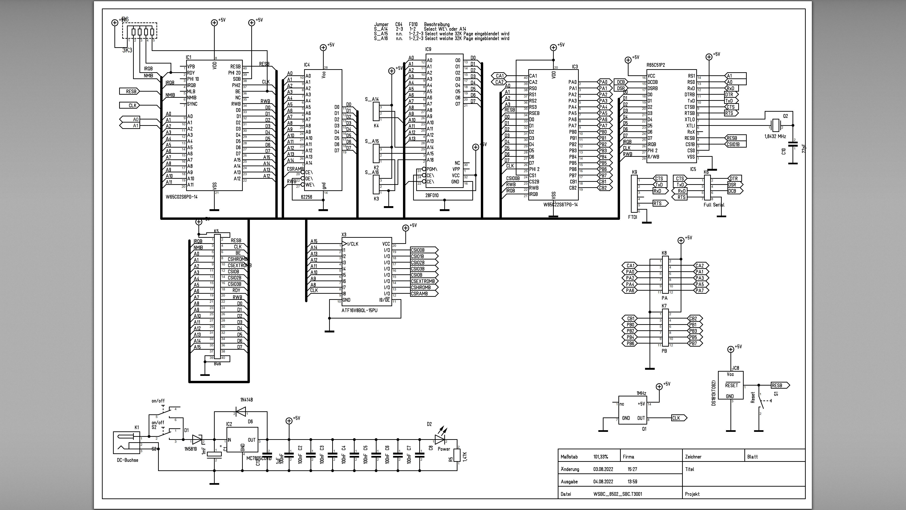

You sure you have a good 6551? From where did you get it? Also, can you post a schematic of how you have the 6551 interfaced to your system?

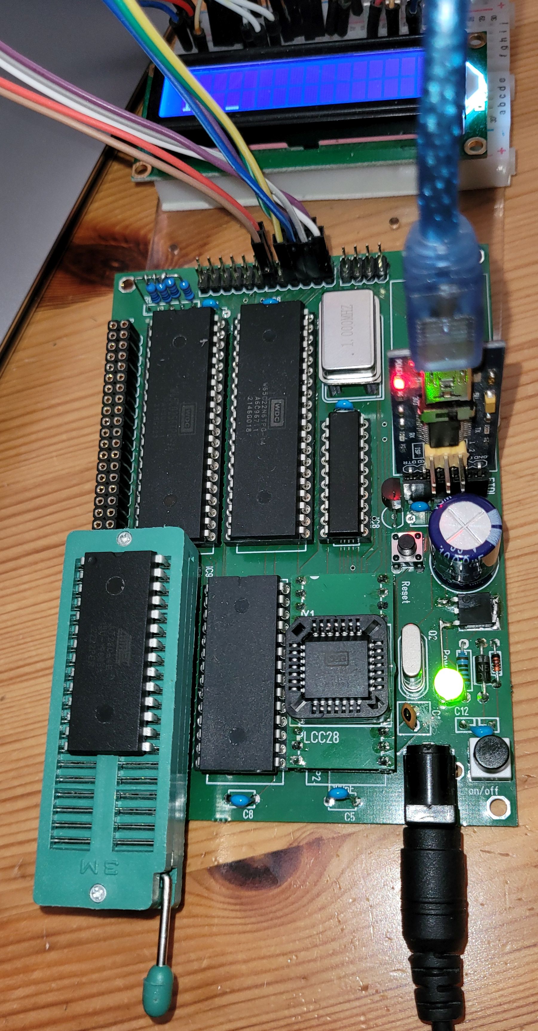

After 5 china r65c51, no one works correctly, I bought a W65C51 plcc28 version from mouser.de, build an plcc28/dil adapter. Interface clock generation seems OK, because transmit is working correct. Schematic is here
download/file.php?id=15678&mode=view
You’ve got IRQB on your 65C22 wired directly to the MPU’s IRQB. The part number you list for the 65C22 is the ‘S’ version of the device, which has a totem-pole IRQ output. That will not work as expected, since the 65C22 will continuously drive IRQB high unless it is actually interrupting. If a device with an open-collector IRQ output interrupts—the 6551 falls into that category—it will attempt to sink the 65C22’s IRQ output. You should be able to surmise what will likely happen.

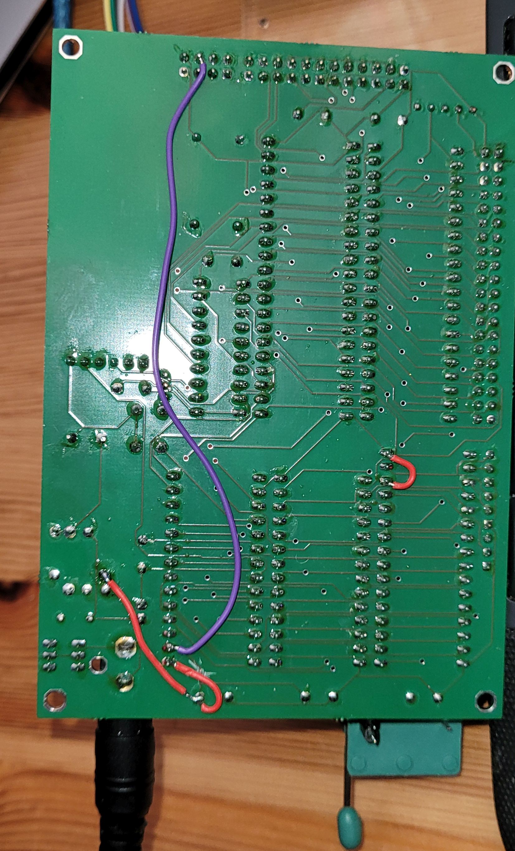

I am aware of this. The schematics label is wrong. I ordered a N version for this, which has an IRQ OC output. But i have found a bug in the library design i used for the 6551. DRDB and VCC are mixed up. So i corrected it on the PCB (with some wires... :-)) and voila it's now running. Even without Grounding the DCDB signal.
Sometimes it misses some chars, but that is mainly because of the LCD SPI bitbanging. I think with an interrupt routine using a buffer it will be better.
