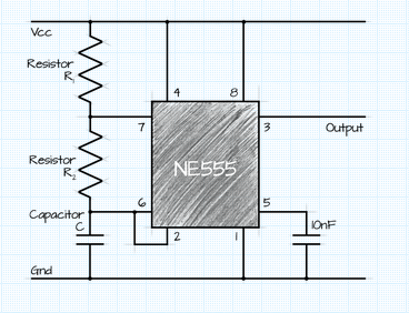

OK, so you need a 60Hz square wave generator.
You can rebuild the circuit from the original power supply, but then you are dealing with the mains - not recommended.
Using a 555 should work:
with R1 = 20.5 K, R2 = 110 K, and C = 0.1uF https://ohmslawcalculator.com/555-astable-calculator computes 60.000 Hz (!) and 54,26 % duty cycle (7,6ms low / 9ms high).
(I would use 18K + 5K trimmer for R1 to adjust for 60 Hz. R2 = 2x 220K parallel. An additional 0.1uF decoupling C across Vcc/Gnd is never bad.)
good luck!

*** This is exactly what I wanted, thank you. :)
I'll build this circuit, tap into +5v lead from the replacement PSU.

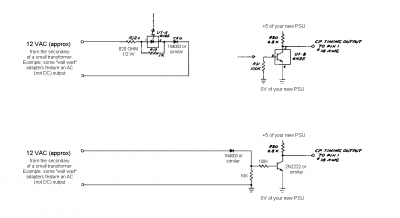

The oscillator/divider would be a worthy project, and would help develop your skills. But if you feel there's already enough on your plate then you could consider the following approaches, which are much simpler but are a bit clunky to use, as they require a separate AC adapter aka "wall wart" in addition to your Mean Well power supply. NB- many wall warts deliver DC output; you need to locate one that has AC output. Thrift stores are a good source of assorted wall warts. Any output voltage from about 3 VAC to 30 VAC is acceptable.

This is more important than you might think: if the clock isn't synchronized to the AC main you will have video issues for sure.
That is why I recommend Jeff's suggestion using a wall wart AC adapter is save and easy.
