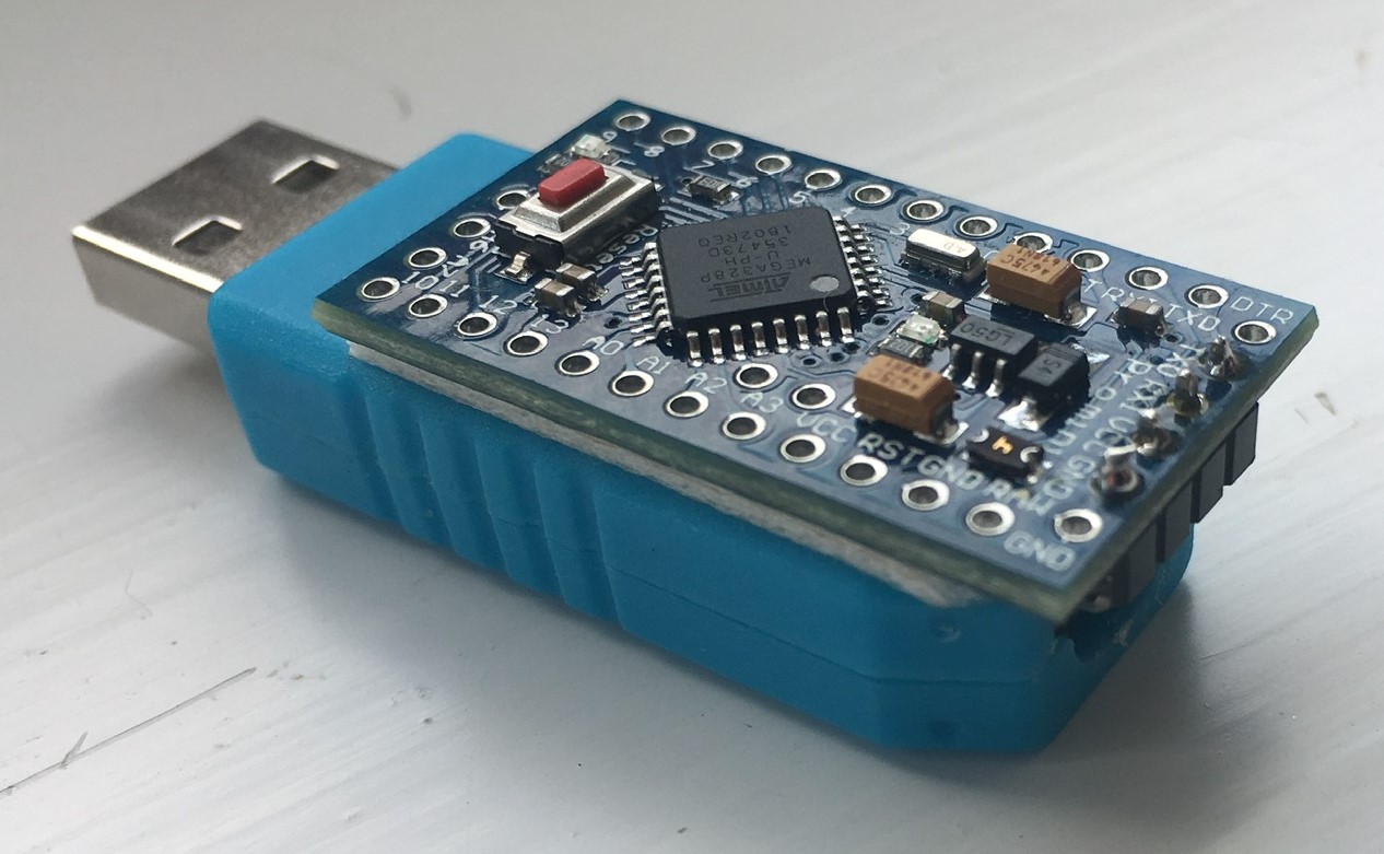

I still have my BBC B (restored, working) which I bought in the '80s and was recently tempted to build the KIM-UNO from "oscarv" of this place
(thankfully came as a kit of components). Oscar's latest software emulates both the KIM-1 & Apple 1 and I was using that also on the "dongle" below.
It just seems logical to run WozMon etc on real hardware.
