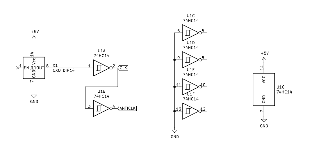

Howdy! I'm experimenting with a 74HCT14 to learn a bit more about how Schmitt triggers work. I've been trying to figure out VGA signals lately, so this seemed like a good opportunity to try the '14 as a way to clean up the signal coming out of the 27.175MHz oscillator in my circuit:
(The circuit also includes a .1µF decoupling cap, not pictured; also my can's datasheet says that Pin 1 should be NC.)

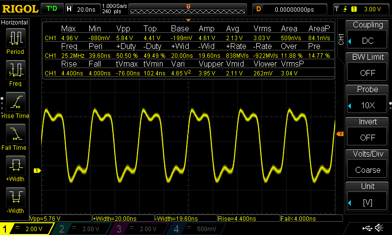

I'm seeing some really strange results that I don't understand on the 'scope. This is the input signal coming from the oscillator, as seen on Pin 1 of the '14 chip:

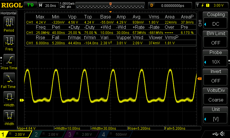

And this is what comes out on Pin 2:
I'm… pretty baffled; I expected a relatively nice square wave to show up on Pin 2, and this looks like anything but. I've swapped out both the oscillator and the IC, with no change. FWIW, this is currently on a breadboard—not sure if it could be problematic for something this simple.

The rise and fall times are well within the 74HC spec, even below the typical at 25°C, not to mention the max at the temperature extremes; but I don't see specs for the difference between tPLH and tPHL which might explain the lack of symmetry. 74HC won't give you a very square wave at 27MHz anyway though. It's just not fast enough. (Note also that your ANTICLK will not be anywhere near 180° out of phase with your CLK at 27MHz, because of the propagation delay.)
Hi Garth! Thanks for these notes—I had not considered the timing very carefully… I'm using an HCT (the HC is a mistake in my hastily-captured schema, sorry!), but even then the typical propagation delay of 12ns is nearly a third of the clock period, so the resulting inverted signal would be way out of phase.
I guess I'll have to rethink everything… my idea was to use opposing clock signals to alternate access to the memory between the video output and a CPU, but this clearly isn't going to work. Perhaps I should consider a different access scheme, or maybe look into how others have accomplished the same one.

Aha! I had missed that the first time around. I just saw 74HC14 on the schematic. 74HCT would explain the asymmetry.
If you start with twice the frequency and use a flip-flop to divide it by two, having with Q and Q\ outputs, their edges should be pretty well synchronized.

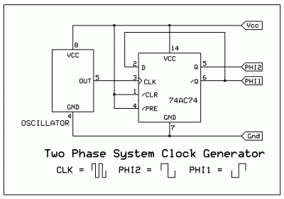

What Garth said. My go-to choice in clock generation logic is 74AC for low propagation time and rapid slew. As you've got it, you would be seeing relatively slow slew, plus your “anti-clock” signal will not be exactly 180 degrees out of phase with “clock.” Succinctly, 74HC logic is relatively slow, usually no faster than 74LS, so results won't be ideal
Also, and as Ed notes, a Schmitt inverter is not the usual choice for “improving” a clock signal. Schmitts are most useful when the input rises and falls monotonically, but at a varying and unpredictable rate. A “varying and unpredictable rate” doesn't describe the output of a good oscillator. In this application, a 74AC04 would be a better choice, IMO. BTW, some of that squirreliness in the output can be cleaned up with series resistance, the amount dependent on the circuit that is loading the clock outputs.
Lastly, if you absolutely must have “clock” and “anti-clock” exactly 180 degrees out of phase you need to run the oscillator's output through a flip-flop, such as in the following example.
File comment: Two-Phase Clock Generation Example
Only downside to that is the output frequency will be one-half of the input frequency.
