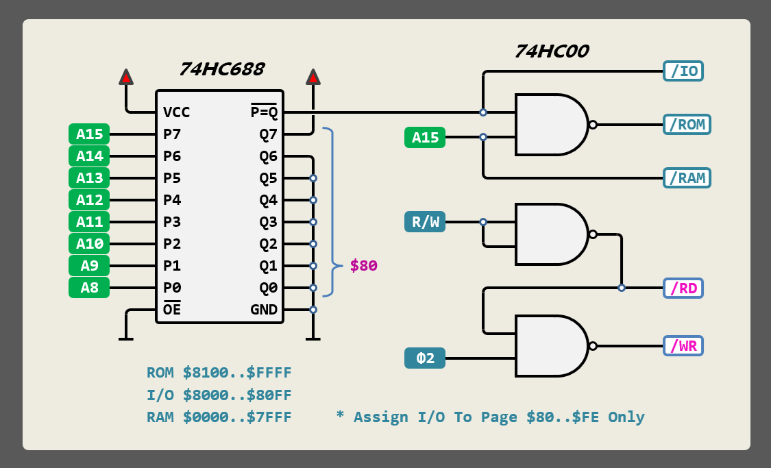

Michael, I am *sure* that's my ROM select arrangement. Surely that's what I was thinking in my mind at least.
I believe you have an unnecessary gate in front of the ROM select gate which is inverting the P=Q signal to the ROM select gate. The way you have it the IO and ROM would be enabled at $8000..$80FF and nothing would be enabled in the $8100..$FFFF address space.
It's easier for me to study the logic if you depict the 74HC00 gates instead of the package. Updated drawing below...
Good luck. Have fun.

Michael, I think you are right. I'm thinking it through now, and I do believe you are correct.
Thank you for that, I appreciate your patience with me. And yes, logic not package next time.

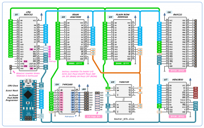

If I may... I'm not sure if it would be an advantage or not but adding a jumper block and pull-downs to the 74HC688 'Q' inputs would allow you to set or change the I/O page in the address space. In the example below a 74HC139 is used for the 'glue' logic, half of it being used to provide clock qualified /RD and /WR signals, the other half used to insert the I/O page into RAM or ROM space. Basically just another two chip decoder + glue logic solution for 32K RAM and 32K ROM but with jumper configurable I/O page address.

Mike, that is a great layout. And you didn't even use a 74'00?! Amazing. I will study this in depth going forward. I really appreciate it.

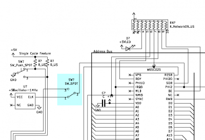

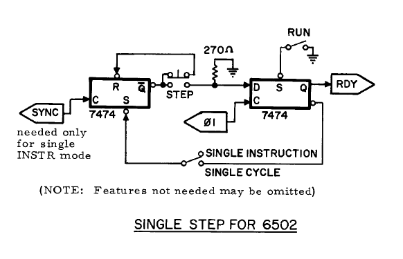

Chad, your approach (above) with the clock switch isn't the best. It'll work in full speed and it'll work in single step but when you switch between the two the machine will be apt to crash due to the CPU clock input momentarily floating and/or receiving mangled clock pulses.

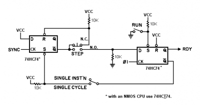

Circuits exist to glitchlessly switch between clock sources, but they're not quite trivial. I'd suggest you omit the single step feature or choose an approach that uses the CPU RDY input (rather than manipulating the clock itself).
The manual for the Apple 1 has a single-step circuit using just a single 7474. It's somewhat obscure (to me, at least), so I redrew it in a way I find clearer. Also, with the CMOS 'HC74 in mind, I added some pullup resistors and Vcc connections which aren't strictly necessary with the TTL part.
"Single Instruction" mode allows the CPU to advance 2 or more cycles at a time, stopping when SYNC goes high (indicating the next opcode is being fetched). "Single Cycle" mode is slower and more detailed, stopping on every cycle. (Exception: During write cycles, NMOS CPU's cannot be stopped using RDY.)
Thank you Jeff! Hm, go figure. I am finding more and more that "slap a switch on it" or "just put a capacitor on it" isn't good enough. These little details completely escape me, until you mention them. So thank you.
I had seen Woz's schematic for it, but yes, yours is better for sure.
So you mentioned to maybe ditch it altogether? I see that most if not all of y'all do not use it. But then again, y'all know what's going on and have been doing it for a while. The point of me having this feature at all would be to debug somehow. If it's worth an extra chip and more complexity, I'm willing to keep it. If it's not worth it in the end, then I'm willing to ditch it.
Either way, thank you Jeff, I will remember this for sure.

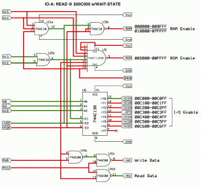

The above is the glue logic for my POC V1.3 unit. Red lines are parts of the circuit that should be at logic 1 (~5 volts) for the address $00C000 and the green lines are signals that should be at logic 0. Incidentally, note that I drew AND, OR, etc., gates as traditional logic symbols, not black boxes with connections—the latter tell you nothing about the circuit's logic progression. I reserve the black box notation for devices with complex functions, such as the 74AC138 decoder.
Using a technique such as the above and assuming you understand how the components of your design function, you will be able to see exactly how your circuit should behave with any given address on the bus. Hence if there is a logic error in the design you should be able to uncover it. If you do that for all the key address situations you expect in your system, e.g., RAM selection, ROM selection, etc., you will likely find all logic errors. I recommend you give it a try before wiring up your system and being disappointed when nothing good happens.
