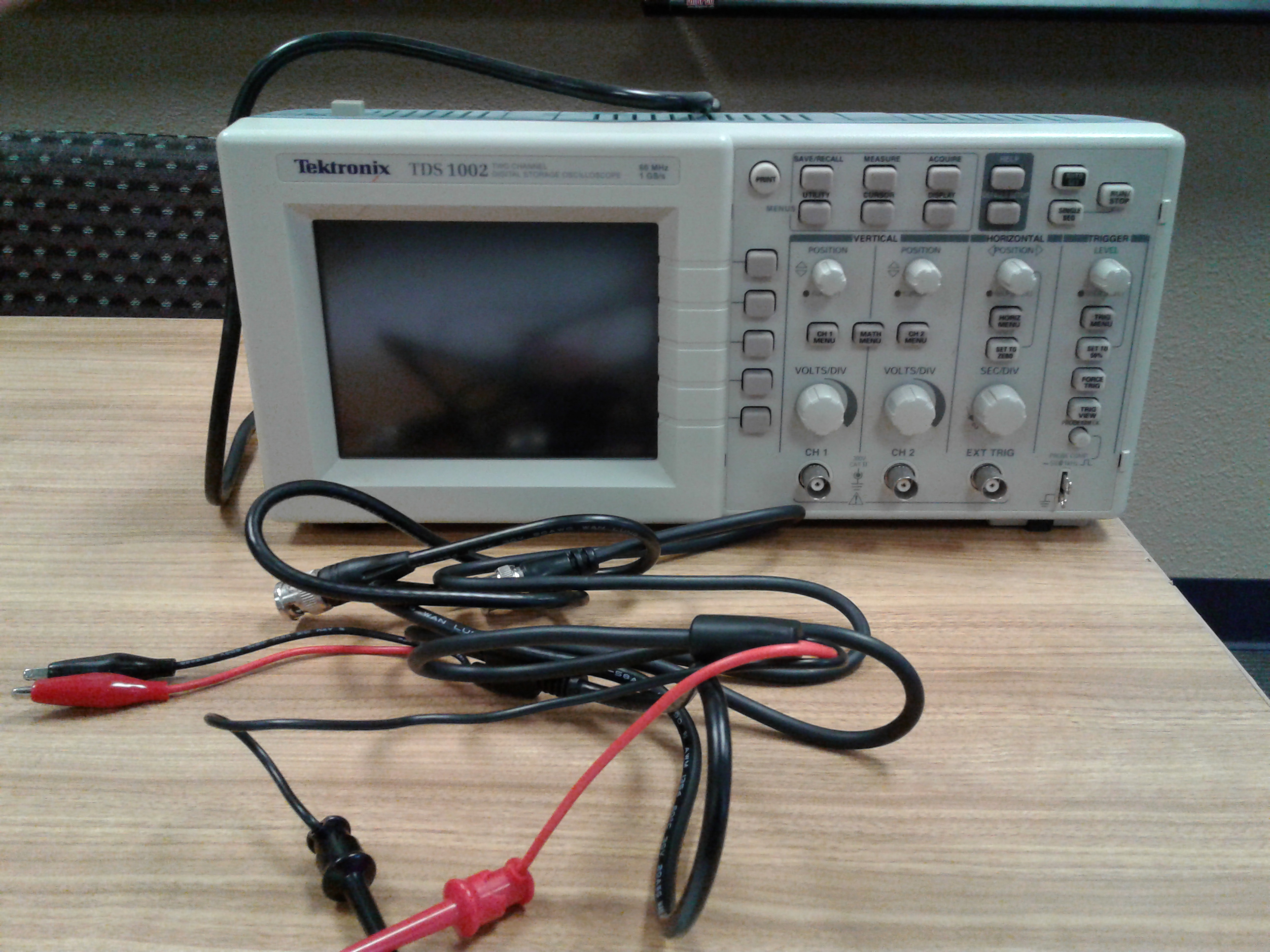

Look guys! The college is letting me borrow a 'scope! I even get to take it home with me.
Chad

PostPosted: Tue Oct 26, 2021 7:57 pm
Posts: 8433
I don't see any real 'scope probes. Are they included, just not in the picture? Just clips to the coax will not be suitable. There's a lot that goes into oscilloscope probes which is not obvious, including even special cable (not normal coax), which is why they're expensive. Even for a 20MHz 'scope, they start at about $40 a pair. What I see in the picture will give extreme capacitive loading to fast digital lines and probably make your creation crash, and the 'scope won't be any good past about 2MHz anyway with them, which means a digital signal of about 200kHz or less. The probes must have a x10 switch setting.
Hm!
I did turn the thing on, and I found that x10 setting you were talking about.
I have alligator clips and the little "prong" things. I just did a look on the internet for "oscilloscope probes" and I don't know if this qualifies as that? I mean, the thing was just handed to me. They say it was water damaged in the blizzard last February, but again it turned on at least.
I suppose I should test it out on a breadboard and see what happens. I literally know nothing about it, but at least I have something which should technically be better than nothing?
Thank you Garth.
Chad
PostPosted: Tue Oct 26, 2021 9:20 pm
Posts: 1076
P2220 probe is around $50 used on eBay.
The test point at lower right corner of scope may be a calibrated square wave output? If so, it is a good way to calibrate your scope probe.
PostPosted: Tue Oct 26, 2021 11:39 pm
Posts: 8183
sburrow wrote:
As a side note:
Chad
Nice scope! How did you manage that?
You still should have a logic probe. Although a scope can be invaluable for solving timing and quality-of-signal issues, a basic logic probe is a quicker way to find basic circuit faults.

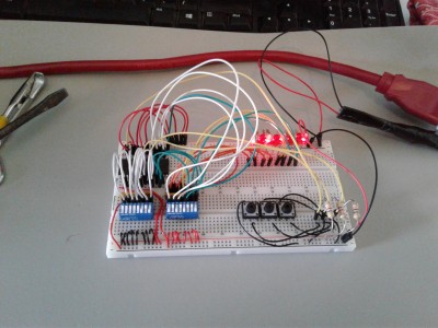

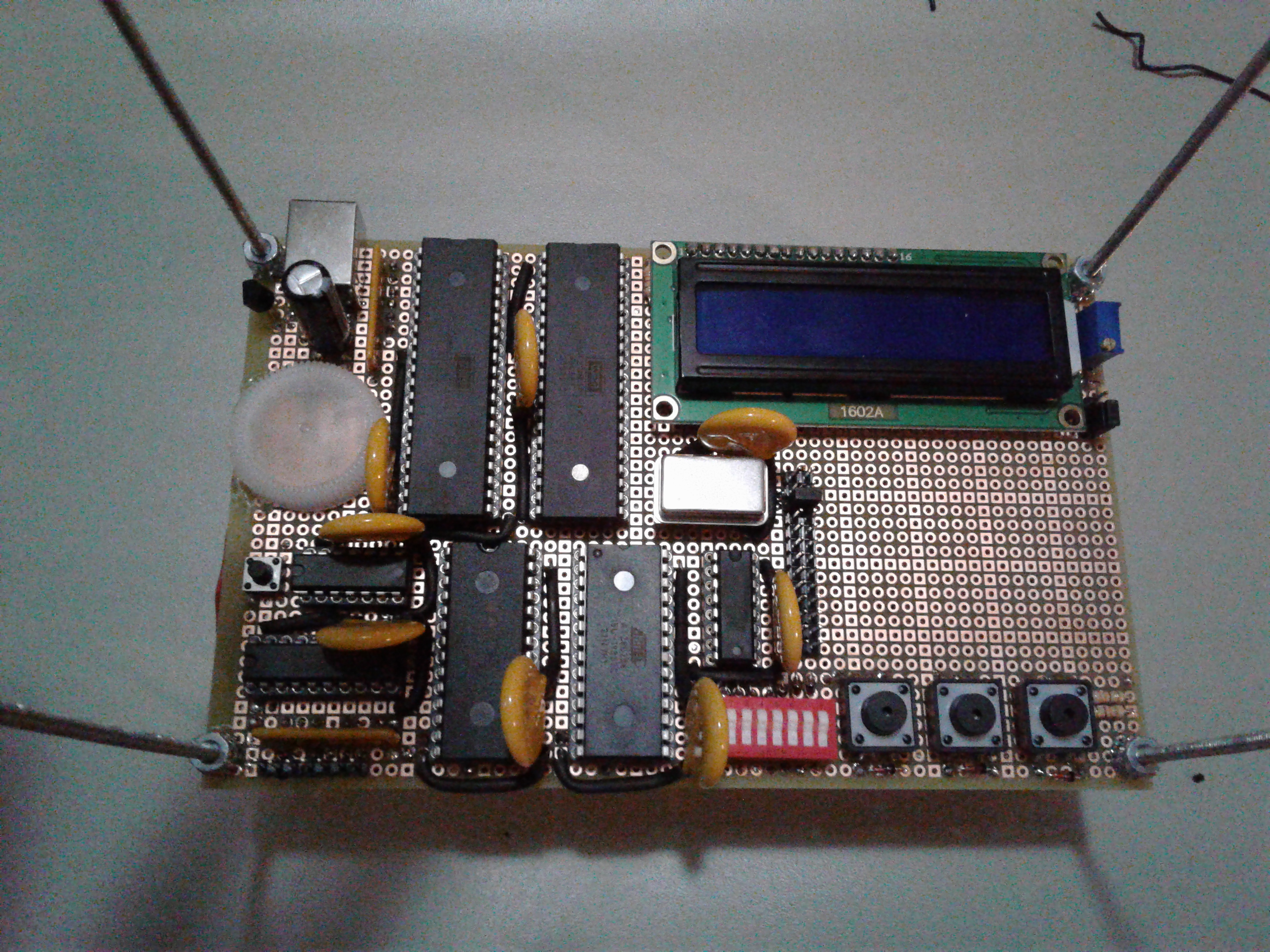

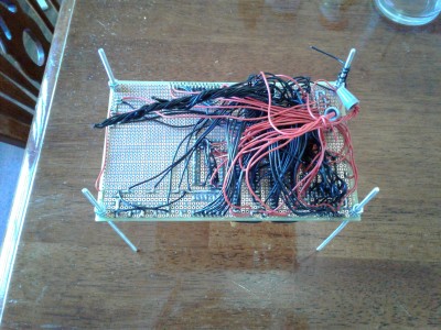

Hi everyone!
It's been a few weeks. I want to update you on what's been going on.
Attached are some pics of my creation. The top looks nice enough, the bottom is a big mess o' wires. I have learned so much about soldering it's crazy.
Attached also are the (rough) schematics that I followed.
I programmed it with that nice EEPROM programmer/reader on the breadboard. THAT is a thing of beauty.
So! Does it work? Sometimes. It works... sometimes. I hit that reset button a bazillion times, and have tried looking at it through the 'scope and multimeter and all kinds of things. It works... sometimes. My code is simple enough: Turn the VIA's PB to output, and then PB0-3 are high and PB4-7 are low. I have expansion pins on some PB lines and I test it with an LED on the breadboard.
I get weird feedback sometimes. It's like I get this alternating pattern that's not 0V or 5V, but both at the same time. The scope just makes a big dark rectangle on some signals and the multimeter reads 2.5V. I figured it was alternating with the clock, but the 'scope picks up on the clock very well but not these weird half-signals.
I tried changing capacitors and all kinds of things. Sometimes it works as expected, sometimes it doesn't.
What did I learn from this? That a printed board would have taken about 5 days of soldering down to about an hour. I can tack-solder a pin-point without effort at this point. Especially if all those wires weren't in the way. Sheesh!
But I think that if I print a board, the same thing might happen. That it works... sometimes. I figure it might be a capacitor problem, but I could be wrong. Leaving it to sit for a while, and then trying again actually helps, I think. I changed polarized capacitors and got about the same results, plus or minus. I disconnected the LCD and nothing changes. The reset button does actually work, most of the time at least. It's weird to get different results at different times, doesn't make sense in my mathematical mind. [ I tried shaking and slamming the thing a couple of times, that didn't change anything either. ]
Anyways, if you have advice I'll listen to it! If I don't hear back, I'll just keep doing my own thing I guess.
Thank you all for everything. You all have taught me a great deal. I'm here today telling you that I have learned a lot, and at least I got it to work... sometimes.
Chad

PostPosted: Mon Nov 08, 2021 11:56 pm
Posts: 1929
Kind of like this? @CountChocula might be able to offer some insights.
PostPosted: Tue Nov 09, 2021 12:01 am
Posts: 704
Kindof like that. The big solid parts, yes. But they are constant, they don't go away. This is not every line, but some address lines, some data lines, etc. And again, it happens... sometimes.
Thank you!
PostPosted: Tue Nov 09, 2021 1:09 am
Posts: 101
Location: Toronto, Canada
Thank you!
Hey—your board looks amazing! In my case, the problem was leaving pins floating on a level shifter. Not sure whether this applies in your case, but perhaps worth checking whether there are any floating pins anywhere. It was a total surprise to me that this would be a problem :-)
Good luck!
