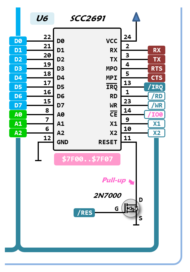

Hey guys. I'm curious if there's any reason I shouldn't use a MOSFET as an inverter for the SCC2691 'RESET' line?
TIA... Mike

Haven't you forgotten to include a pullup resistor, Michael? (Edit: oops, I see one is indicated) But the idea is workable. Does the incoming signal ( /RES ) swing from 0 to 5 Volts? You'll wanna be sure to select a MOSFET that will turn on sufficiently, given the available incoming voltage.
If your motivation for doing all this is to save space, you might want to consider simply using a 74LVC2G04 instead. This is a miniature SMT device with only 6 pins (and hence only 2 inverters). For more on the 1G and 2G series, see my post, Tiny, superfast gates rival programmable logic.

I would watch out for the edge rates: certainly coming out of reset, and possibly going into reset, you need quite a decisive signal. Too slow, and the device might malfunction. (This is a general point: it's possible the specific device here is very defensively designed. Check the spec for the reset input.)

I don't see any reason why not, as long, as Ed noted, the signal edges aren't too slow. I've not tried it because I've always seem to have had a spare gate to act as an inverter.
BTW, the 2691 is obsolete—you may want to consider a newer NXP UART with faster bus timings. Also, the 2691 doesn't have a transmitter FIFO, which means it will interrupt on every datum sent. The newer NXP UARTs have such FIFOs and only interrupt at 8- or 16-datum intervals if correctly set up.
I remember that post on those fascinating products, Jeff. Thank you.
Actually, that TL770B supervisor chip that Kevin (floobydust) uses isn't very expensive. I just happen to have a bin full of 2N7000's.
