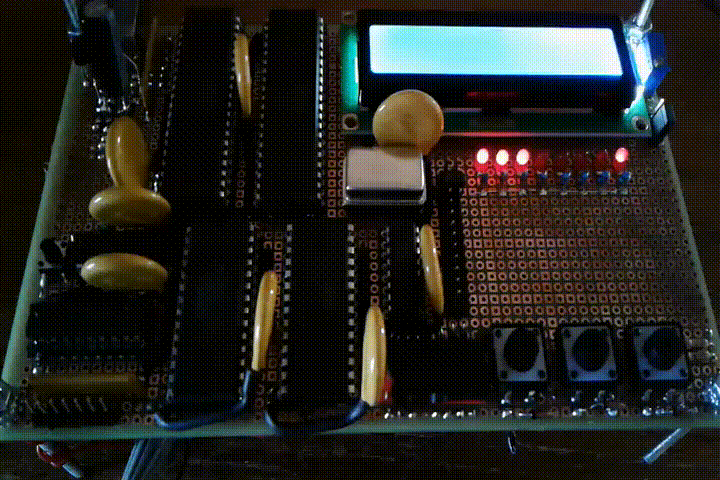

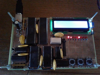

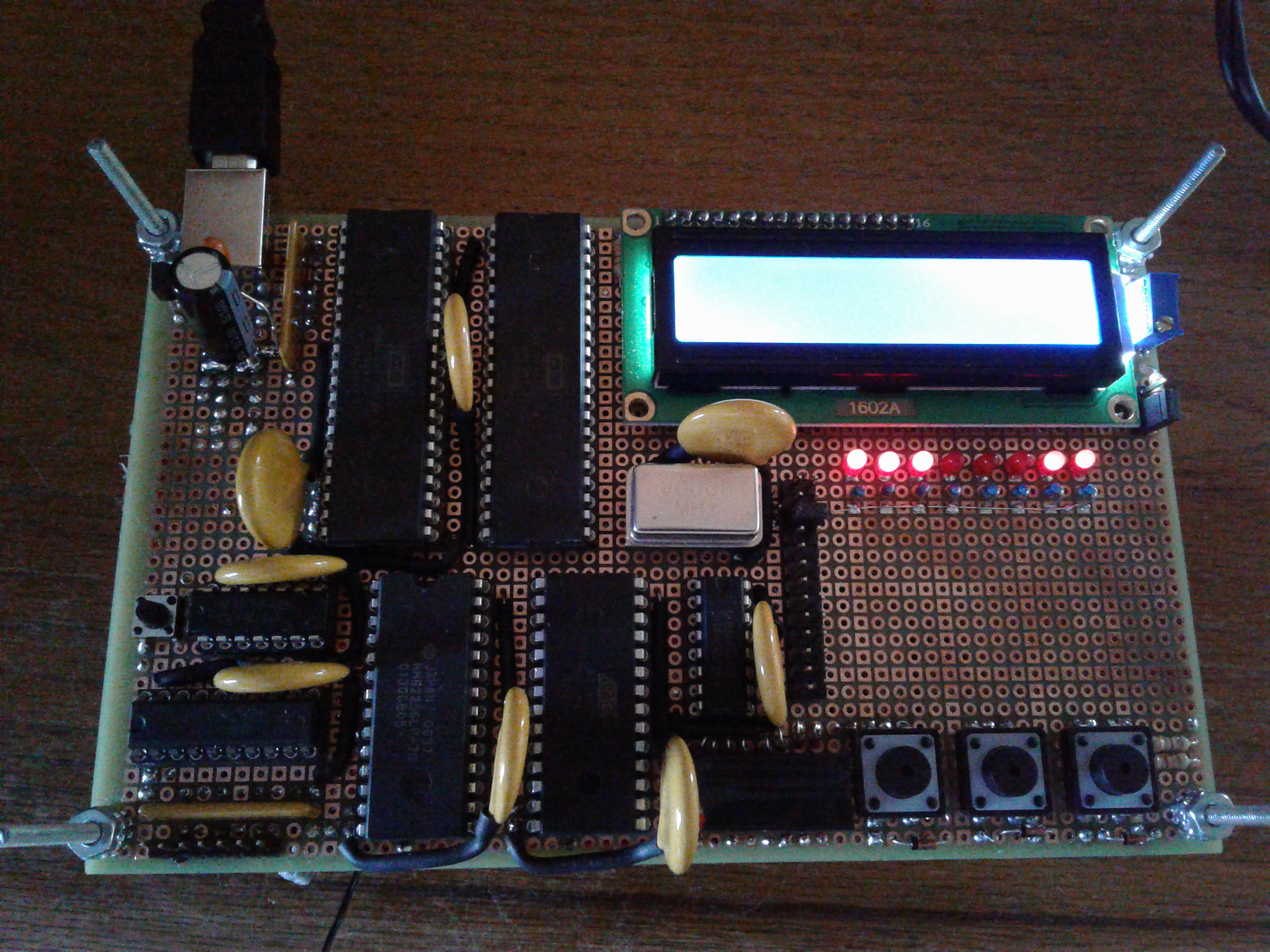

An update on this board:

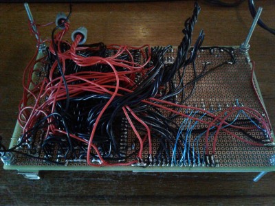

Bill (plasmo) asked if he could look over the board and test it. I sent it to him, and he found that I had flipped A4 and A11 on the RAM and ROM. If you look at the datasheet, they are right across from one another. I was not careful enough when moving wires from the 6502 downwards.
When Bill flipped those, it worked! That was literally the only thing wrong with it! So why was it only working... sometimes? I don't know, but it works now thanks to Bill. Thank you so much Bill!
Attached are some pictures and a short GIF video. Bill added some LED's to the front, you can see his thin blue wires compared to the fat wires I used.
Well, I learned a LOT from this. Even though my solder work was ok, my wires were crossed! I will be extra careful next time, as well as knowing more how to debug.
As you might know I already have a 4-layer board coming in (eventually), but in the meantime I will be coding this guy. It'd be cool if it can calculate "pi". [ That was going to be my first demo software. ] I'm likewise going to showcase this at the upcoming Math Appreciation Day at the college in the Spring.
Thank you all for your help on this, and thank you again Bill for your kindness to me.

PostPosted: Thu Nov 18, 2021 12:37 am
Posts: 8155
Amazing what some mixed-up wires can do to you. :D Hopefully, this will be a thing of the past when you start building on a PCB.
