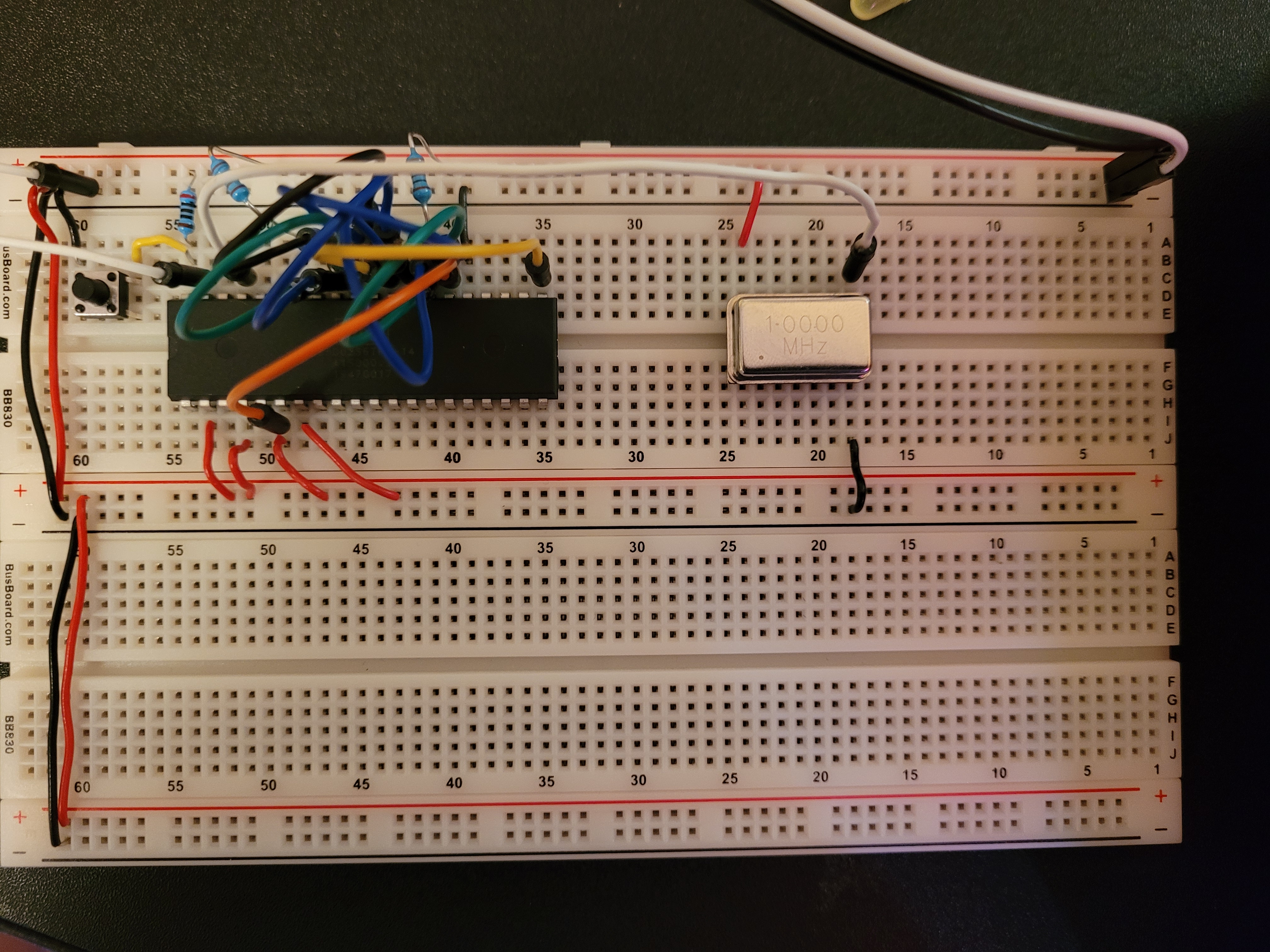

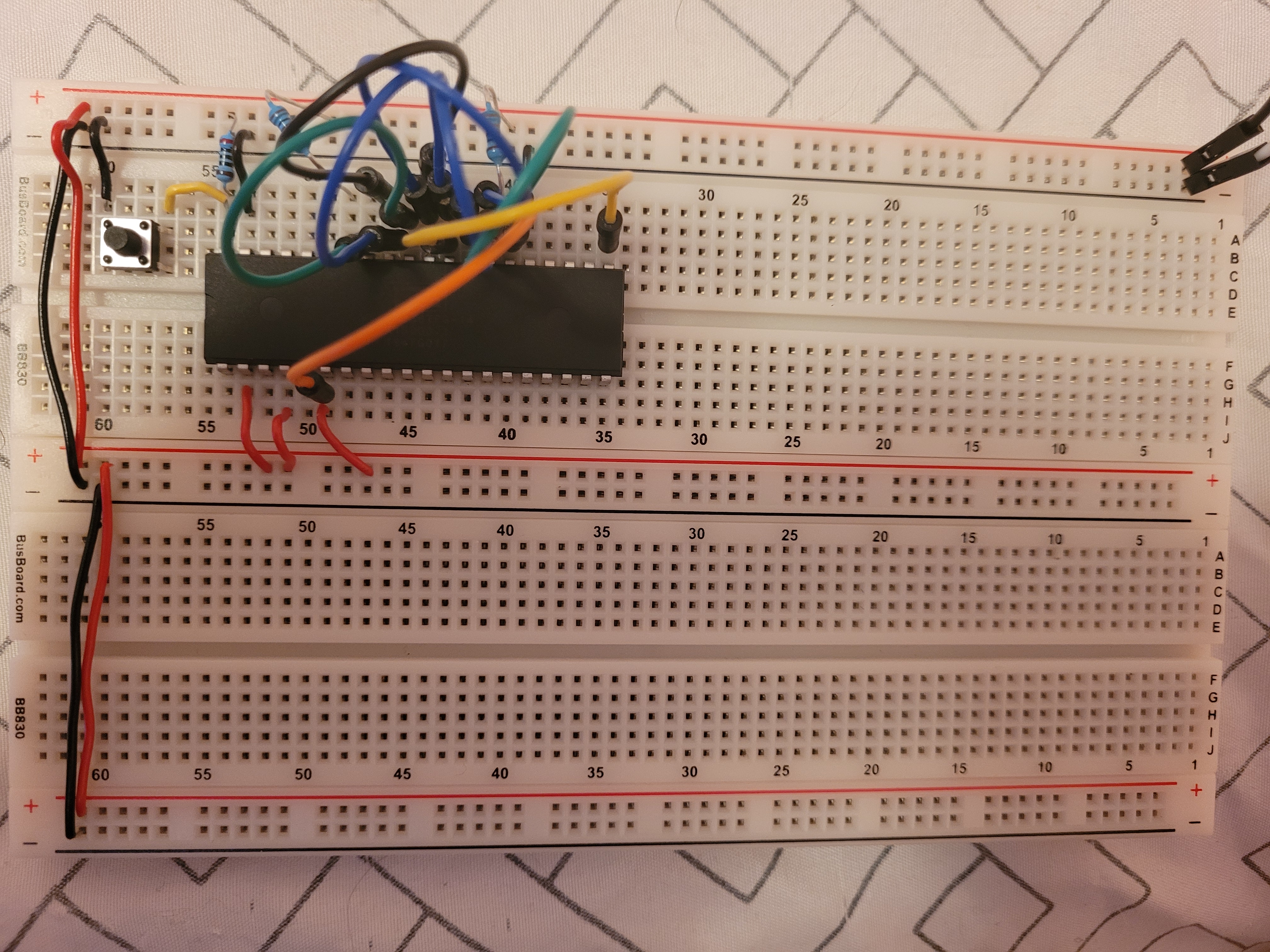

PostPosted: Sun Dec 27, 2020 7:12 pm
Joined: Tue Dec 22, 2020 5:46 pm
Posts: 23
Ok, I think I've got it together, I'm sorry it's so crowded, I've only got jumper wires for this, I was getting anywhere from .6 volts to .9 volts when checking the address lines, and my meter nor my scope could get a signal out. I've done something wrong I think?

PostPosted: Sun Dec 27, 2020 8:00 pm
Posts: 337
You need to take your time and carefully checking your wiring.
You have connected Pin 39 (Phi2 out) directly to 0V, which might damage the W65C02.
You also don't seem to have an oscillator driving Pin 37 (Phi2 in).
And pin 8 (VCC) is unconnected.
Dave

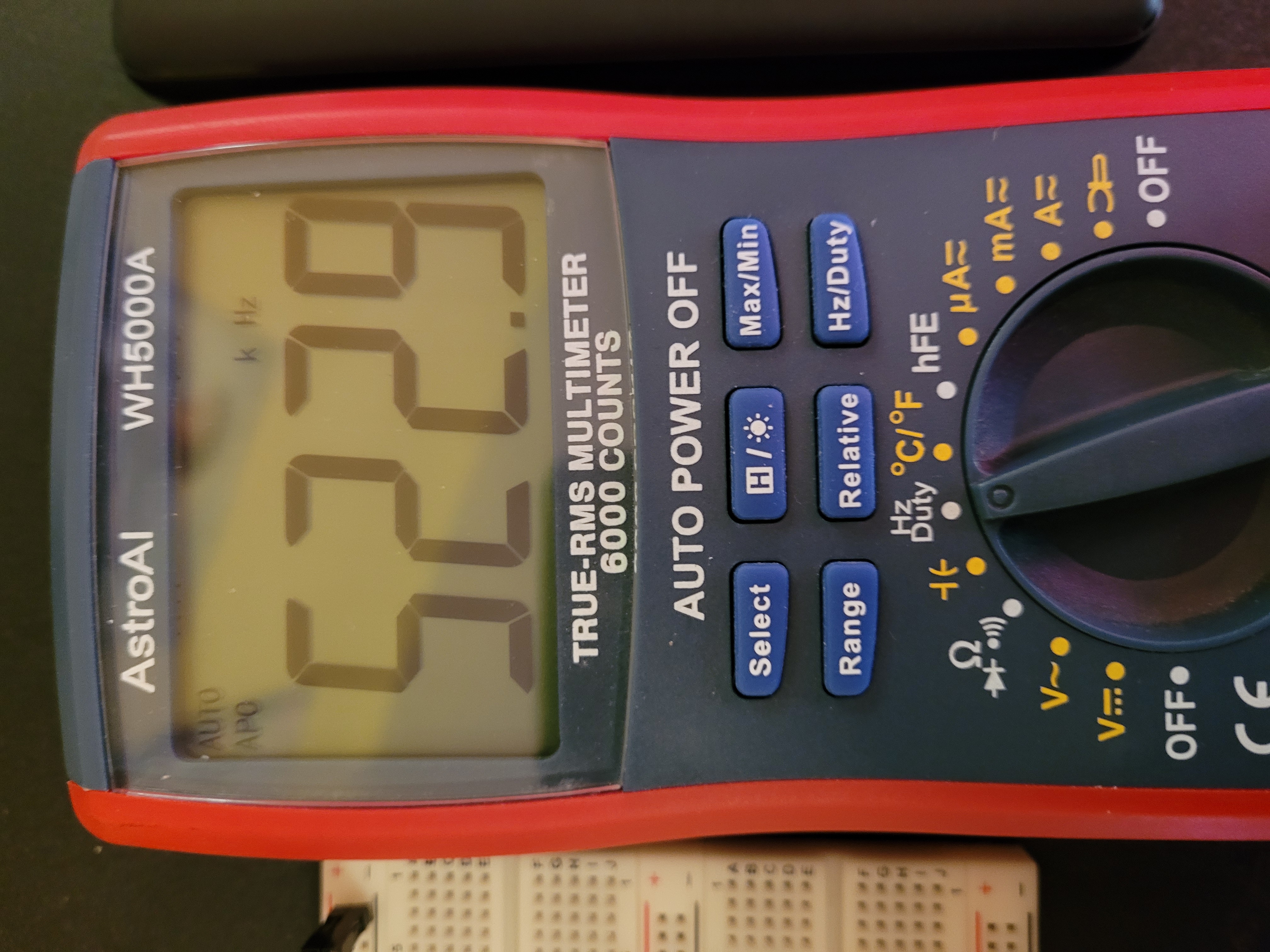

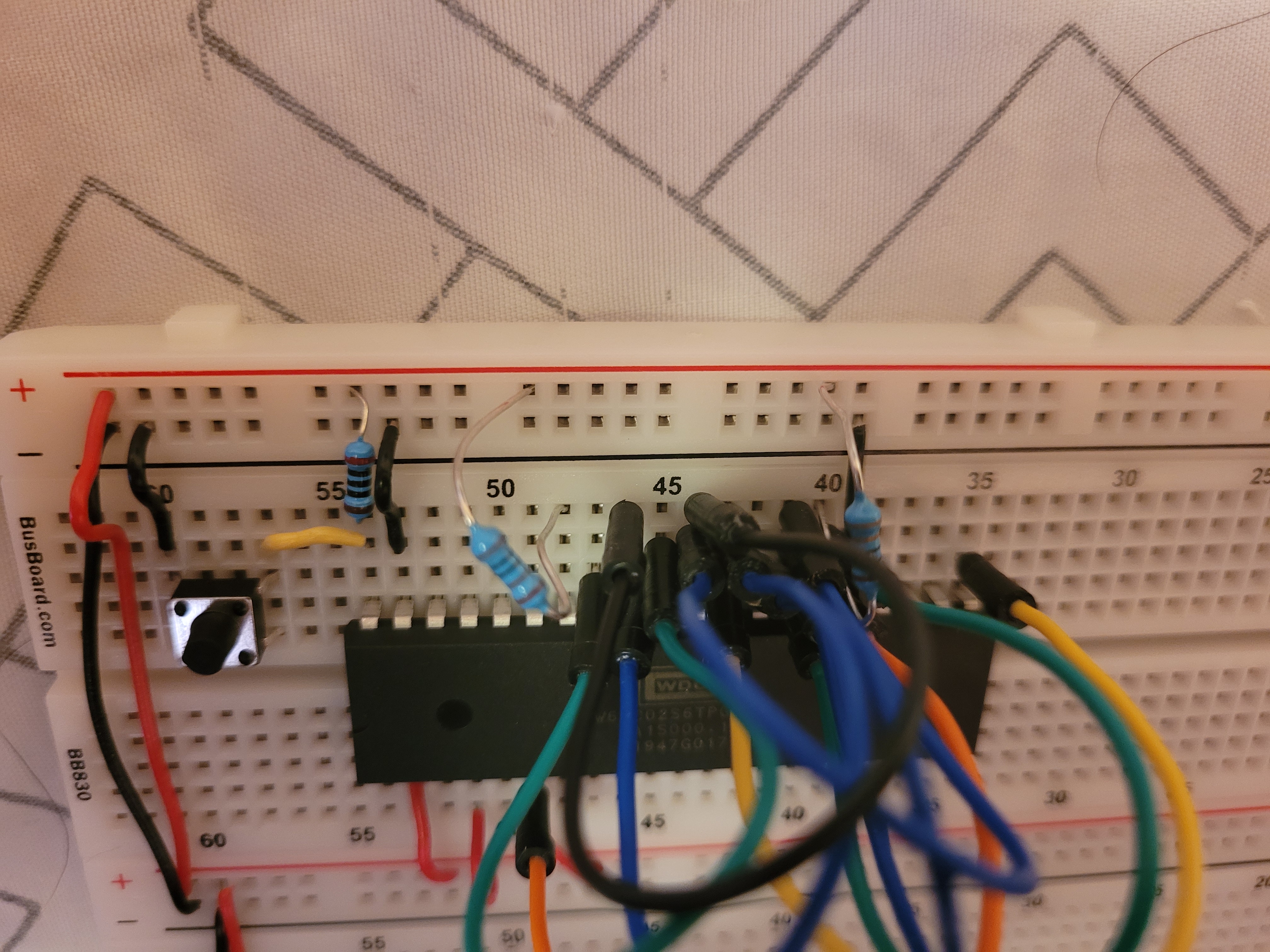

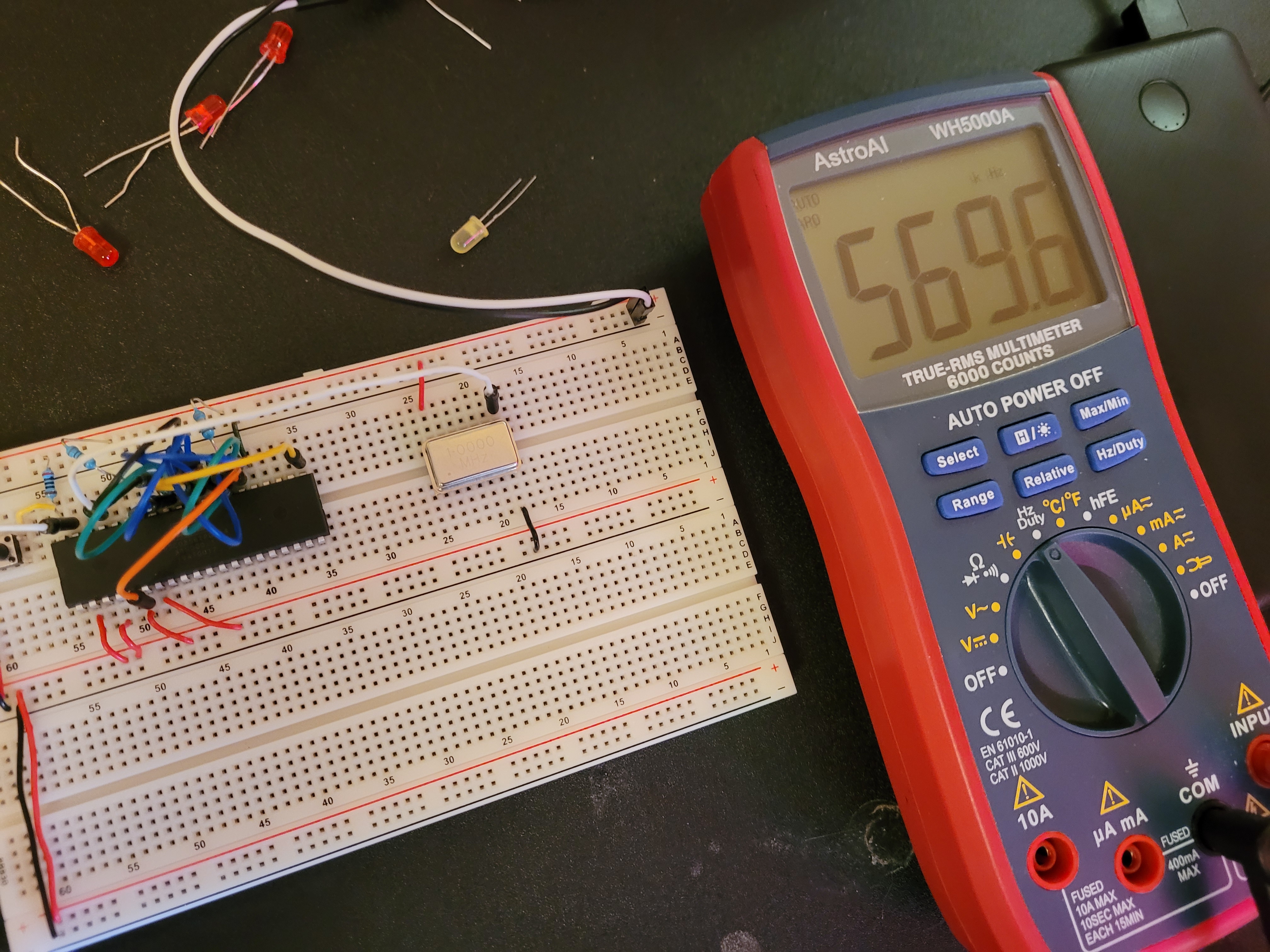

PostPosted: Sun Dec 27, 2020 9:08 pm
Posts: 23
Okay, taking Hoglet's words into practice, I've received signal from Phi2O (which I know is clock output, but it's the only pin I measured a pulse coming from.)
Voltages where higher though when I tested them. Enclosed are photos, as promised.

PostPosted: Sun Dec 27, 2020 9:51 pm
Posts: 337
You have connected +5V power to pin 7 (SYNC); it should be connected to pin 8 (VDD).
Dave
PostPosted: Sun Dec 27, 2020 9:53 pm
Posts: 337
You also need to make sure pin 21 (VSS) is connected to 0V; I can't tell if this is the case.
Dave
PostPosted: Sun Dec 27, 2020 11:57 pm
Posts: 23
Ah, slight oversight, thank you. It wasn't connected to VSS but it is now. I'm reading around 500 millivolts on the address pins, and I got a 500kHz signal out of pin 7.
PostPosted: Mon Dec 28, 2020 2:50 am
Posts: 727
Location: Tokyo, Japan
Your most recent layout photos betray a certain lack of organization. As just one example, you bring Vcc (+5 V) to pin 25 not by using a short jumper from the +5 V power rail directly above that pin row, but instead by using a long jumper to the other side and other end of the chip to get +5 V from the pin 6 row. What is the purpose of such indirection?
You have correctly wired both power buses on both sides of the breadboard, so make use of this. Cut some more small red and black wires use these to wire anything that needs to go to a power bus directly to the nearest one. This will make it much easier for both you and us to check your connections. Pull-ups and pull-downs via resistors to Vcc and ground should work the same way. Trim the resistor leads to avoid them touching each other.
In hardware you can't be sloppy; you have to get every connection right. Take your time and work neatly, making your connections clear; the extra time you spend doing that will be more than paid back in less time debugging.
And with the oscillator, too: for some reason it's not near the clock input pin but instead not only way over at the other end of the chip but exiled some distance down the board. That's a pretty poor way to treat what is basically the CPU's heart. (If that's not beating well, nothing works.) Move the oscillator just to the left of the CPU and cut a short wire for the clock signal to bring it to the CPU.
Keeping that wire short will also help reduce the chance of degredation of the clock signal, which is good because there is no signal where quality is more important than the clock.
And speaking of signal quality, please also put a 0.1 μF bypass capacitors from the Vcc pin to the GND pin (or at least to a nearby GND rail) for both the CPU and the oscillator. This will also clean up your signal quality significantly, which means one less thing that's likely to be going wrong.
