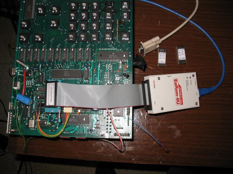

I bought a while ago a used CNC Lathe, the famous EMCO Compact 5 CNC known by lot of model engineers.
This lathe was a dream for me when I saw it the first time about 1985.
Prices where prohibitive in this years, so expensive as a new car but she was mainly a training machine
with an reduced set of commands and functions!
CNC programs where stored on Philips data cassettes.
A monitor, a serial link, a DNC board with I/O's and a tool changer were expensive options.
The original CPU-board is equipped with a 6502 1MHz NMOS CPU, 3x 6821P VIA (Keyboard, Stepper motors, DNC interface),
ICM7218AIJI Display driver for 7-segment LED's, 10x 2114 4-bit RAM (5kB), 3x EPROM 2764,
on a daughter-board we have the CRT video controller 6845 and 6551 serial interface.(the options)
Address decoding is provided by TTL 74LSxx. Clock rate is a "tremendous" 0.819 MHz.
Most people "retrofits" there machines with new controllers/drivers but I like this 1980 charm of electronic
where one don't need a microscope to solder. I worked for a phone company and I repaired sometimes boards,
but with SMD it becamed nearly impossible. Today its buy and throw away.
I use for my project most of the old TTL and CMOS, transistors etc etc stock from my old company, I saved them from the bin.
The machine worked perfectly, but the baud rate of the serial link was a poor 300 Bd, transfert of programs
where really slow and so I made the first steps in modifying the machine.
Downloading datasheets to find the parameters for baud rate with nearly no experience
in microprocessors and periphal devices was the first step.
I had already an old EPROM-Programmer and by trial and error (about 5 EPROM burnings) I found the place in the HEX file
for 1200 Bd (the maximum possible without transmission errors, there is no flow control).

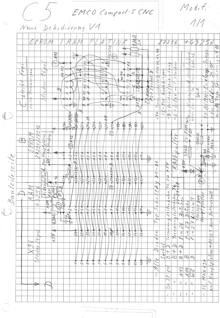

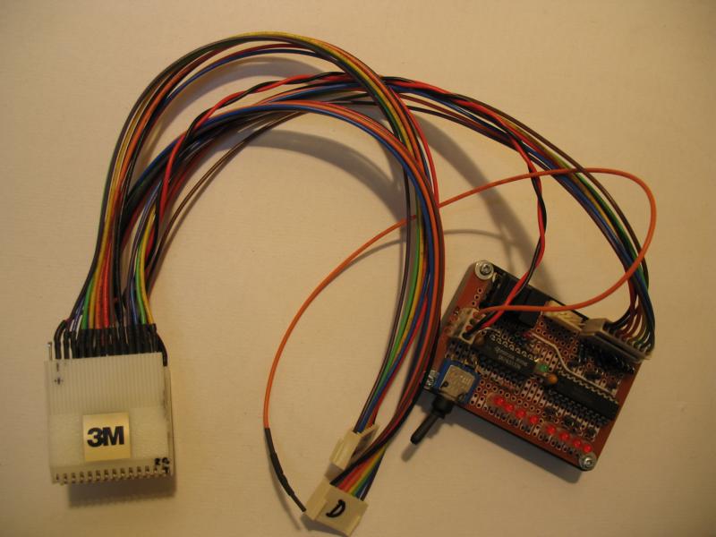

I hadn't yet disassembled any code but I was "catched" by the idea to upgrade the lathe to my ideas.
I got another CPU from a milling machine which is similar to the lathe CPU, this is my "developers kit".
All hardware/software modification is tested and then duplicated for the lathe without detailed schematics.
After I found circuit diagrams for the spinlde motor controller and the stepper controller on EMCO user group
but nothing exist about the CPU.

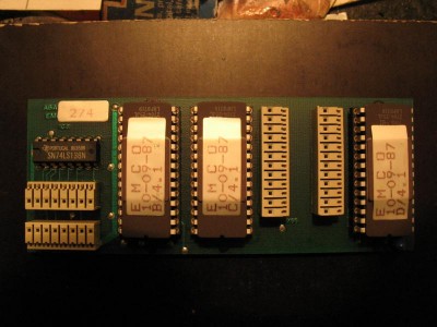

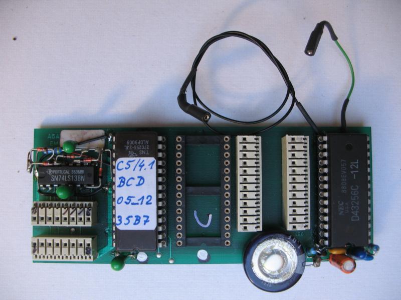

Fortunataly a friend had an EPROM emulator and this made the next modifications possible.

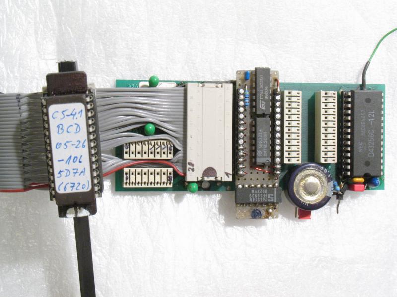

I replaced the 3 2764 EPROMS with a 27256 to store the whole code in the emulator by wiring OR the
3 CS with shottky diodes.
With 5kB of memory a CNC program was limited to 210 blocks. (it seems that machines existed with 222 blocks)
To extend the memory at 16kB I moved the addresses for the display driver and the keyboard matrix VIA
to a free space and used a 256 kb CMOS RAM I took from an old PABX CPU.
A Gold cap saves now the memory, impossible with the original RAM's (NMOS)
and they are now disabled by wiring CS to VDD.(no need to desolder, they draw only a few mA in standby)

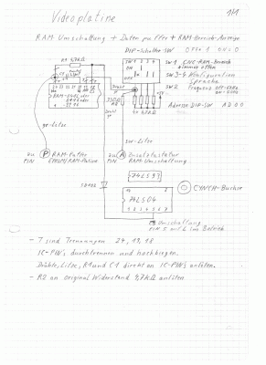

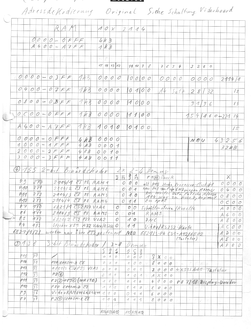

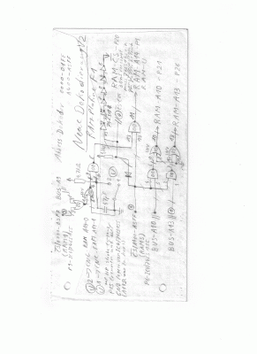

But half of the new RAM and half of the original video RAM where not used so I made a manual "bank switching"
to store two independend CNC programs. The zero page, stack and the area used for variables
don't switch, only the CNC program area, this made the address decoding more complex.
The RAM area is rugged: $0000 - $3FFF used for page zero, stack and storage of CNC programs
and $A400 - $A7FF for variables (originally installed on the CPU but not in use in my software version,
if used it frees the end of CNC-RAM area and one can store 222 blocks with original RAM's, it's funny
that EMCO didn't use it immediately, but RAM was expensive and there are pictures of CPU's without the last 2x 2114)
The new RAM allows 2x 990 blocks of CNC Code.

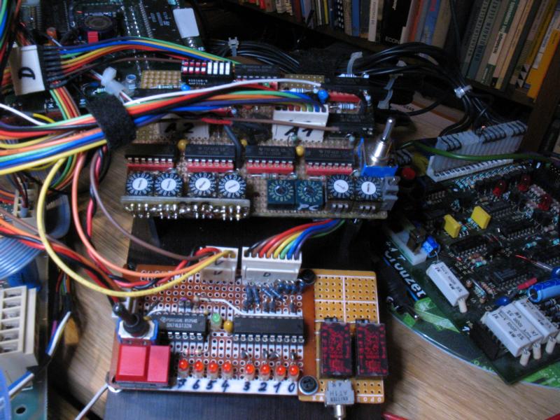

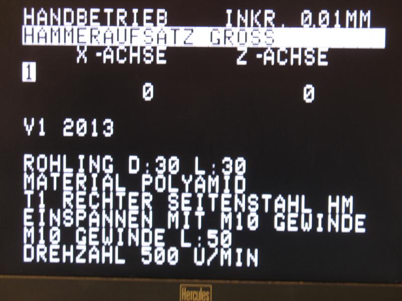

I also overclocked the system to 1.5 MHz, but of course I needed to adapt the timing loops.
The video RAM now stores comments present in the CNC program files and is also switched.
A lot of "flying wires" where necessary and it doesn't look professional but it works.

Yes, there are lots of photos. What's the maximum of pictures in one post in 800x600 format?
For starting some older photos:

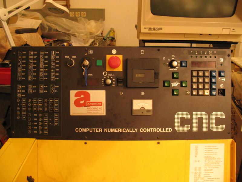

File comment: The machine as bought with the cassette deck and the broken start key on the right side.

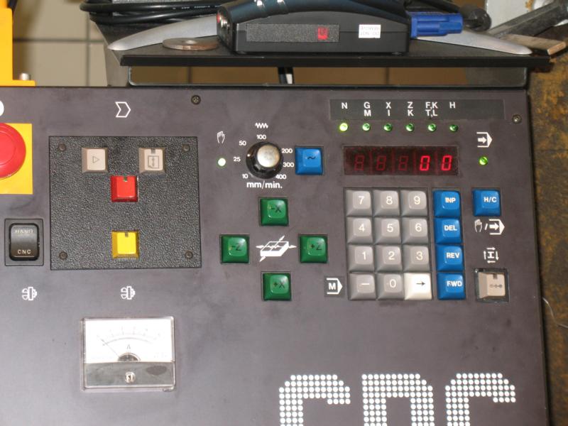

File comment: Now with a keyboard instead of the cassette deck and a start key. The keys are from an old PABX operator keyboard
with integrated LED's.

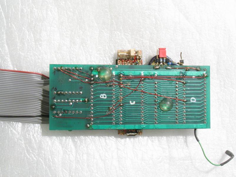

File comment: The "development board", it's a EMCO F1 milling machine CPU, slightly different than a lathe CPU with the EPROM emulator.

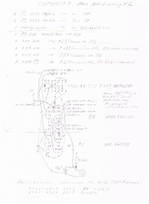

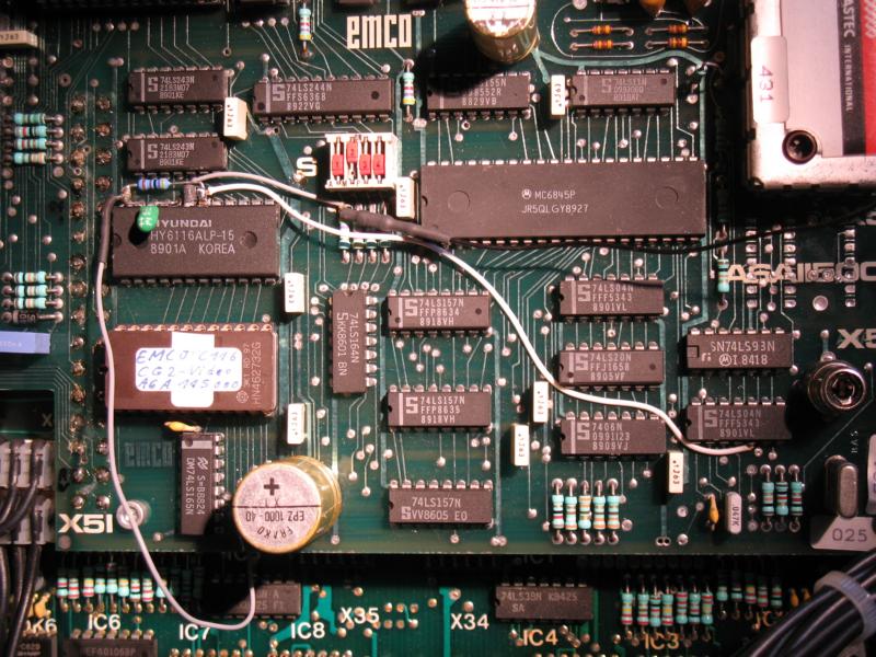

File comment: The video and RS232 board on the lathe, you can see the "flying wires" for EPROM bank switching".

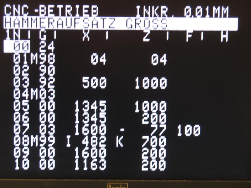

File comment: The screen in "HAND MODE" showing a header (workpiece name) and comments imported from the CNC file.
The inverted 1 shows the CNC program bank (1 or 2).
I added this feature and meantime one can also use lower case letters (modified character EPROM ) and I changed also the layout of the first line.
Originally the screen showed only the first line and the X / Z position, what a wasting of screen area. :-)

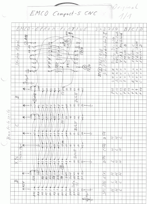

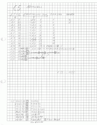

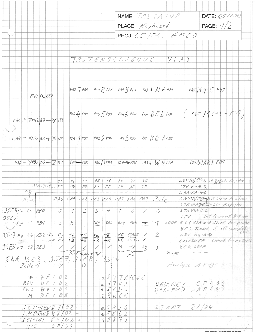

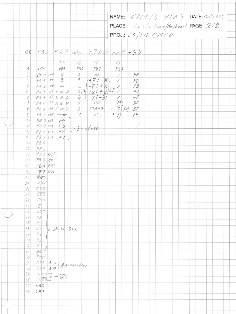

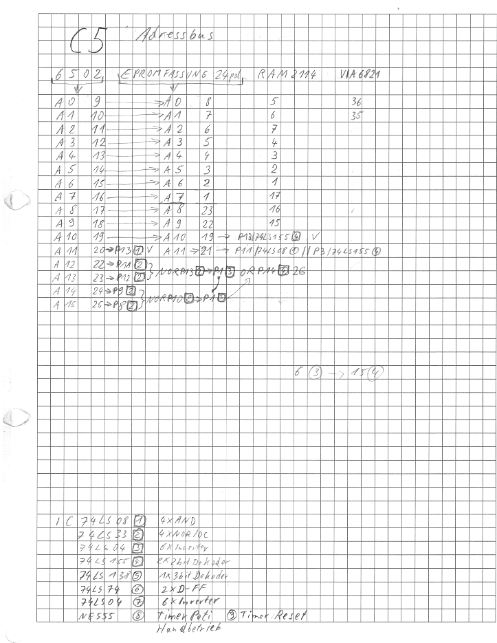

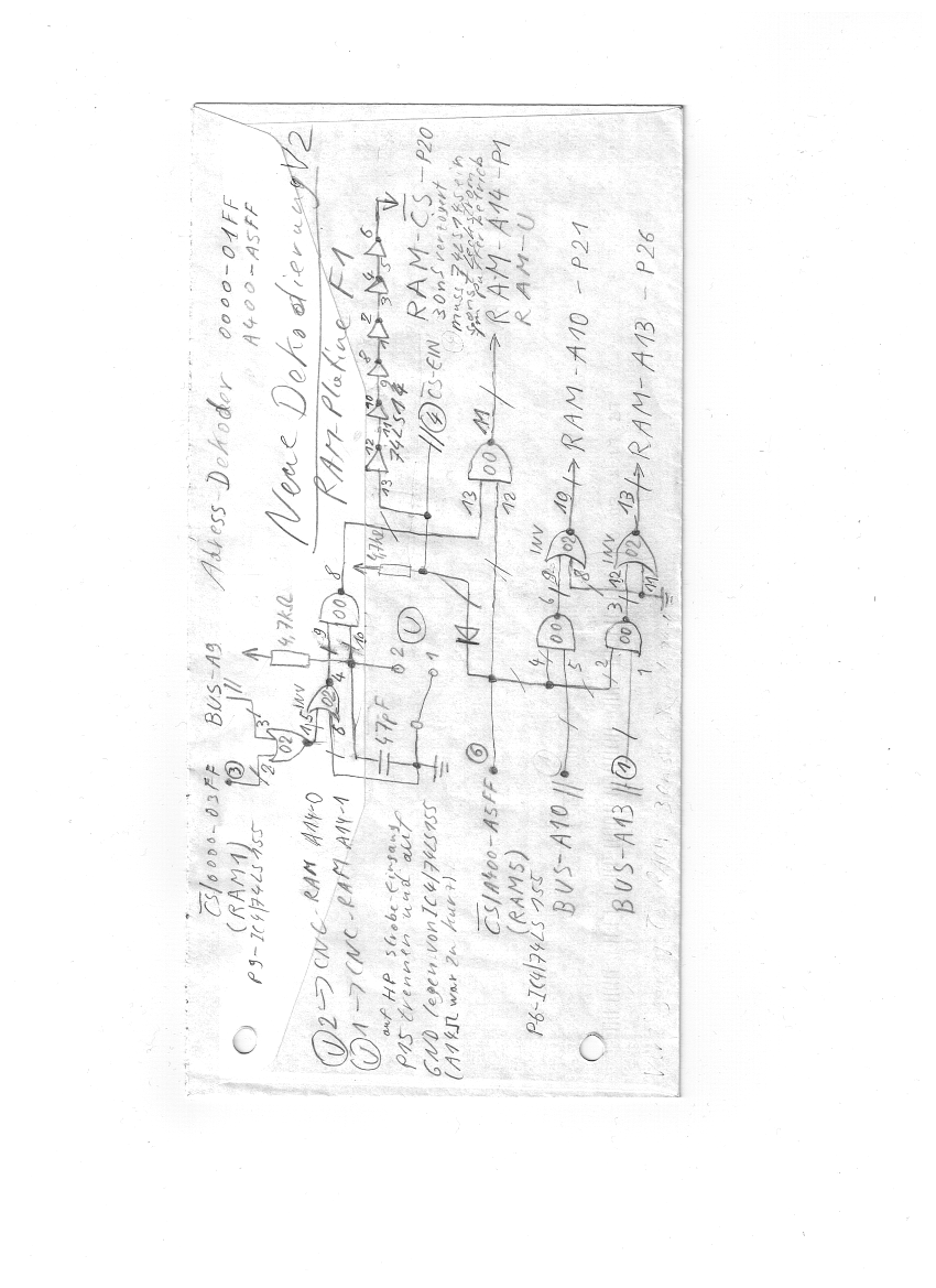

Don't expect detailed and professional drawings, I make a sketch when needed an it's good for ever.
Hope it's clear enough, the text is mostly in German.

To find the address scheme I build first a 8-bit trap connected to A8 - A15. With a probe I checked all CS's and the LED's
indicate the address of the components when accessed by making resets of the CPU. My idea was that the reset routine
write to all interfaces and RAM's for initializing.
File comment: The 8-bit trap with 74LS373 latch and an 74LS132 as R/S-FF. The orange wire is the probe.
Here is the result of my "research":
To get the remaining addresses not found by probing I had to retrace on the CPU:

I made an extension for 16-bit PC and Data address trapping and reading the data
with HEX-coding switches and added TIL 311 HEX- Displays:
A switch selects either only PC or PC with data address for reading data.
An other switch selects R/W or both when searching for data.
The DIP switches (you see them it in the background) allows finding of PC addresses by
disabling the last 3 latches, finding the highest address with the HEX-coding switches,
then enabling the next latch, finding again address etc to find the complete PC of an event.
It's far from perfect, it lacks of reading 2 Bytes immediately so I must make 2 reads for 16 bit data.
File comment: Extended 16-bit PC / Data address trap and 8-bit data readout with ancient TIL311 HEX displays.
I can switch them off, they get relatively hot, even with reduced voltage for the LED's.
I will make a try by pulsing the blanking input.
File comment: The original EPROM board with 2764 EPROM's and decoder.
EMCO made this board to upgrade from 2732 to 2764 EPROM's with the old CPU avoiding a new PCB layout.
File comment: Modified Version 1 with 27256 EPROM, 43256 RAM and Goldcap memory backup.
The new components are added in "Tube Radio" fashion.
Limited by the address range of the CPU a large area of the RAM remained unused.
File comment: Modified Version 2 with additional 2x CNC RAM address decoding board.
Now the whole RAM is used by switching between 2 CNC RAM areas, the ZP, the stack and a variable area remain the same.
The ribbon cable allows changing the EPROM without unmounting the Video board.
It adds however signal delay to the more complex address decoding, perhaps I need to remove it
or change to faster IC's when using 65C816 and higher clock rate,
it works with 1.5 MHz and original UM6502.

File comment: Sketch of modification on the Video board for CNC RAM switching and connection to the memory backup Goldcap on the EPROM board.
The leftmost free input from the DIP switches is used for display of CNC RAM area 1 or 2 on the monitor.
The other originally used switches select language and monitor frequency.
File comment: Modified Video board
