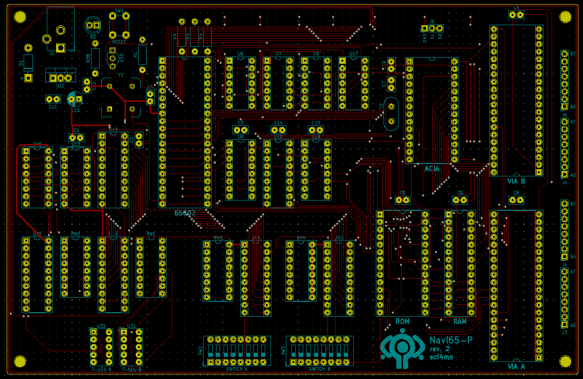

Looking at the circuit diagrams up-thread, I would note that the canonical method of generating /CS, /OE and /WE signals is:
1: /CS for each device should depend only on address lines, /VP, and (for the '816) VDA and VPA. It should not be qualified by Phi2; thus two gates should be removed from the RAM /CS chain.
2: /OE and /WE should be generated as ~(R/W & Phi2) and ~(~(R/W) & Phi2) respectively. They will then produce a pulse on one or the other line on every cycle, during a time interval when the address and /CS signals will all be stable.
At 1MHz the speed of memory devices is not likely to be an issue. Ensuring that relative timing requirements are met, however, is still just as important. If /WE is active at any instant when the address or data lines are not stable, then you can expect incorrect data to be written to the wrong places.
Well, unfortunately even this didn't fix it. I put the RAM and a 74HC00 on a breadboard and wired it up as you described; it worked just as it had before. Everything seemed fine except that the wrong return address is on the stack in the ISR.
And when I say wrong, I mean, off by hundreds of bytes. Strangely, the number of bytes it's off by seems to vary depending on the code I'm using. Haven't really noticed any pattern to it yet, but this is definitely a thing.
Would it be helpful if I uploaded images of the PCB itself? i.e. a screenshot from KiCad of the top and bottom copper layers?
PostPosted: Wed Jul 22, 2020 10:07 pm
Posts: 1373
Sure, a picture and such are worth... well, as they say. I've seen some odd issues with some static RAM over the years. Had a new one that was defective... nothing worked... turns out page $03 had some bits stuck on the early bytes, where I keep interrupt vectors.
Also, are you bypassing the chips effectively? CMOS logic tends to switch faster, so bypassing is critical (and the location of the bypass caps). One last thought... have you used a multimeter to ring out all of the address and data lines plus the rest of the access lines to the RAM chip? Lastly, have you tried another RAM chip??
PostPosted: Wed Jul 22, 2020 10:09 pm
Posts: 8432
It couldn't hurt. Screenshots are probably always the best way, rather than posting CAD files for CAD packages that others don't have. Gerber files are pretty universal, but even then, not everyone would have or want to install a gerber viewer.

I _think_ the bypassing I have should be sufficient, but... when I was designing the board, for whatever reason, I only ended up adding caps for some of the chips, instead of what I wish I'd done: all of them. It's not impossible that it's an issue, but it baffles me that the symptom would be so consistent if that were the cause, not that it's impossible. As for checking continuity, embarrassingly, I haven't actually. Will do so shortly. And, I haven't tried another RAM chip, so I'll be sure to order more of them next time I'm ordering parts (which has been all too frequent lately, lol). However, this is the same RAM chip I was using on the breadboard version, so I at least know it was working correctly before.

File comment: PCB Front
File comment: PCB Back
PostPosted: Wed Jul 22, 2020 11:46 pm
Posts: 1373
Well, a few things stick out:
1- You really do need more bypass caps... at least a 0.1uF on every IC chip. Also, as the board has some size, I would strategically add some additional 100uF caps around the board to maintain a low impedance on the supply traces.
2- Power supply traces are very thin... and some are quite long. There's an inconsistency with them as well... some are wider and some are quite thin.
3- The 7805 regulator, is it getting hot? Do you have a heatsink on it? Granted, the CMOS chips are all pretty low power, but the 7-segment displays can draw some current. What is the supply voltage to the board? Remember that the 7805 has to be some voltage level above it's regulated output to ensure proper regulation.
I would have likely gone for a 4-layer board with a ground and +5 plane. This would make things much easier for routing power. My small (3.8" x 2.5") Pocket SBC has 12- 0.1uF bypass caps plus 3- 63uF polymer caps for 7 chips total. It's also a 4-layer board and is dead quiet on noise. I'm a big fan of excess bypassing. Also, if you open sockets, you can hide the bypass caps under the IC itself. I do this on most of my PCBs, it's very effective for decoupling as you can get the bypass cap very close to the supply pin.
Hopefully adding some additional bypass caps will help, and perhaps swapping out the RAM as well for a test. Good luck on sorting it out.
PostPosted: Wed Jul 22, 2020 11:55 pm
Joined: Tue Oct 08, 2013 5:40 am
Posts: 72
Location: /home/sci4me
1. Will definitely be taking this advice for rev2!
2. I should've mentioned that although I have power traces in the pictures I posted, I actually have a ground plane on the bottom and a power plane on the top. I have no idea if making the top a power plane vs. a ground plane was a "good" or "bad" idea, but that's just what I ended up doing. So, those traces aren't really representative of the actual PCB.
3. The 7805 does get a little warm but since I raised the resistance for the 7-segment LEDs (by a lot), it's not "hot". I have a heatsink and sil pad coming in the mail tomorrow. I am using a 2A, 12V wall adapter.
As for going with a 4-layer board, I have no opposition to it, but I wanted to see if I could pull it off with just two layers; I feel like (as someone who isn't an electrical engineer) it's probably fine.
