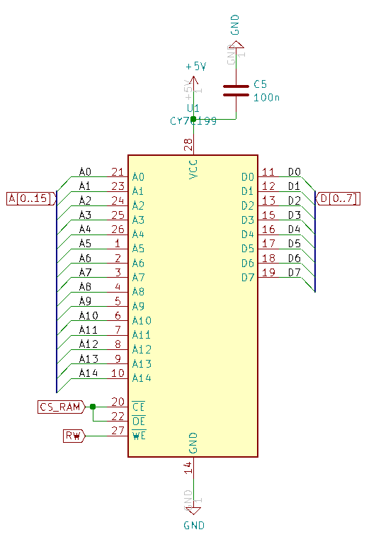

Hey everyone. So, I recently moved my 65c02 computer from a breadboard to a PCB. As far as I can tell, all the hardware is working as intended. However, there is a strange problem with interrupts. The RTI instruction jumps to the wrong place! I've printed this on the serial port: Expected address was $109F, Actual address was $A0A0. The heck?
First I thought I just had a stack issue. But after a lot of auditing (and even printing the stack pointer to serial...) I concluded that this was not the issue.
Then I thought maybe there's a problem with RAM. I wrote a test program that just writes to every address from $0100 to $01FF and reads the written byte back, and checks that they're identical. This problem never found any memory errors...
At this point I'm totally at a loss. I have started to try to build a little debugging jig (poor-man's logic analyzer basically) but haven't gotten that working with the entire computer yet (but it works with only the CPU lol).
I have attached the schematic. If anyone has any ideas, please do reach out! :)

I think the accepted wisdom here is that /WE should be qualified by phi2, but /CS should not be. The way you do it, you squeeze the entire RAM operation into one half of a processor cycle.

So if I read that right, /CS should be qualified by phi2 right?
Also, I just tried using the phi2 input rather than the phi2 output as the input to the decode logic, but it didn't seem to change anything other than that the actual address changed from $A0A0 to $10A0. Strange...

There's more than one way it can be done. You just have to make sure you don't write to RAM before the address is valid and stable, otherwise you may write to unintended addresses, even if by the end of the cycle the intended address also gets written to. This is because the address is not guaranteed to be valid and stable before the R/W line goes down. You can either just not select the RAM until phase 2 rises (which will be plenty of time after the address is valid and stable), or, if it's really slow RAM and you need the extra setup time, you can select it directly from the address decoding but keep its WR\ input false (ie, high) until phase 2 rises. SRAM is available in much faster speeds than anything else you'll probably put on the bus anyway though, so you probably don't need the extra time afforded by the second method.
The 6502 does not drive the bus during the phase-2-low period; so you don't have to be concerned with bus contention. Even when the 6502 does a store, the data are only guaranteed to become valid some time (tMDS) after phase 2 rises; so if the RAM is putting out data until phase 2 rises, driving its WR\ input low should end that before the '02 starts driving the data bus. As for hold time after the end of the write, bus capacitance will hold the data for a surprisingly long time when nothing is driving the bus—not just nanoseconds, not just microseconds, but even milliseconds, according to my experiments. (Actually, I tripped across that fact accidentally, and although I observed the milliseconds part, I did not go further to see just how long I could take it.)
I tried looking at your .pdf schematic, and all I get is eight totally blank pages.

There's more than one way it can be done. You just have to make sure you don't write to RAM before the address is valid and stable. You can either just not select the RAM until phase 2 rises, or, if it's really slow RAM and you need the extra setup time, you can select it directly from the address decoding but keep its WR\ input false (ie, high) until phase 2 rises. SRAM is available in much faster speeds than anything else you'll probably put on the bus anyway though, so you probably don't need the extra time afforded by the second method.
I tried looking at your .pdf schematic, and all I get is eight totally bank pages.
Huh, that's really weird. I'll post pictures of the relevant parts. Also, I am using a 1 MHz crystal oscillator for my clock and the RAM is a CY7C199-35PC. I had this all working on the breadboard so it's confusing me that the PCB version is having this issue now. The fact that interrupts are the only thing having any problem like this suggests to me that it may not actually be that I've made a mistake in the hardware, but I find it hard to believe that at the same time, because I don't see how it could be a software mistake, given that I've been using incredibly simple programs just for testing this specific issue.

I don't offhand see anything wrong with that. You've got a lot of gate delays there, but if you're running at 1MHz, it should be fine. I did edit my last post above to clarify something, but it probably won't affect your circuit. What's in your interrupt code?
