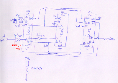

Thanks for your replies. I attached schematics for the breadboard computer.
I personally think that I did somehow damage the 6502, why would it otherwise get warm? Or is that normal?
In any case the goal now is to see if the chip can be made to work.
As I said, I have confirmed it does still work, but unreliably.

Yes, this is certainly important. It's not a good sign that you were "measur[ing] high frequency oscillations between 0 and 5v on all the data lines and address lines." :shock:
Prior to your latest post I began some annotations to your schematic, which I will share now. On older 65xx systems it was SOP to take the Phi2 and /Phi2 signals from the outputs on pin 39 and pin 3 of the 6502, and as you're using vintage parts it may be helpful for you to do the same, rather than taking them from the input side (where I've marked). It may also be helpful to feed /Phi2 to the /OE input of the 28C256, for the reasons explained here. Neither of these changes is a sure-fire fix. I'm more suspicious about bypass caps and power, and the clock signal.
The Schmitt trigger is certainly worthwhile -- your Signal Generator needs to provide crisp transitions.
You should probably consider debouncing the reset signal, BTW. There are some suggestions in Garth's primer, here.
" :shock: " Indeed... I don't think that was caused by noise, maybe my ground probe was detached or something, although I find that unlikely.
I should note that this breadboard version and the schematic I posted of it isn't really similar to what I have soldered, it was just a test to see whether my ic's were broken or not and whether I was still able to create a minimal working system.
The clock on the soldered version comes from a 1mhz can oscillator, so I assume that should provide a clean clock signal. It has worked before anyways. I also made a simple reset circuit that not only should provide a clean reset signal, it also provides two reset signals, so you can make sure that the IO resets before the 6502.
So, clock and power are well worth getting very clean
I did take care during soldering of ensuring good power and ground connections, as well as 100nf bypass capacitors, so I think that shouldn't be a problem. The power supply is a simple 2n3055 emitter follower to step down 12v to stable 5v, along with a 1000uf electrolytic capacitor. I'll try however whether I can measure any significant noise.
I believe I did once try to get the phi2 for the 6522 from the phi2 output of the 6502, but that didn't work, so I then decided to just use it directly from my clock.
Since I got a computer up and running before soldering one, I can rule out most possiblities. That means that the problem should be a soldering error or something that I have changed. I triple checked every connection and possible shorts, so I don't think there is a soldering error. The only things I changed were the memory map, the reset circuit and the power supply. I have confirmed the reset circuit works. The power supply also works, but it may be noisy, so I will try powering the computer from my bench power supply. At first I also did make a dumb mistake in the memory map, as I reserved 48K of RAM for a 32K chip :lol: . If it can be of use, I'll draw up a schematic of the memory map.
