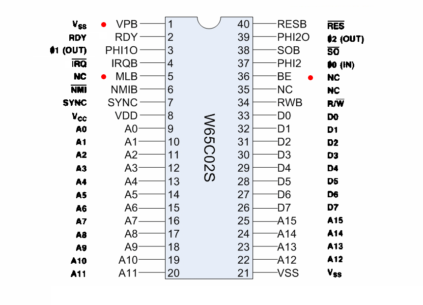

Briefly, to replace a vintage 6522 with a modern chip from WDC you want W65C22N, not W65C22S. The S version is updated (and arguably improved) by making the /IRQ pin a normal, totem-pole output, but for backward compatibility you want an Open Drain output as featured on the N version.
Re the WDC CPU, be aware that pin 36 (BE) needs to be pulled high and pins 1 and 5 (which are now outputs) must be no-connect. To make these changes you can either inspect and modify the traces on the PCB, or bend the 3 pins outward so they don't engage the IC socket then solder a jumper on 36.
Have fun and keep us posted,
