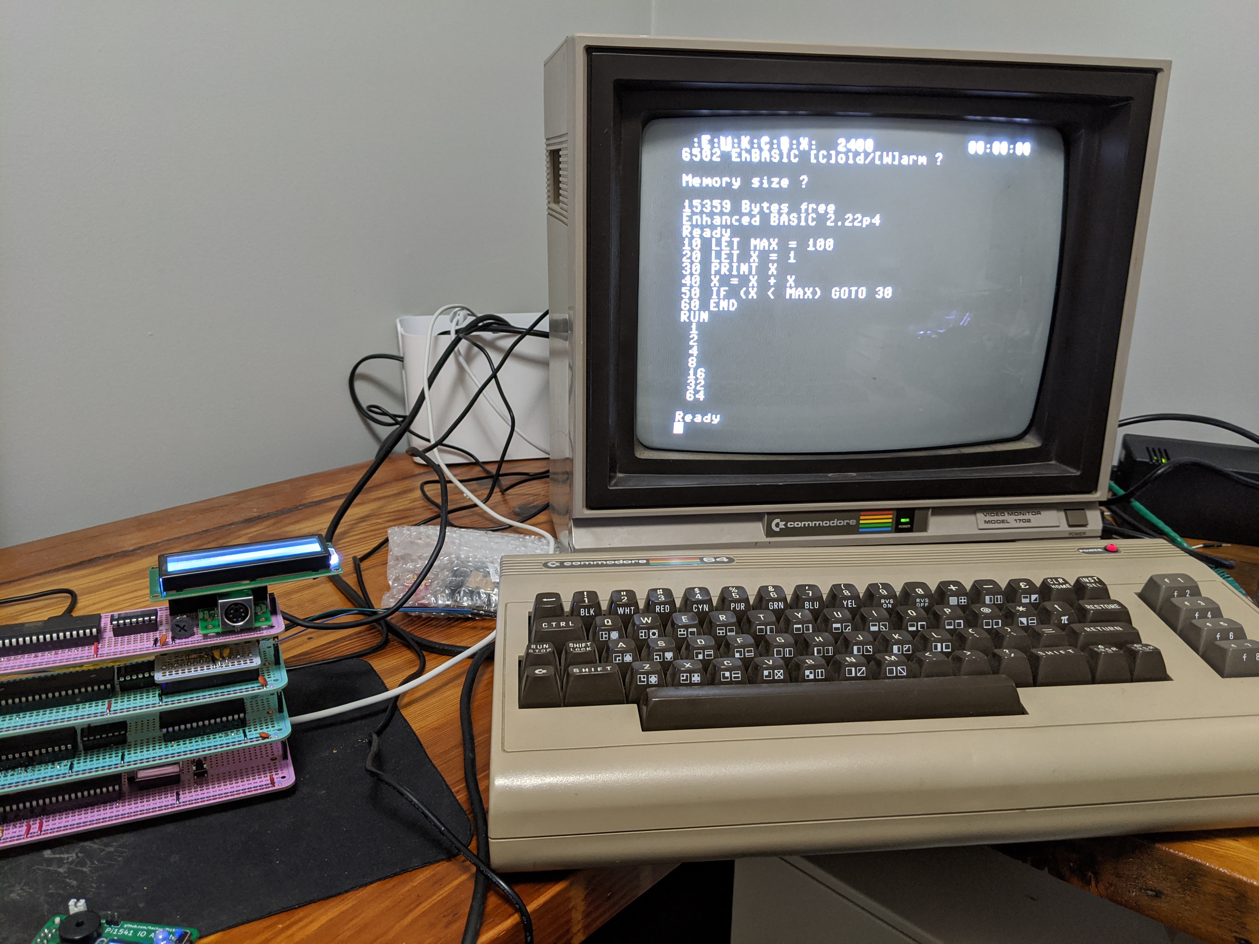

Hi everyone.
I've been playing around with building some 65c02 systems since last fall. After seeing the work being done on the 8-bit guy's Commander X16 computer and playing around with programming a game in 6502 assembly for it (https://www.youtube.com/watch?v=-Gw56Zh5yP8), I was inspired to try my hand at designing my own computer.
File comment: Early work base on Ben Eater's videos.
I started with something based around Ben Eater's breadboard computer and eventually soldered together some stackable modules, but so many wires made it very finicky and I tried my hand at designing a pcb.
File comment: Using a C64 as a serial terminal to connect to my stack computer.
File comment: First custom pcb build.

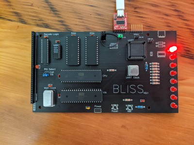

I'm currently on my second PCB version.
File comment: Newest PCB.
In my earlier versions, I was using an arduino and then an ATMEGA328P for serial communications, since I knew what I was doing with that.
My newest revision uses the SC28L92 DUART as recommended by BigDumbDinosaur (http://forum.6502.org/viewtopic.php?f=4&t=4587)
I had a few issues that were caused by the Programmable logic chip I'm using for address decoding, but that seems to be working fine now. The DUART is the last thing I need to figure out how to program for.
I've been looking through the docs from BigDumbDinosaur and I now mostly understand how to talk to it, and I can write to a register and read it back, so the chip is at least somewhat functional, but I haven't been able to establish a working serial connection. I've occasionally been able to get the RX light to light up on my Serial to USB board, but nothing is showing up in the terminal.
Does anyone know what the minimum number of commands would be to get the SC28L92 to output anything on serial?
Setting up auto echo would work just as well I think.
I definitely need to set up the m0, m1, and m2 registers, as well as the csr and asr.
What else is absolutely necessary?

Don't forget about the interrupt mask register (IMR). While it is possible to run the 28L92 in PIO mode, it's pretty inefficient, especially if the serial port is running at high data rates. See below for the data table I use to set up the DUART, as well as the values to be written into the registers.
Thanks for all of that! I've definitely made a lot of progress in the past few hours. That fix for the dummy read was very helpful. I know I saw something about that in the doc you had written about driving the SC28L91, but I had completely forgotten about it.
When slowing the speed to 9600, I am now able to send a value from a terminal and receive a value back, though it is currently the incorrect value. I assume there is some value in the configuration I have set wrong, My code is quite a mess with all the things I've been trying and there are bound to be problems in it. Hopefully I'll figure out the problem tomorrow.
PostPosted: Sat May 16, 2020 1:18 am
Ah yes, I looked up only the izp mode (which *is* 5 cycles) without double-checking STA izy.
But since the 65C02 only re-reads the previous address accessed in the indirect indexed mode, that address is now in zero-page, well away from the UART. I'd say it's a better solution (and still a cycle faster) than offsetting the base address of the index purely to ensure a page-crossing. It's also more general, since it now works even if the device is not at the bottom of a page.
PostPosted: Sat May 16, 2020 4:04 am
Posts: 8509
jjbliss wrote:
I've definitely made a lot of progress in the past few hours...When slowing the speed to 9600, I am now able to send a value from a terminal and receive a value back, though it is currently the incorrect value. I assume there is some value in the configuration I have set wrong, My code is quite a mess with all the things I've been trying and there are bound to be problems in it. Hopefully I'll figure out the problem tomorrow.
At this point, it's likely a data rate or format error in your setup. Are you sure the terminal is running at 9600? If you're positive it is, then you need to verify that you are using the right number of data and stop bits, and that parity is off, unless the terminal is expecting parity (a rare expectation, in my experience).
As an aside, the setup table I earlier presented configures the channel for 115.2Kbps and 8N1. You probably just need to tinker with the data rate.
PostPosted: Sat May 16, 2020 6:44 pm
Joined: Tue Dec 31, 2019 11:13 pm
Posts: 5
Still haven't quite got it yet. I'm pretty sure it is some sort of data rate issue. I have disabled RTS/CTS to simplify things. I think this should still work without that, right? I've set up a driver similar to the one you outline in your doc, so it's possible I've messed something up in there too, but that part seems to be working as far as I can tell. I've set up a program to display each incoming byte on the LEDs while echoing back, then advance to the next with a press of the NMI button. I've tried a few different terminal programs to connect to it and a few different usb serial adapters and while the exact characters that show up are different, the results are pretty much the same. A single key press will be picked up as multiple incoming bytes. For instance, if I press 'q' in a terminal program it recieves $06 followed by $FE.
To make sure that it wasn't caused by my code reading the table, I've temporarily switched my setup code into individual writes.
I think this should set up 9600 with 8 data bits, no parity, 1 stop bit, and no RTS/CTS.
  ;IMR (disable IRQs)
  lda #0
  sta nx_ubase+nx_imr
  lda #nxpcrrsd ;deassert request to send
  sta nx_ubase+nx_cra
  lda #nxpcrrxr ; reset receiver
  sta nx_ubase+nx_cra
  lda #nxpcrtxr  ;reset transmitter
  sta nx_ubase+nx_cra
  lda #nxpcrbir ;reset received break change IRQ
  sta nx_ubase+nx_cra
  lda #nxpcresr ;reset error status
  sta nx_ubase+nx_cra
  lda #nxpcrtmd ;select C/T counter mode %11000000
  sta nx_ubase+nx_cra
  lda #nx_arbrt ; %01100000
  sta nx_ubase+nx_acr
  lda #nxpcrrtd ;disable transmitter & receiver
  sta nx_ubase+nx_cra
  ;Set up mode registers
  lda #nxpcrmr0
  sta nx_ubase+nx_cra
  lda #nxpm0def ;%11001100
  sta nx_ubase+nx_mra
  lda #nxpcrmr1
  sta nx_ubase+nx_cra
  lda #nxpm1def ;%01010011
  sta nx_ubase+nx_mra
  lda #nxpm2def ;%00000111
  sta nx_ubase+nx_mra
  lda #nxpcsdef ;%10111011  Should be 9600
  sta nx_ubase+nx_csra
  lda #nxpcrrte  ;enable transmitter & receiver
  sta nx_ubase+nx_cra
  lda #nxpiqmsk
  sta nx_ubase+nx_imr
