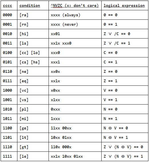

Slightly off-topic, I based this table on the 68xx behavior, but inverted the C flag to more closely mimic the 65xx behavior for my "work-in-progress" CPU design, which draws heavy inspiration from both families:
PostPosted: Wed Apr 29, 2020 11:26 am
I think that is one case where it can occur, yes. But aside from BIT, it does not. The combination is invalid for a numeric comparison.
