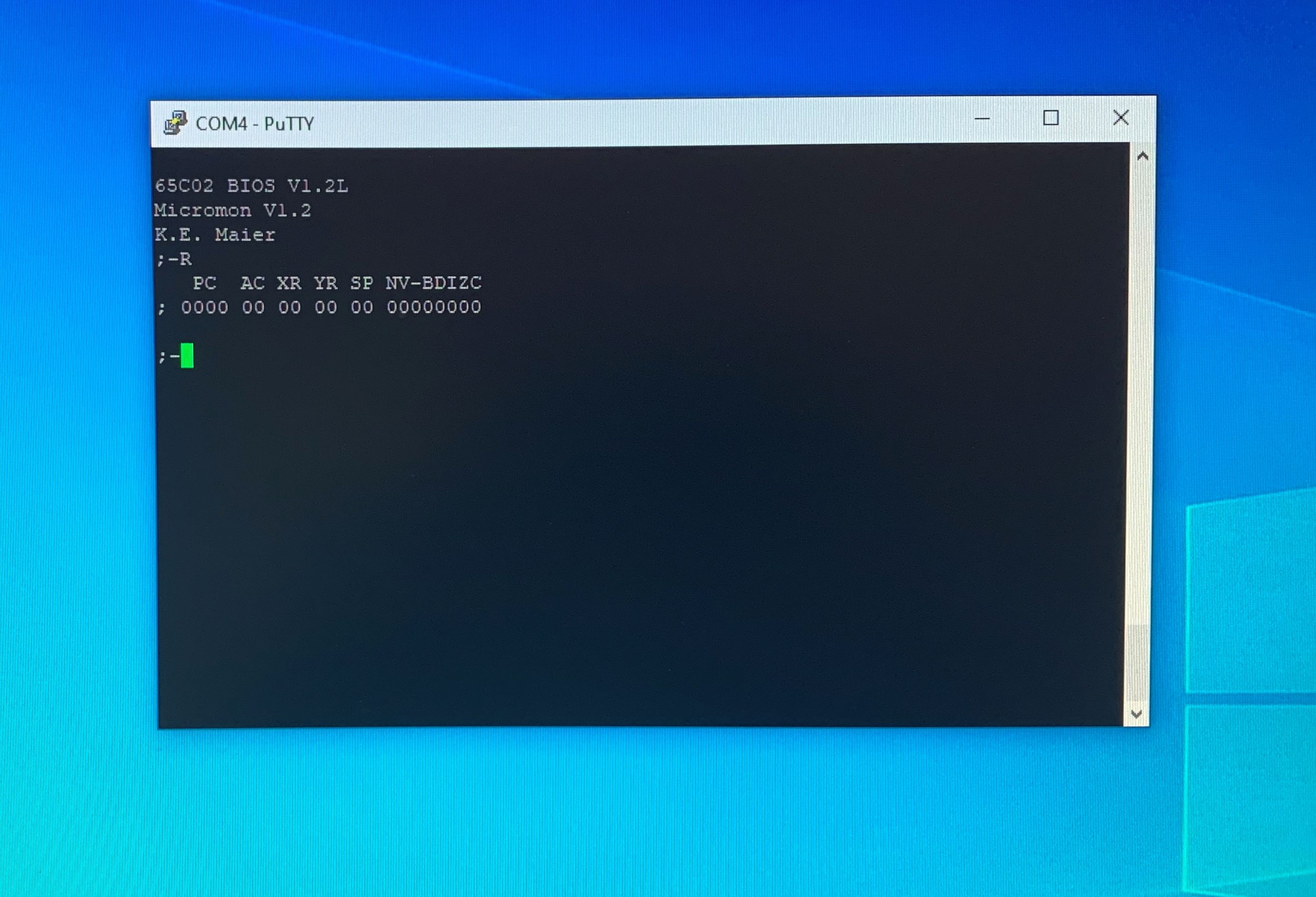

I got the interrupt lines from the 6522 and 6551 connected to the CPU. I must have done something right because this works. Thanks floobydust!
If anyone is wondering, I used an AND gate like shown in figure 3 on Garth's 6502 Interrupts page.

That's great... basically why I did the Micromon code, which was cobbled down from the larger BIOS/Monitor. Quick and easy to get a 6551 running as a console.
If you grab the code for the SBC-01 (V104), it has full interrupt code that enables the timers on the 6522 as well for accurate delays and a RTC implemented via a 4ms timer interrupt. It does a lot more than Micromon and will allow you to check out all of the hardware (6551/6522). Have fun... and post some pics of the build!
Not a criticism or anything, but I notice that Micromon doesn't show the state of the unused status register bit (bit 5). That bit is permanently set in the 65C02 (and 65C816 in emulation mode). I've been staring at 6502 register dumps for so many years (43, to be exact) the unset bit immediately jumped out at me. :D
PostPosted: Fri Mar 27, 2020 5:06 am
Posts: 1385
Well, actually it will :mrgreen: A closer look shows that Micromon was just booted followed by the Register command. As the variables are in page zero (which is cleared on a cold start) everything shows zeros. A send-break from Putty, executing to a BRK instruction or executing code via the Go command will populate all of the variables from the CPU and show them correctly. As it's name implies... it doesn't take much space, just 1.75KB, yet it provides a decent amount of function, is extendable, has a JMP table and runs the 6551 in interrupt mode for transmit and receive with a pair of 128-byte circular buffers.

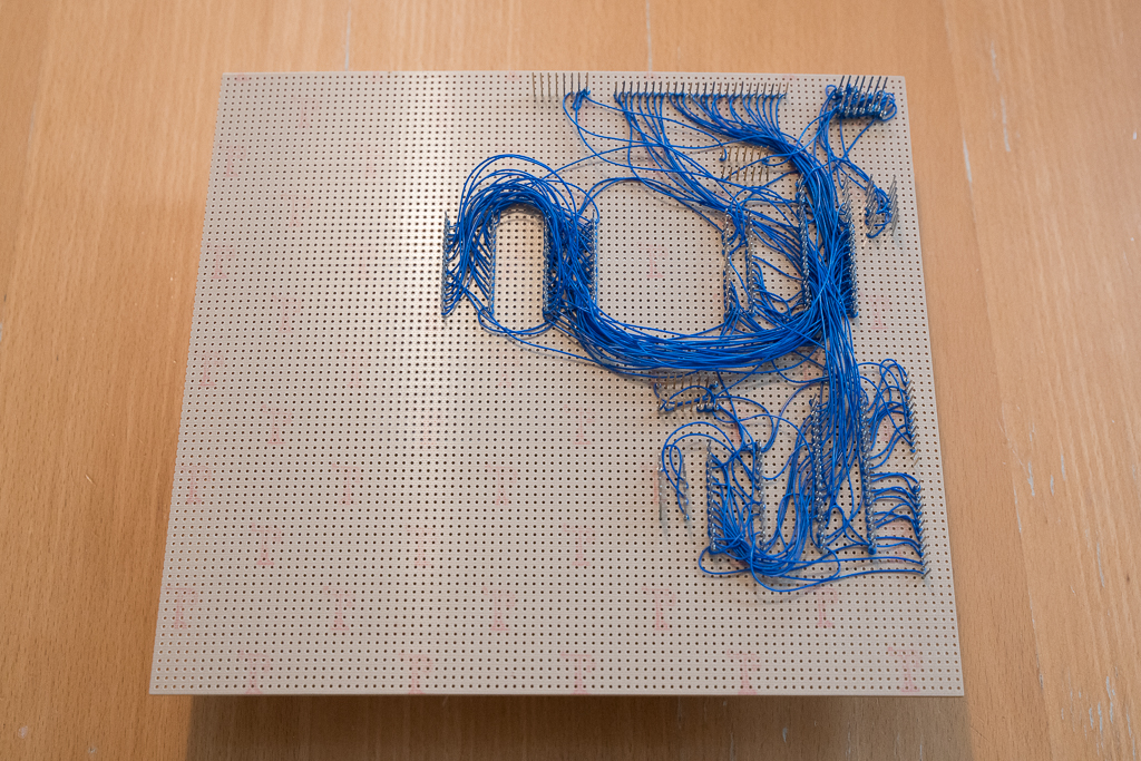

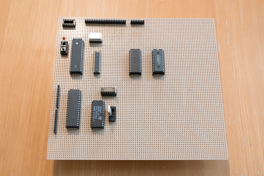

Photos as requested.
The socket in the upper left hand corner is where I connect +5V and ground.
The header running along the top is the address and data buses, clock and RW signals. This was very helpful for troubleshooting early on, but I haven't used them for a while.
The headers on the left side are Port A and Port B of the 6522 and Tx and Rx from the 6551.
The empty space in the top row of ICs is for the wait-state GAL for when I try to go to 10 MHz.
Initially I had all of the sockets "shoulder to shoulder", but I couldn't see what I was doing, so I spread them out. I may have spread them out more than I needed to. I would have liked to keep the wires much shorter. Also, I don't know if I should have tried to route the wires more directly, but I think routing them the way I did made it easier for me to see what was connected.
No filter capacitors right now. I tried wire wrapping them directly but didn't like the result, and I am running low on sockets.
When I went to connect the interrupts from the 6522 and 6551 to the CPU I found that the way I had initially tied /IRQ, /NMI, BE, RDY and /SOB high made it difficult to disconnect /IRQ. I seem to remember thinking at the time that I was going to want to be able to easily change it later and should probably not daisy chain it with the other pins. I'll probably run into the same problem when I go to connect RDY to my wait-state generator. Oh well, live and learn.
I don't have a lot of experience wire wrapping, so I don't know if this looks awful or not and would love to hear how I could have done better.

PostPosted: Sat Mar 28, 2020 3:18 am
Online
Shawn Odekirk wrote:
.I don't have a lot of experience wire wrapping, so I don't know if this looks awful or not and would love to hear how I could have done better.
The 6502 primer has a section answering WW questions and doubts, at http://wilsonminesco.com/6502primer/WireWrap.html .
