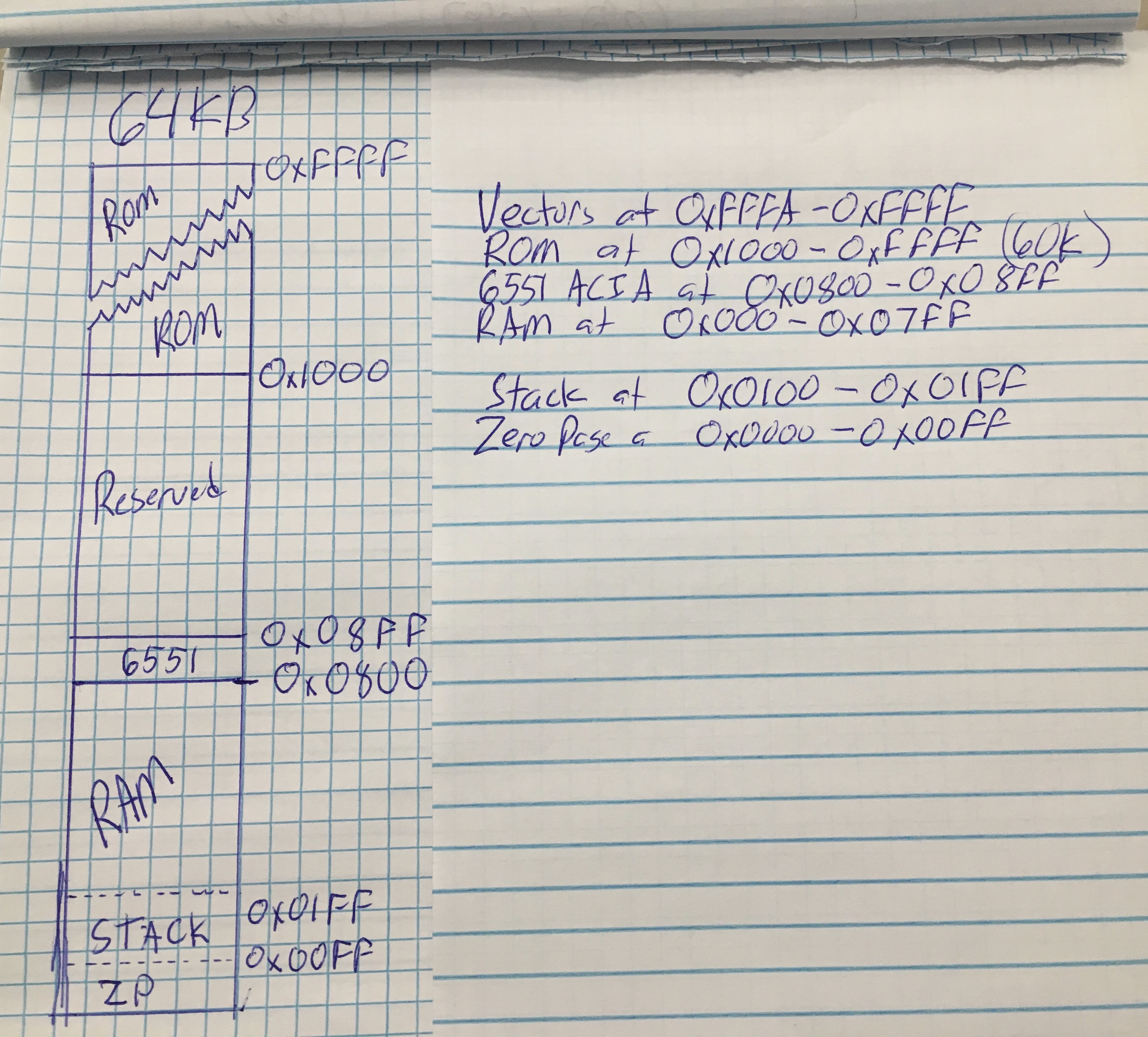

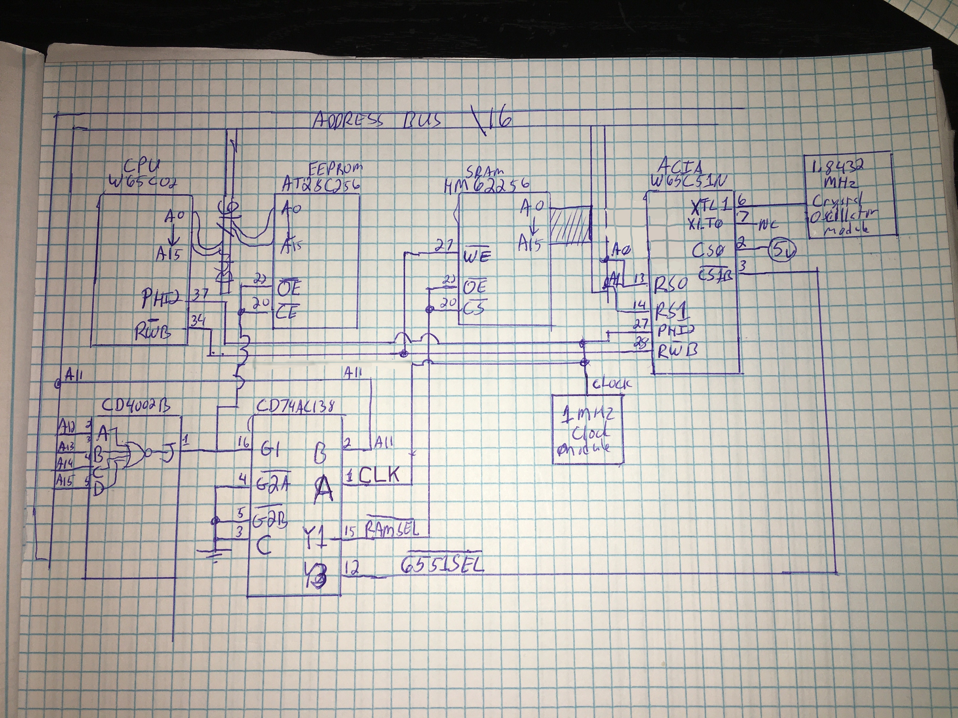

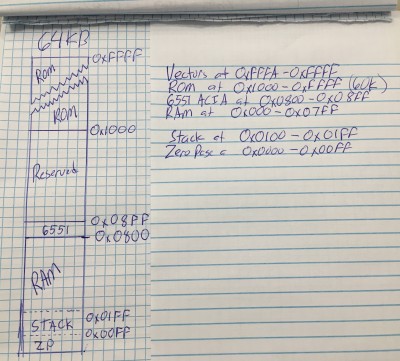

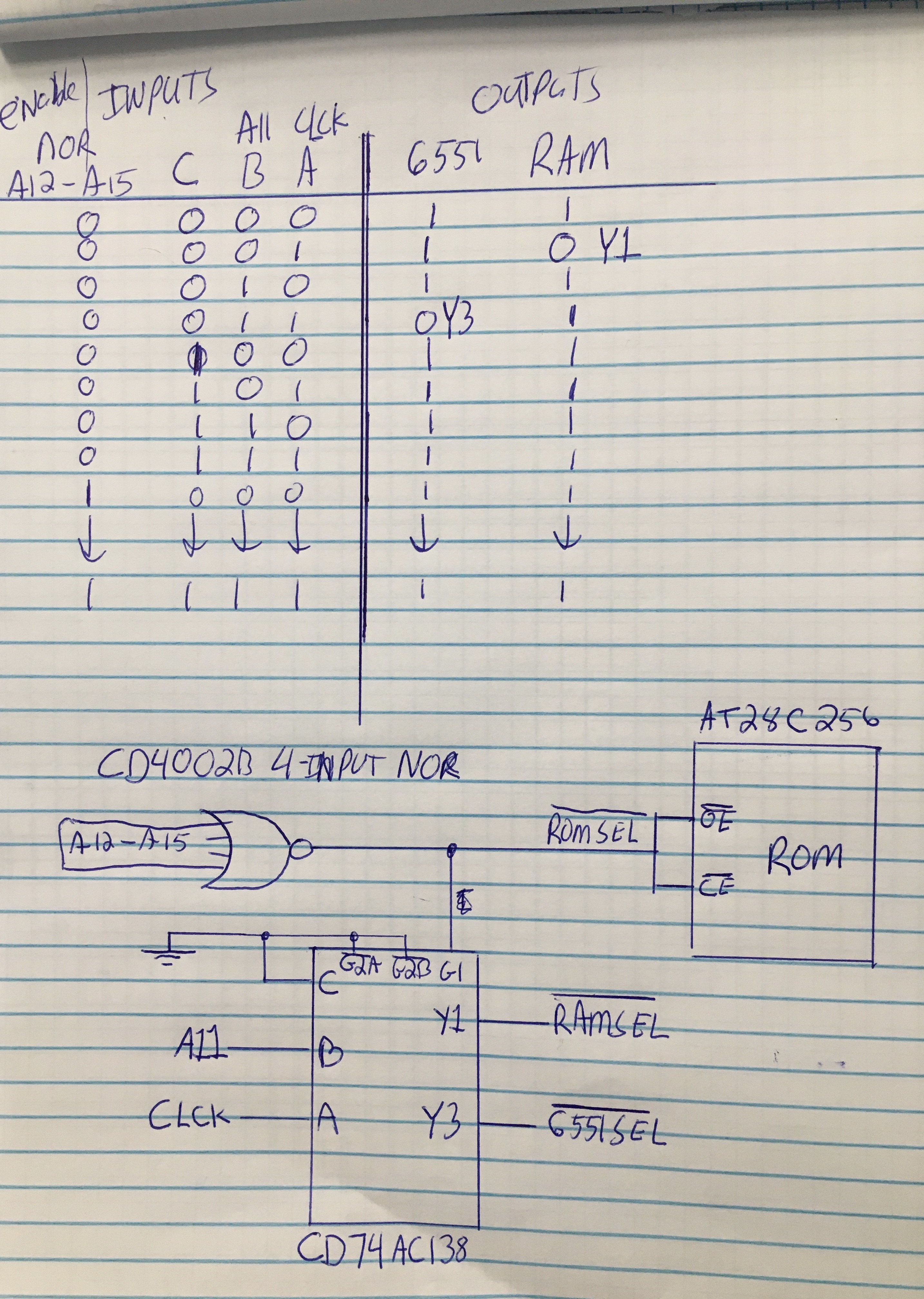

I've created the Memory Map, truth tables and resulting decoder logic, and a rough schematic of just the address bus, clocks and decoders with the w65c02, w65c51, EEPROM and RAM. Parts are starting to arrive so hopefully I'll be able to start the build soon. I've been drawing and redrawing these for a couple of days. If anybody gets a chance can you give it a quick once over to make sure I didn't do something stupid. This is my first build for one of these.

I see a couple of likely problems:
  1. The CD4002 is a very slow part, far slower than the rest of the logic. At 5 volts, the minimum prop time is 125ns and could be as slow as 250ns. Unless you plan to run the machine at a crawl this is not acceptable performance. It might not be able to reliably function with a 1 MHz Ø2 clock.
  2. The use of Ø2 to qualify selection of the 74xx138 is unnecessary and in fact, will not work as expected. The 65C51 must be selected before the rise of Ø2, else it will fail to respond to the MPU. See below about qualifying read/write with the clock.
  3. You have /WE on the SRAM directly wired to RWB on the MPU, with /CE being driven by the 74xx138 decoder. By eliminating the clock signal to the decoder, the SRAM will be selected as soon as a valid address appears, which will be before the rise of the clock. What should be qualified by Ø2 when accessing non-65xx I/O device is read/write, especially a write operation. The reasons are several:
    1. The address bus will be changing during Ø2 low and the potential exists for a wild write if /WE is low before the address bus is fully settled.
    2. The data bus is not guaranteed to be valid when Ø2 is low. If you enable writing while Ø2 is low an undefined operation might occur in the hardware as the data (and address) bus settles.

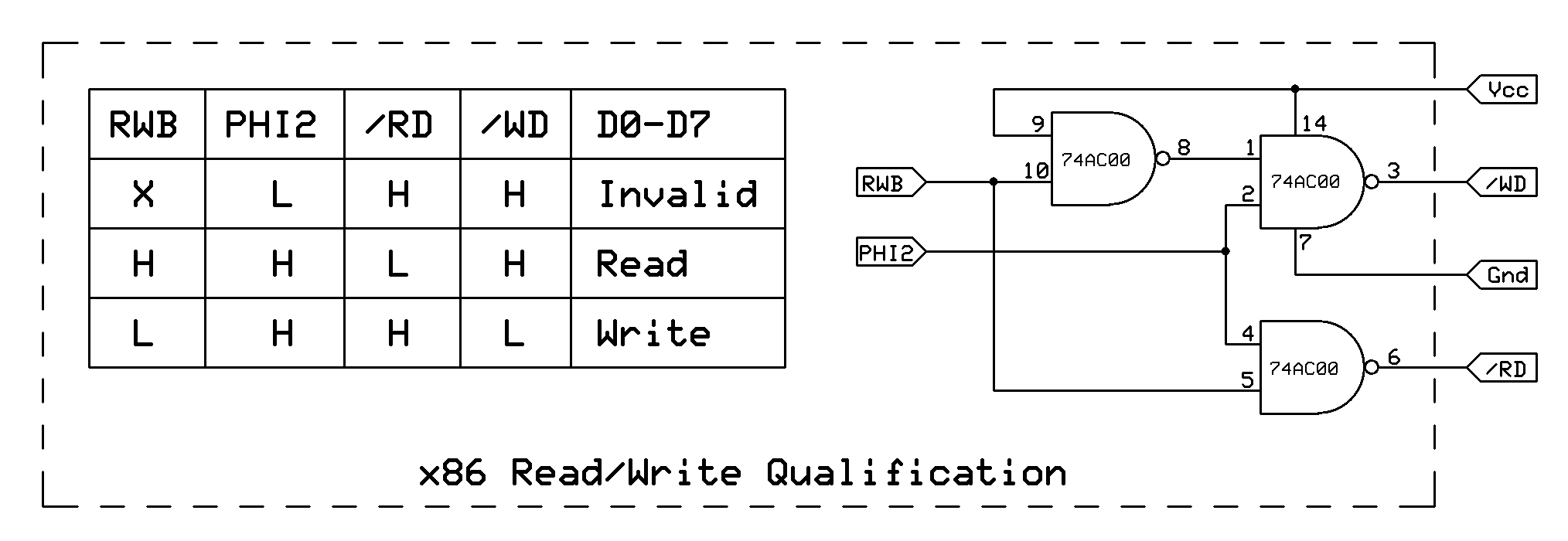

    Note that 65xx peripherals, such as the 65C22, understand the 65xx bus cycle and its relationship to the clock, and are not to be qualified by Ø2.
    A typical read/write circuit for use with non-65xx peripherals is as follows:
    File comment: Read/Write for Asynchronous Devices
  4. Similarly, the ROM should be selected during Ø2 low, as you are doing, but its output should not be enabled until Ø2 high so as to give the address bus time to settle. The above read/write circuit also accounts for this; connect /RD to /OE on the ROM, as well as on the SRAM.
  5. I recommend using a 74HC138 decoder. 74AC hardware generates extremely fast edges, which may cause a variety of problems, especially ringing, if physical construction is not on a multi-layer PCB or a well-designed wire-wrap layout.
I'm not sure I understand why you have such a strange memory map. Also, are you aware that the 65C51 as produced by WDC contains a serious hardware bug?

You're using a 32KB x 8-bit EEPROM and a 32KB x 8-bit static RAM. So you can't actually have 60KB of ROM. I would suggest you simply split the memory map, i.e., the first 32KB be RAM and the rest is EEPROM. If you replace the CD4002 with a 74HC30, you can carve out a single page (256 bytes) for I/O and use the 74HC138 for 8- 32-byte wide I/O decodes. You would also add a 74HC00 to quality a read and write signal for RAM/ROM (and decode). For more detail , consider looking at Daryl's SBC2:
http://sbc.rictor.org/info2.html

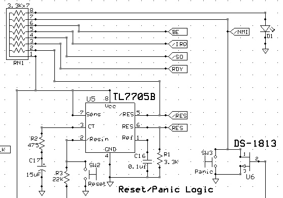

I'd also lose the W65C51 due to the hardware problem. If you are set on a 6551 type device, look for a NOS Rockwell R65C51, otherwise consider one of the Philips/NXP UARTs.
Also ensure you have all of the proper 65C02 lines pulled high via pull-up resistors, i.e., RDY, IRQ, NMI, RES, BE, SO. Here's a circuit that does that along with dual Reset (active high and active low) and a NMI trigger.

Ooooooh very good catch on the size of the EEPROM. I can't believe I didn't catch that already. I do have 53kB of data to store, plus I need some room for program code, so I really do need that much ROM. I can be a little loopy the days following chemo. Those anti-nausea meds are bit methy. I apologize in advance if you see my posts start to get strange about every 3 weeks.
I should have linked my first thread to show the reasoning behind this strange memory map, for this special purpose, non-interactive machine. It's going to be in a display case outside my office, running a loop of the SL train animation out the UART. An RPi will be the receiving end and of the UART transmission and performing the output to a terminal on the monitor. I'm aware of the transmit bug in the W65c51. I saw there's a workaround using a 6522's T2, but I feel that is overkill for this application. Since I'm just going to be reading a byte from an array in ROM, and placing it in the transmit register on the 6551, increment ROM address and repeat, then do the whole thing over again, I can tune up a reasonable number of NOP's to make it work smoothly. It'll never receive anything from the UART, and it will never do anything other than this loop. This will not be a general purpose machine. If I ever want to make it more general purpose, or come up with another idea that maybe interacts with people through the glass via bluetooth or xbee, I'll tear it apart and rebuild it using a more sane memory map and probably add a 6522 for more versatility in communications to the outside world, as well as gaining some really handy timers.
Yeah, I didn't like the speed of the CD0002 either, but wasn't able to find any other 4 input NOR gates, nor did I like the 2-input NAND substitutions for it. It was part of what pushed me to use 74AC parts instead of 74HC parts, even though I know that minor speed difference doesn't put a dent in how much time i'm losing with the CD4002. So it looks like I need to find another solution for my ROMSEL. If any of the top 4 bits are lit, then I'm ROM, if not, then I'm RAM or IO. Maybe a 2-input HC NAND substitution for a 4-input NOR will be faster? or some other substitutions in HC will be faster? I saw how deep the cascading was getting on these substitutions and thought that we could be approaching CD4002 delays with much more wiring anyways.
I'm planning to leave this on a solderless breadboard if it works alright like that so you're note about 74AC not working well will certainly be headed. I'll get HC parts. If I HAVE to, I'll solder up on protoboard, but I'd like to avoid the work if possible considering this is just a display piece, and a solderless breadboarded item, if done neatly, will draw a bit more attention than just another circuit board in a display case in an engineering department.
There's a to digest here. I see where I made some rather serious reading issues on the primer's very basic whole computer schematic and I think I misunderstood some things about the cycle and the timings on the laughtonelectronics timing page. I'll go back to those references and try to tie all this together with your suggestions.
To be clear, whatever logic for the decoding should always be enabled, correct? Otherwise if the won't be ready for their cycle, right? So always having the ROM decoder enabled was good, but disabling the 138 was bad. It's OE's being controlled by the PHI2 that will time the usage of the Data bus, and the read/write qualification to coordinate if the device should be reading or writing. I did get the CE and OE on the ROM being tied together from the primers whole computer schematic but I can also see what you're saying about allowing the bus to settle.
Do you have any suggestions on decoding the ROMSEL(bar)? If I switch to CD74HC4002 that looks like it will be way faster than the CD4002. Definitely shouldn't reach the potential max delays of the CD4002. I'm not sure why I didn't find this part in my search before

in working out the ROM issue, and needing 2 ROMs to make this work, I'm finding that a 3-input NOR, such as the sn74HC27 MIGHT fit my needs better, as I can then generate ROMLSEL and ROMHSEL signals to enable the upper or lower ROM. So I think I'm jumping the gun on the questions about the NOR gate stuff right now until I try to work out those details a bit more on my own to correct my ROM error and multiple other timing and logic errors. I'll post back once I try and figure those out some more and have a system that I think will work.
