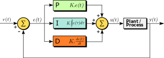

For instance, when implementing a PID controller with your computer, and you are adding the partial sums with, let's say, 32 Bit fixed point math:
before writing the result into a 16 Bit D\A converter with a +10V\-10V output range, you need to limit/clip the result to +32767 (+10V) and -32768 (-10V).
Else, if your 32 Bit result would be, for instance, +32768 (+10.0003V), that's hexadecimal $00008000.
For the 16 Bit D\A converter, it would be just $8000, that's -32768 decimal, so it would give out -10V (a big negative voltage instead of a big positive voltage),
and your servo loop would have a tendency to sometimes go "off track" for no appearent reason.
