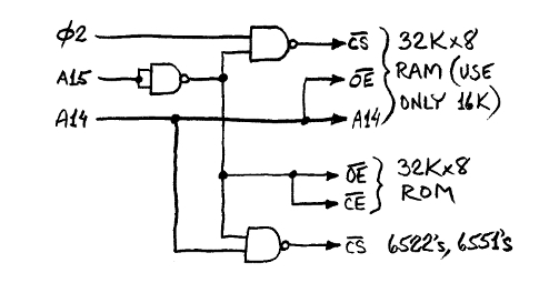

I'm looking at options for address decoding and came up with a question, would appreciate any comment.
Say I used an n to m decoder (e.g. 74LS156), with open collector outputs, but I wanted the decoding to be asymmetric (e.g. to get blocks of 8k, 8k, and 16k, out of 32k), would it be practical to do a wired-or with pull up resistor to combine some decoder outputs to use as a chip select?
You should be able to use the wired-OR method, as long as you understand parasitic capacitance will limit how quickly the chip selects will return to the logic 1 state. My practice has been to use the smallest value pull-up resistor consistent with the sinking capabilities of the device—which isn't much for any 74LS hardware. As an aside, you may be better served here with a 74HCT equivalent to get the stronger fanout of CMOS.

As BDD said, open-collector outputs are extremely slow to rise back to a logic 1. Take for example a 3.3K resistor pulling up a line that has only 22pF capacitance on it, including all the inputs, traces, and sockets. It will have a time constant of over 72ns!!!

For 1..2MHz PHI2, using open collector outputs with pullup resistors would do,
but sooner or later one would want to rise the PHI2 frequency of his 6502 system,
and then the resistance of the pullup resistors would have to become too small for making open collector outputs a practical thing.
//That problem with the ghost interrupts at 20MHz PHI2 with open collector /IRQ pins.
So I would suggest to start with an address decoding logic like in Garth's 6502 primer. //The link is up in the thread.
If things are getting more complicated, there still is 74HCT138\74HCT139.
Note, that the 6522 has a high_active and a low_active chip select input,
creatively making use of this could simplify the address decoding when building a 6502 computer.
