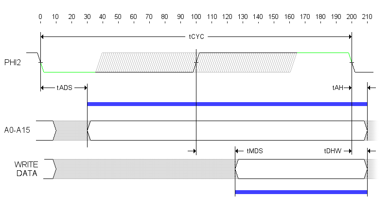

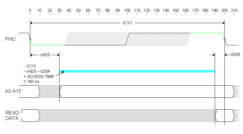

When the 6502 wants to read from memory
or when the 6502 wants to write to memory
In both cases the address bus is valid when PHI2 is high so I don't need any delay
But I need a few nano seconds delay before I read or write to the data bus, or am I wrong and there's no need to wait at all ?

It might be worth a more careful study of Jeff's diagrams. Part of the message about 6502 timing is that the Phi2 rising edge is not a timing reference. It can be useful but nothing is defined relative to it.
When you are supplying data to the 6502, you need to read the address bus late enough that you know it has finished changing, and to drive the data bus early enough that you know the 6502 has time to capture the correct final value when phi2 falls. And then to stop driving the data bus rather soon after phi2 falls.
When you are reading data from the 6502, you need, again, to read the address bus late enough, but this time you need to read the databus late enough that you know it's finished changing. One approach, when you're in the place of a microcontroller running code to emulate a peripheral, is to read both the clock and the databus repeatedly, and then to use the latest databus value which corresponds to phi2 being high.
But I need a few nanoseconds delay before I read or write to the data bus, or am I wrong and there's no need to wait at all?
The address bus, R/W, and SYNC are guaranteed to be valid and stable the tADS time after phase 2 falls, which makes them available before phase 2 rises. However, when the processor is writing (ie, R/W is low), the data it is sending out on the data bus is not guaranteed to be valid until tMDS after the rise of phase 2. If your microcontroller reads the data bus right after the rise of phase 2, you will get invalid data.

Joined: Sun Jun 09, 2019 1:33 pm
Posts: 10
I just checked again, $FFFE/$FFFF contains EA so the 6502 should jump to EAEA address and that never happen
I'm certainly doing something wrong, but I really don't see where is the mistake - I checked all the wires, checked again my interrupt routine, port reading and writing
I suspect a problem related with bad timings for databus write/read. I might be reading or writing the databus too early or too late when I put PHI2 on HIGH state
READ  EA from FFFE

PostPosted: Sat Jun 22, 2019 2:04 pm
When phi2 falls, the 6502 reads the databus. So the value needs to stay there for some ten or tens of nanoseconds.
