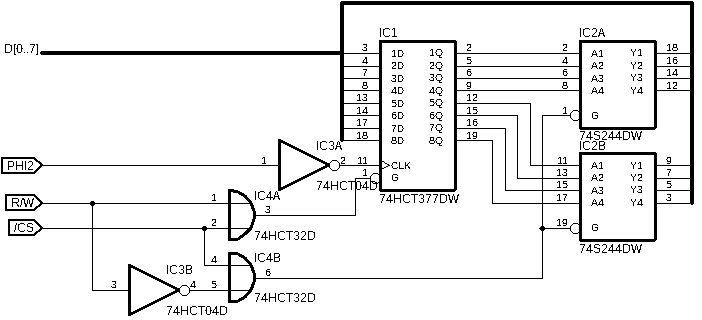

I think I've got the bus timings more or less right... and before I start building a small prototype for testing, (And who knows, maybe blow up my computer!) I'd like some advice from you experts.
To get the most basic test case, let's suppose I only have a 74377 8bit register (With a /E input, and positive edge triggered clock) to hold 1-byte value, and a 74244 tri-state buffer to output that same value to the data bus when requested. So, for this test circuit, I use PHI2, RW, /CS (Provided, in this case, by the C64 PLA) and the data bus as inputs. We can ignore the Address bus at the moment, as my little 8bit register will appear in the whole range this chip is selected by /CS.
Simple 8bit register
MOS6526 Bus Timing Diagram
I'm pretty confident about the "Write" portion of my schematic, although I have some doubts about inverting the PHI2 clock. I'm doing this as the 74377 write is triggered on a rising edge, but, the 6526 latches the input on the falling edge of phi2. By the time PHI2 falls, /CS, RW, and Data will be stable so, the positive edge of my inverted PHI2 will make the 74377 latch the value in the databus.
The "Read" portion also seems OK. When /CS is low, and RW is high, the 74244 will be enabled and its contents available in the databus, so the CPU can read the value at the falling edge of PHI2.

I first thought your work wouldn't work, but the 377 works a little different than a 374 so, yes, it should work if /CS isn't too late.
I think a 541 is a replacement for a 244 with a little more friendly pinning. Don't forgaet p1 of either 244 or 541 :)
Have fun!

Thanks! According to a 74HCT377 datasheet I intend to get, /E has to be low 18ns before the rising edge of the clock input. According to some timings I have for the C64... /CS and RW are setup for at least, 420ns, so plenty of time here..
Have fun!
Yep, you're right! Having 2 /OE pins on the 541 may save me a few logic gates. About p1... I spotted that after uploading the image :)

I just wanted to tell you, that last night I've implemented that small 8 bit memory, exactly as per the schematic, and it works like a charm. I can write an 8 bit value to it, and read it. I've connected it to the expansion port of my C64 so... it seems I've got it right :)

Yes, congratulations! Always a good feeling to set a goal and put what you've learned into practice.
Now is good time to look for possible refinements. You can eliminate one of the OR gates: the one that ensures /G of the '377 goes low only if /CS is low and /RW is low. Instead, it's alright to run /CS directly to /G of the '377. For the '377, /RW doesn't matter.
It may seem undesirable to allow the '377 to load even during a read cycle, but it's actually not a problem. That's because during reads the '244 will be driving existing data onto the bus. And reloading the existing data isn't a "problem" worth spending an OR gate to fix. :wink:

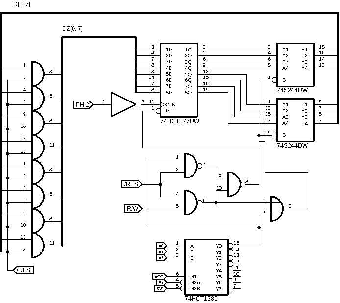

Right! Also... not blowing up my old C64!
Nice point. However, I'm not sure if I'll be able to save that OR gate in my final project. This was just a very basic test to check if I've got the bus timings and signals rights, but, in the end, reading and writing to a same register may not always return the same value. (I'm aiming to build a discrete logic 6526)
Now that I've managed to tap into the data bus... it's time to get into the address bus. Here's my next test.
8bit Register.. with address selector
I'm using A[0..3] along /CS (Connected to /I01 in the C64) with a 74138 so, my "address space" consist of 16 bytes, repeated along the whole I01 address space. ANDing the whole data bus with the reset line, will allow me to set the 377 register to all zeros whenever there's a reset. There may be better solutions for this (I'm sure there are!) but hey, I'm still in the Newbies sections of the forum :)
If this second test is successful, I'll start a new thread to track the progress of my 6526thing :lol: . Even though my main goal is to replace the 6526 in a C64, I also will test it with a modern 6502, to test how fast can I push it.

Not to confuse you, but:
74377 is a bit exotic, and you already have noticed that clearing all of the registers at RESET won't be fun when using 74377 based registers.
So I just wanted to toss in an alternative approach for using 74273 chips as registers:
Looking forward to watching your progress, good luck.

All ideas are welcome, I'm waaaay out of my area of expertise here.
I considered using 273 when I was starting with this... but I wasn't able to find an adequate logic to enable the register write. I will give your idea a try. It really feels it will save a few gates. Fortunately, right now I don't think I'll have an issue with board size.

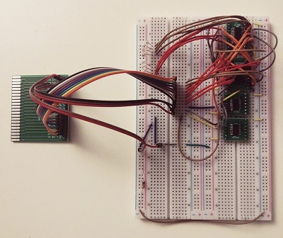

BTW, here's my first contraption :
I'm pretty proud of it... especially since I've also created the Expansion Port adapter, the SOIC to DIP adapters, soldered them myself (My first try at SMD soldering!) and it did work on the first run. Beginner's luck maybe?

Thanks for posting the picture.
Looks nice.
If you run into trouble with crosstalk between the wires in a ribbon cable when trying to run the design at a higher speed,
making every second wire GND (like with old floppy cables) will fix that problem.

Second circuitry worked ?
Congratulations: it's the concept of how we do register write control in our 20MHz TTL CPU.
Downside of that circuitry is, that the LD signals from the address decoder now have to be HIGH_active.
Adding 7404 inverters to the outputs of a 74138 would be an option.
Another option would be using the (slightly exotic) 74240 8 Bit inverting buffer instead of the 7404,
which would simplify the PCB layout, but from the datasheets 74240 seems to be a little bit slower than the 7404.
74238 is a decoder similar to 74138, except that it has HIGH_active outputs.
But that chip seems to be a bit... exotic.
