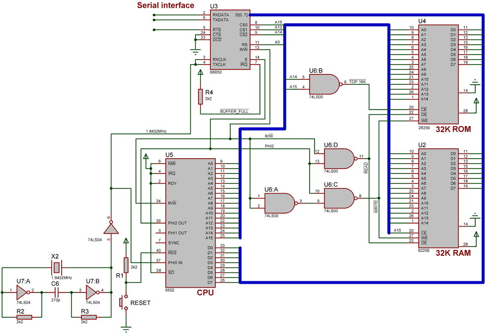

Hello, I'm new to working with the 6502 and I have a pretty shallow understanding of electrical engineering. I wanted to take the plunge because I figured that it would be a good (but apparently frustrating!) way to learn.
I based my design very heavily on Grant Searle's simple 6502. It looks like this:
The parts list is as follows:
CPU - W65C02S6TPG-14
ROM - AT28C256-15PU
RAM - AS6C62256-55PCN
ACIA - MC68B50CP
NAND Gates - SN74LS00N
Hex Inverter - SN74LS04N
Crystal - ECS-18-13-1X
The binary flashed to the EEPROM comes from Searle's Simple 6502 page. Given that it's a 16k image and I have 32k of space, I doubled up the image.
I'm using a CP2102 for UART to USB. I have not been able to get anything to appear in a terminal session. Screen immediately terminates and Putty hangs with a solid cursor.
I'm sure there's something wrong that's glaringly obvious but I am out of my depth here. Any advice would be greatly appreciate!

You probably have one or more simple things wrong, that will not take much to fix, but could be very hard to find. I guess this is basic debugging from here, establishing what we know does work and what we are not sure of. As a comment though, the serial communications is likely to be one of the hardest things to get going so it's probably best to verify some of the more basic capabilities first.
Since the serial port is the most likely culprit I'd start with trying some simple tests here. Firstly, try swaping TXD and RXD, just in case you have them around the wrong way. Also check the baud rate, the source code should tell you what this is set to, it'll also depend on the clock running correctly. Check baud, parity, stop bits and confirm that putty has the same values as the source code specifies. I'd also try a simple loopback test to confirm everything is working on the computer side. Just connect TXD to RXD from the CP2102, open up putty and start typing, it should echo your characters back.
I'd also recheck all the connections and make sure there are no wiring mistakes. If you have a multimeter check all the 5v and GND pins and make sure they are reading correctly.
We can probably assume that the code is fine, but it would pay to check that you have burned the ROM correctly (using a verify step on your programmer) and that the code is built for the same memory map that you have (specifically the address of the 68B50.
Often people start with verifying that the CPU is working correctly. Doing this depends a lot on what tools you have available. If you have a logic probe or an oscilloscope then the first place to start is verifying the the clock is working correctly. If you don't have something that can measure this then you can probably move on to the next step which will also confirm that the clock is working.
That next step is to confirm that the CPU is working. One way to do this is to reprogram the ROM with NOP instructions, this is hex EA. If you fill the ROM with EA's then the CPU will step through the addresses. We can check this by looking at the address pins, we should see A0 stepping twice as fast as A1 and so on, so A15 should be changing the slowest. Even a multimeter may give some useful information here? R/W should remain high at all times. You will need to modify the address decode for this to work, if you have built the circuit on a breadboard this should be quite simple, just pull up the CE pin on the RAM, pull down CE on the ROM, and pull up CS0 on the 68B50.
I just noticed you are using a WDC 65C02, this may be a problem as they don't recommend using PHI2 OUT (I think). Try using the clock signal directly instead of PHI2 in the address decode.
That's quite a bit to get started with, maybe it would be helpful if you let us know what testing tools you have, such as a multimeter, oscilloscope, logic probe etc.
Can you make sure you really got the desired image in the top half of ROM?

Computers have no sense of humor. One single connection made improperly can be fatal to it working.
Do you have this built up on a solderless breadboard?
Have you measured the Vcc at each device?
What are you doing with A15 on the EEPROM?
How do you have PUTTY set up?
Also, Grant is using the ACIA's interrupt to control /RTS to the host and you are using the ACIA's /RTS signal. I'm not that familiar with the 6850, but will this provide proper timing if the receive interrupt is enabled and being used for flow control? It seems that /RTS is configured via the CR6 and CR5 bit. If Grant's code is not setting those bits correctly then using ACIA's /RTS would not work.

Yes it's built on a breadboard. Correct me if I'm mistaken, but I don't think there's an A15 on my EEPROM :? Putty is set up as follows: 115200 baud, 8 bits, hardware handshake, no parity, 1 stop bit
As to your last point, I'll have to read up on the concepts here because I'm not familiar. Thanks for your help!

I don't understand why you didn't tie the ROM's A14 to ground so your SBC would use the lower 16k of ROM.
Also, You said you built it on a breadboard. Garth Wilson mentions the problems with capacitance and inductance using solderless breadboards for building a single board computer.

My bad. I mean A14. I see you may have it connected to A14 from the CPU. It should not matter, but I would have connected it to ground.
Looks good. The hardware handshake though means your /RTS needs to be working as expected. It may not be as you are taking the signal from a different place than intended by the designer.
Try connecting the ACIA's interrupt as /RTS rather than the ACIA's /RTS. Probably best to leave it there too.
