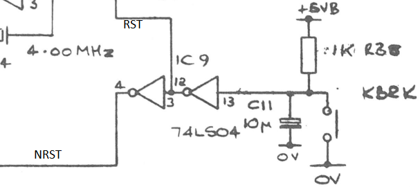

File comment: Reset circuit for Acorn Atom
RST goes only to the 8255, whereas NRST is fed to the 6502 and the expansion port. It seems that this may have been a design decision to buffer these lines as they went to the expansion bus, though on the Atom Phi2 and NRST are buffered but not R/NW, and on the System Phi2, NRDS and NWDS are buffered, but not NRST.
Here (below) is a setup you might consider. I suppose if the jumper were 3-way then you'd have the double-inverter option, too.

The case of reset is rather more solid: to get reliable reset you need a good edge, so the RC circuit alone can't do that. So that explains one logic gate. And then, if you have chips which need a positive-sense reset, and others which need the opposite, you need an inverter, which justifies a second gate.

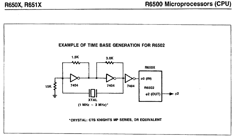

Looking at the 6502 data sheets over in the documents section, the MOS/Commodore 1976 version gives three different example clock circuits (series crystal, parallel crystal and RC) which are similar the System 1's layout: bridging Phi0in and Phi2out, with an extra inverter to give the system clock. By comparison, the Rockwell 1987 version gives the same clock circuit as Garth, with two inverters on the Phi0in size and the Phi2out completely independent.
Acorn were using MOS chips (the prototype was built with a white ceramic MOS 6502) so it seems very likely that they worked from the datasheet's circuit for their prototype and System boards. For the Atom they may then have left the double inverter in "just in case".
I wonder why Rockwell would have suggested a different circuit: did they make any changes to their NMOS 6502 design?

As to the Phi2 clock, many microprocessor manufacturers strongly recommended that ALL outputs from the microprocessor should be buffered. Although the 74xx04 does not have "buffer" type outputs, in terms of cost, if some of the gates were already required elsewhere, it's cheaper and easier to use it to buffer the Phi2 clock (than adding a extra chip). Buffering is especially important for signals that control critical functions where the signal is routed all over the place, or where it goes off board to any kind of bus. Long signal lines degrade the edges, buffering provides extra drive current and maybe faster edges, which helps a lot with the signal integrity.
Having come up with a design (that works), you will often find that same design in later versions and later machines. Even if some features may no longer be needed. As most people/companies don't feel the need to reinvent the wheel.
And finally, if a manufacturer shows a suggested design in a data sheet, the safest way, is to use the same design (or a close variation of it) in the design of the device that you are making.
Crystal oscillators using logic gates back then, was one of those areas of electronics that was known in some circles as a "black art" (hard to understand, so left to the people who were 'good' at it). So data sheet designs would often be copied.
