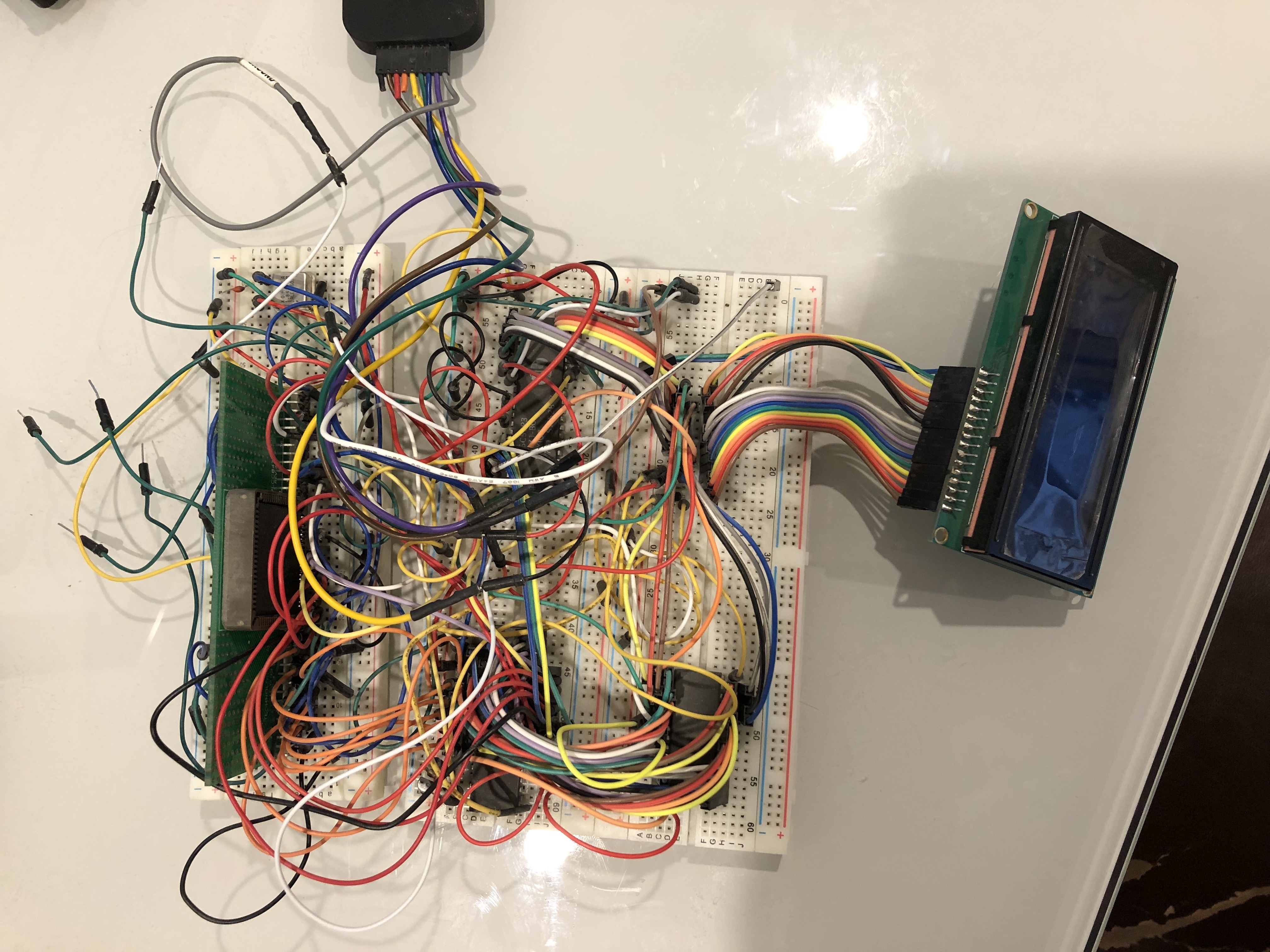

I started out by building a 65C02 breadboard system with a 65C52 for serial communications. I probably couldn't have gotten it going without the advice from here, but looking at it now I appear to have ignored quite a bit of advice too, and I'm amazed that it actually works. I used an ATF1508AS (similar to what BDD uses for his POCV2), and included the ROM in there (very limited, I was continually running out of space, but it was enough to test it out and easy to reprogram). I ran the whole thing at 1.8MHz and fed that clock into the 65C52 so that it ran at 115,200 serial speed, on a very messy breadboard and with no bypass capacitors. So you don't have to do things perfectly to make it work. Still, looking back I'm amazed that it did work. I never posted a photo of this project as it's probably the messiest breadboard ever seen on this forum. Some others are very tidy but I used jumper wires for everything so it looks a real mess. Take a look:
File comment: First breadboard 65C02

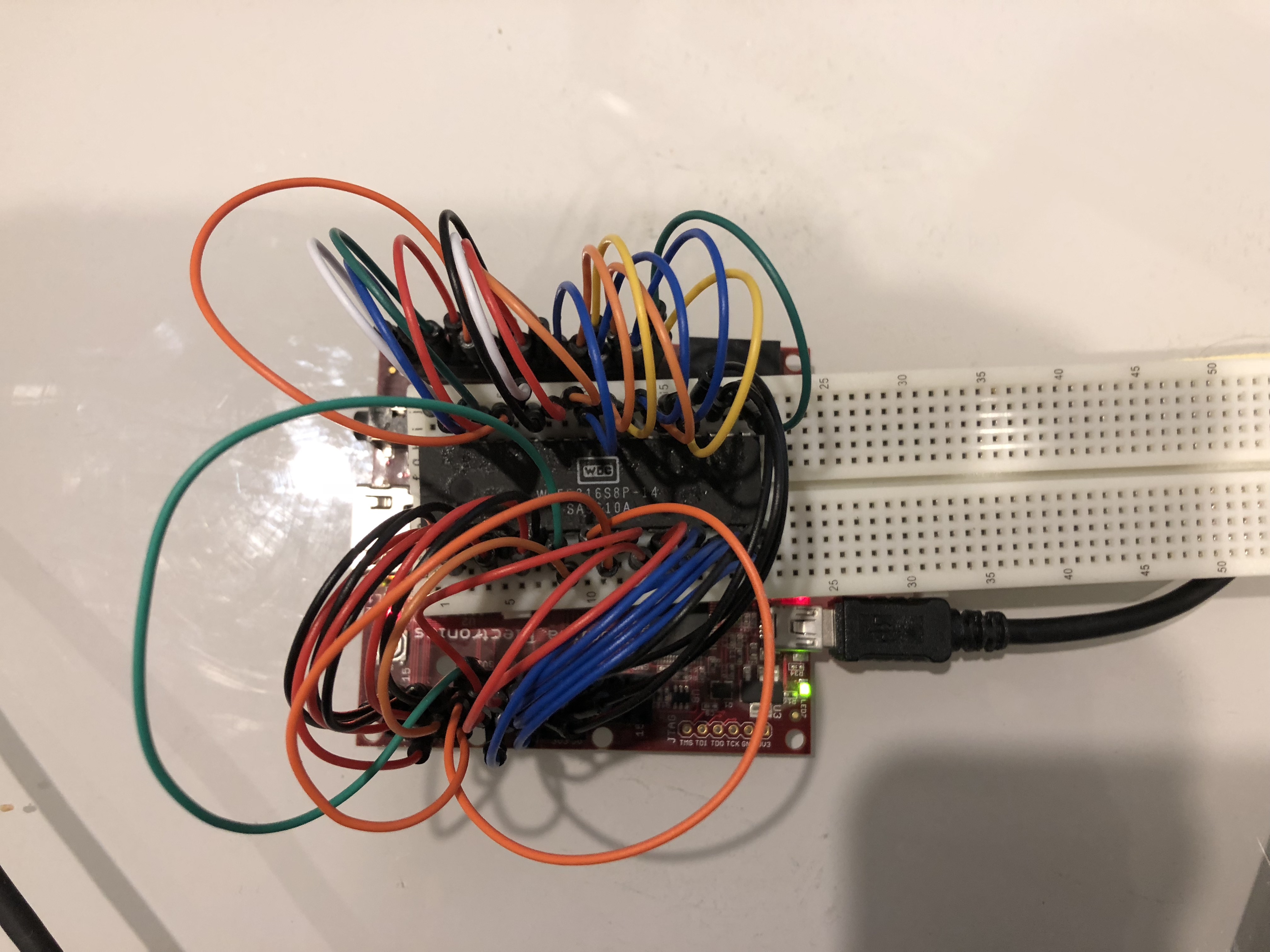

My next step, which may be something you want to try, was to directly hook a 65815 up to a FPGA. I did this with a pipistrello board, but it should be an easy conversion to your Mojo board if there is enough IO available. The FPGA code (in verilog) was based on Arlet's 65C02 sandbox project. I've implemented 4k block RAM, block ROM containing OSI Basic, and a simple 6850 serial emulation so that the basic runs through the serial port. This is connected through the pipistrello UART-USB chip so it can be programmed and used with the one cable. You might want to try building this yourself as I think you have all the parts available. I've been meaning to write up the project and publish the code but haven't had time for that yet.
Attached is a photo, it's just connected with jumper wires and was quite quick to assemble. The 65C816 is running at a little over 4MHz (it was an easy divisor) and 3.3v. There should be a pullup resistor on the RDY line, that's the only other component required.
File comment: 65C816 connected to FPGA and running OSI Basic
My next step is to make it load the ROM from the unused space in the SPI FLASH and copy that into RAM before boot. Also it's not making use of any more than 64k at the moment, I'm working on getting the Pipistrello LPDDR RAM working, then it'll have a full 16MB address range of RAM available.
