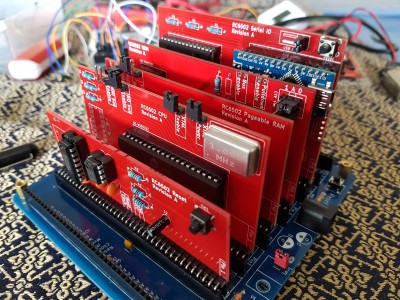

Hoping anyone can point me in right direction since I'm stuck, completely stuck and I'm not sure what else to try at this point. Have been hard at work drawing out designs based on the Apple 1 Replica Creation book, so hopefully the errors made are of the patchable kind. I'm using an Arduino Nano to talk to the computer via an MC6821 chip. CPU used is UM6502A, HM62256LP-10, AT28C256 EEPROM with Basic and Woz Monitor installed - logic chips used originally were 74LS, but switched to 74HCT series to see if that made a difference. Not sure what other information to include, code and schematics on github (https://github.com/tebl/RC6502) - Arduino code in the serial folder.
When I connect to the serial monitor on the Nano and then hit the reset on the computer I can see that I receive a single '\' from the computer, and as far as I know that should mean that the monitor starts running. Problem is, I can't seem to receive anything else from it. Also varied or-ing the character sent out to ensure that bit 7 is high (also did a version where I tied it high like other designs do). Seems so close :cry:
Any ideas, or even just a nod that the Arduino code seems somewhat sane?

Eureka! I found the error, after spending a lot of hours of checking every tiny bit of code, checking everything out using the DSO and programmed a new Arduino sketch in order to sniff out what was going out over the buses. Given that sync toggled as described, clock ticking and R/W alternating here and there - except that what I was seeing just seemed like a random mess. Didn't even see the \ being transferred even though I knew it was going over the wire. Even built various versions of the clock with dividers and stuff since it looked all wavy and not square at all.
Problem was... I mislabeled the RAM adressing pin so that it was set to respond to upper 32K instead of lower, meaning that most of the time the first few cycles worked and after that it was just reading garbage all over the place. That's what you get for not double-checking what you put on the silkscreen :oops:
Thanks for all the help guys, attached a picture of the computer now that it's in a somewhat working condition. Guess I'll have to do more 6502-based projects since I ordered a lot of stuff yesterday, in case a W65c02 or a W65c21N would make a difference :idea:
Still have a lot of stuff to do though, I made a huge mess of the power separation on the serial card. Hmm... maybe make a SBC-version of it now that it works :D

Nice-looking system too. Seems to be a lot going on there - five boards?

Yep, it's a lot for a system that does almost nothing at all. I originally bought the Z80-based RC2014-computer and spent a lot of time dissecting it's inner workings, and like the creator of that system I found that doing a lot of things made it a lot harder to debug so separated out most functions so that one board only does one thing. Did not end up reusing other components than the backplane for this project, but it's all pluggable so can mix and match to my hearts content (or rebuild the original). Want to doing something with a 6507-CPU, just use a different CPU board :D
