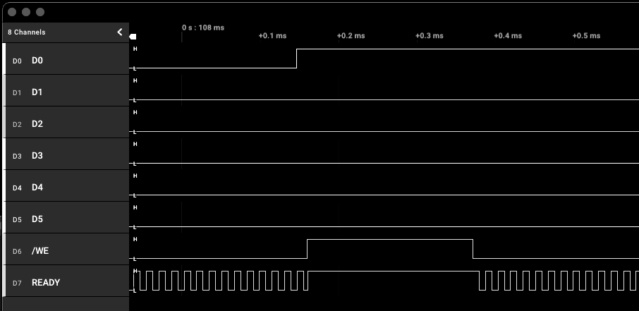

Tagging onto this thread in hopes of also getting the SN76489 working. I've got mine connected to a VIA, and while ignoring the ready pin, I've managed to get it muted, then produce a sound! Now that it's working, I wanted to try and do it the "right" way and read the ready pin. I've got it tied high with 2x1k ohm resistors in series. When I look at the pin with my LA, it looks like its just cycling continually, and it pauses when I have /WE high. I thought READY should remain low until the IC is doing something, and read high while its busy, then go low when it's ready to do something new. Am I missing something?
When I measure this pin on my scope, it reads as 62.50kHz
(D6 is /WE, D7 is READY)

ok.. I have made some progress. I was treating /WE as active high, not active low. once I changed that, I got a different behavior from the ready pin. not working still, but think i'm on the right track. (and time to read the data sheet again)
Better check, as that doesn't quite seem to add up. If READY behaves as you say then I'd expect the signal to be named /READY (or perhaps READY#), indicating active low. See what the data sheet has to say regarding this point. :)
The READY signal goes low while the chip is loading in the data. The /CE and /WE pins need to be held low for that period of time too. That's why I used the READY pin to keep them low until it has loaded the data.
