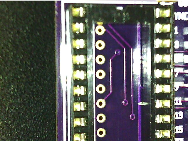

I'm currently trying to bring up my first system using (mostly) period-correct parts.
I had a problem where the system would work correctly if PHI2 was 1 Hz or slower (single-stepping) however when PHI2 was any faster (even 10 Hz) I was seeing $ff on the data bus when there should have been other values whenever NVRAM was being read. I have some very weak pull-ups on the data bus so I suspect that it wasn't being driven when the NVRAM was selected. After some head scratching I noticed this:
The socket pin seventh down on the right hand side was bent when it was inserted in to the PCB for soldering.
That pin is /OE for the NVRAM and was supposed to wired to GND. The NVRAM was being programmed at 115,200 baud without issue but could only be read very sedately. After I patched that up, it worked just fine at 1 MHz.

It seems to me that some force would have been necessary to get that IC into place while folding over that pin. If the pins are straight the IC should slip right in the holes during assembly, using very little force. As alluded by Jeff, better to be meticulous during assembly and not have to endure the indignity of a lengthy pin-by-pin test looking for bad connections.

In many cases you can see under the IC, between the IC and the socket, from the edge of the board, to inspect for that kind of thing. It's also good to look at every pin from the top and make sure you can see where it goes into its place in the socket. I'm always super careful about that kind of thing, because I hate troubleshooting and fixing hardware! (And as a result, I very seldom have to.)

I wonder that you haven't noticed that missing pin during soldering. Or was it done by wave soldering?
When production rejects went back to engineering (and before SMT becomes regular) I used to took an edge look to the solder side across the pins, looking for irregularities. Next was pulling out all plugged ICs to look for bent pins AND (in case of "precision" sockets) to look if the socket were fully equipped with pins and these tiny golden contact inserts!
