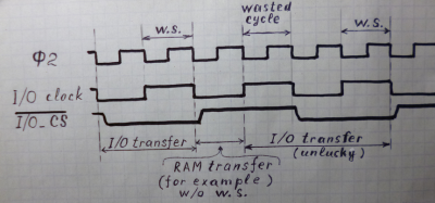

I had some thinking of the problem described by Jeff. Supposing we have an I/O device that requires 1 w.s. and we want apply to the Ф2 input of the I/O chip the reduced clock frequency, say Ф2/2, i.e. MPU clock divided by two. The I/O chip is glad, the frequency is in permissible range, low freq. is not an obstacle for work. MPU has problems: not every MPU cycle is suitable to initiate the I/O data transfer. The data transfer with 1 w.s. require two MPU cycles. A successful case is when between the MPU cycles occurs rising edge on the Ф2 input of I/O/ chip. Unlucky cycle must be wasted (may be, the W.S.Generator must insert one extra w.s.). Than all occurs as usually, there is regular data transfer with 1 w.s. Right? In such a system, W.S.G. must track odd and even MPU cycles to skip unlucky ones.
Vladimir
Edit: attached diagram and an amendment:
I wrote above: "may be, the W.S.Generator must insert one extra w.s."
I made a mistake. It can not just be extra w.s. May be Ф2 on MPU must be stopped for one cycle, since MPU must not assert the address and must do nothing during wasted cycle.

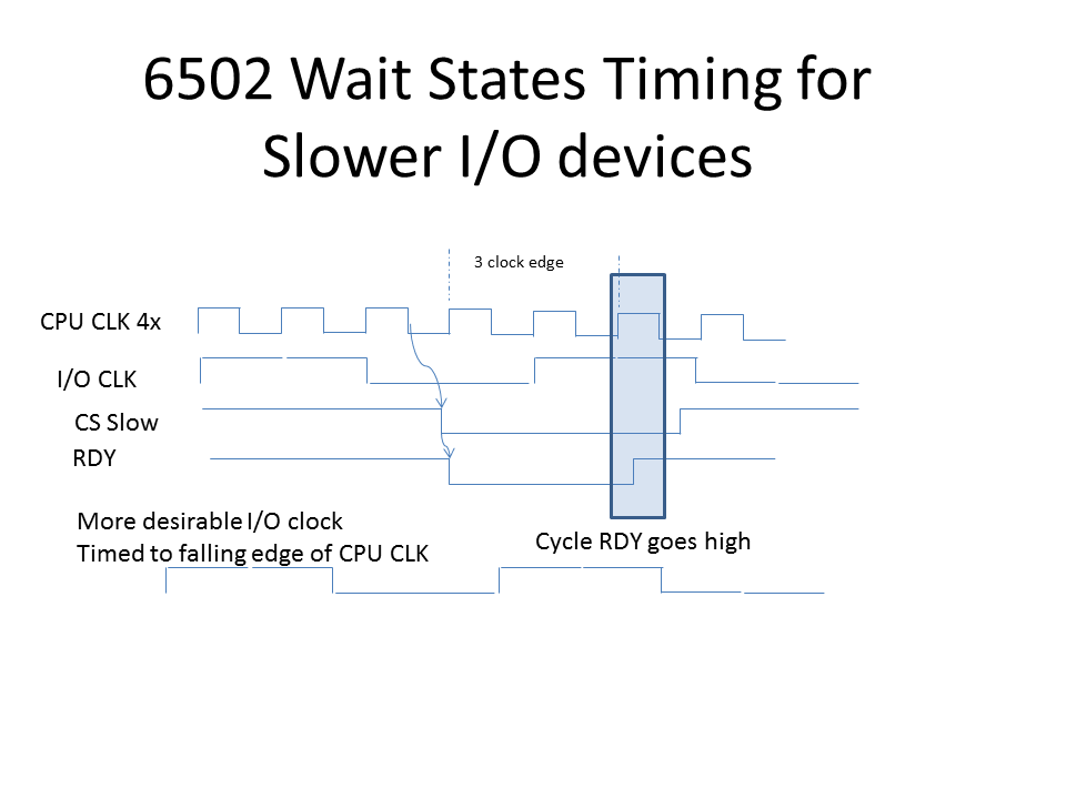

Drawing a timing diagram might help. It would look something like the attached.
The RDY line has to be driven low as soon as the chip select detects a slow I/O area. Then it has to be driven high again on the CPU cycle just before the end of the slower I/O clock. Finding the CPU cycle just before the I/O cycle ends can be done with a shift register that begin shifting on the first edge of the I/O clock.
One thing to note is that it’s desirable to drive the slow I/O clock from the negative edge of the CPU clock so that the falling edges of the I/O clock and CPU clock are synchronized.
An low going edge detector could reset a shift register which shifts out RDY for the I/O. The third tap of the shift register would be used. (The input of the shift register is tied high).
A 74AC164? plus a FF and a low going edge pulse generator (RC network) should just about do it.

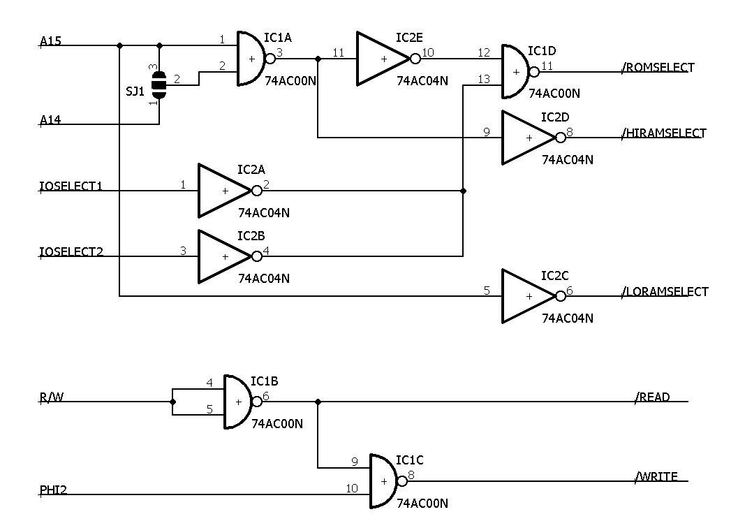

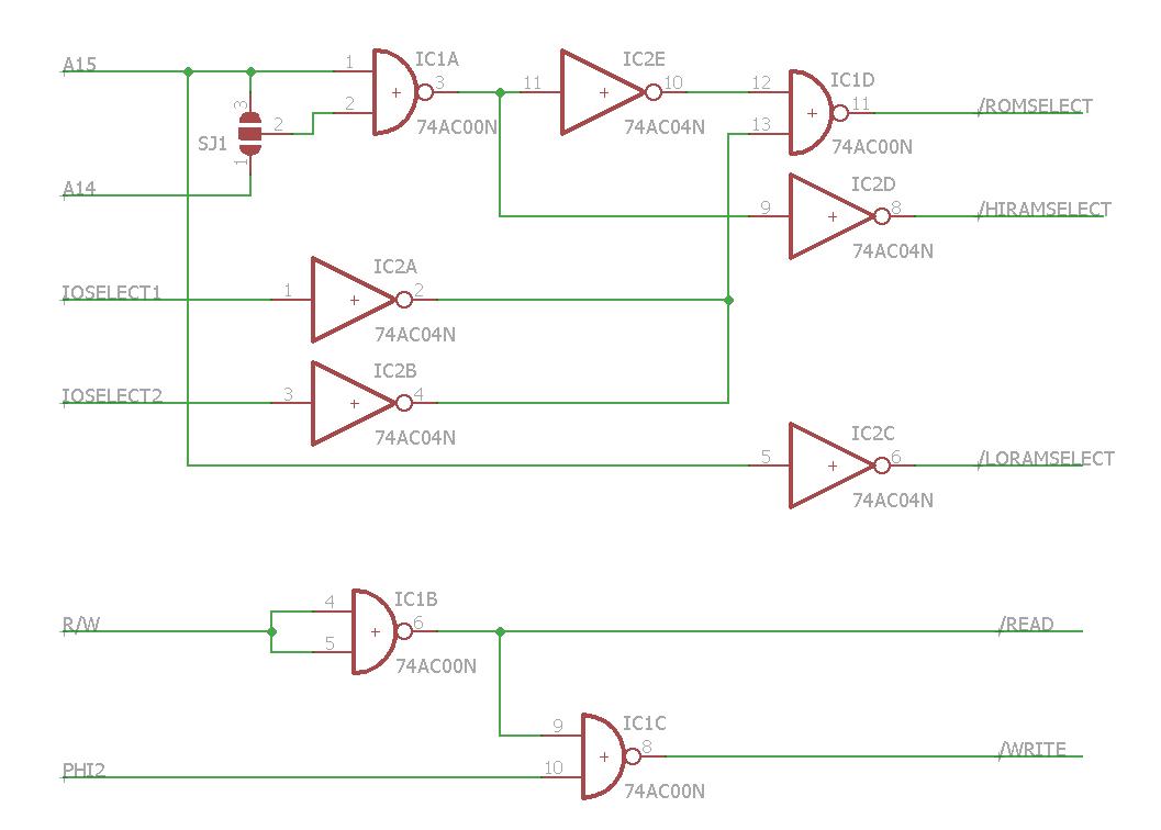

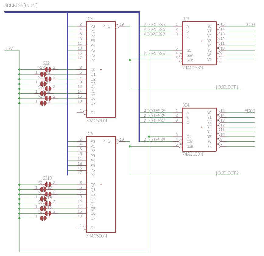

Hi All,
Knocked up the memory map decoding schematic, What do you all think ?
Using the 521 not the 520 in the schematic......
The jumper is obviously to select 16 or 32k ROM ...
Welcome your comments :D
Lee

Please post your schematics in monochrome for easier reading by us old dinosaurs. :D

Apologies...... Mono
lee :D
