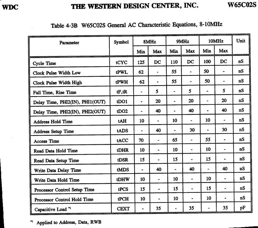

All WDC datasheets that I've seen say, W65c02S is a 14 MHz device. I would never known about the 10 MHz version, but I had bought it. I believe that AC characteristics should also be different, but how to get them? Does anyone have this information?

Are you looking for the timing specifications for an older 10MHz version? I don't have those; but the current (14MHz+) data sheets are on the manufacturer's website, at http://westerndesigncenter.com/wdc/documentation.cfm .

In anothter topic (viewtopic.php?t=511) I read:
Doggone, you're right! I never noticed that. It definitely is an error, and I expect it crept in because of the 65816 which has no phase-2 output. It wouldn't be the first time someone found an error in their WDC's diagrams and spec.s. Which data sheet did you look at? On my older one, it has a delay of up to 40ns from phase-2 input to phase-2 output even for the 10MHz part, and then they reference everything to the input; but 40ns is almost as long as the clock is either high or low, so obviously that won't fly. I looked at a newer data sheet though, and it was fixed.
The phase-2 input and phase-1 output seem to be primarily intended for hanging a crystal or an RC right on the processor itself so an external oscillator is not always needed. It wouldn't make sense to connect the actual processor's innards to the phase-2 input since that one is a Schmitt-trigger input specifically so it can handle the slowly ramping voltage you'd get from a capacitor and resistor connected directly for using the onboard oscillator.
What do you mean by saying 'On my older one...' ?
I found it. I was forgetting I had a 1992 data sheet on paper. I'm attaching the timings page.

Thank you Garth, this is just what I need... :D
