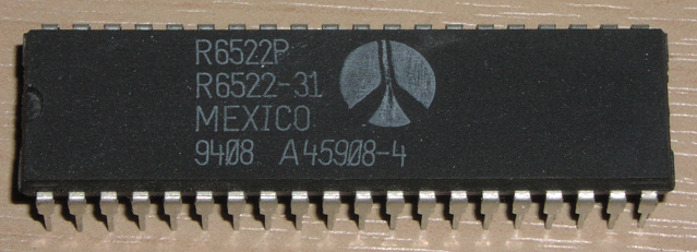

Isn't that designation used for 1-MHz parts like the R6522P pictured below?

My old dinosaur brain seems to be telling me that the absence of a speed designator means it's a 1 MHz part.

To Michael: Maybe. But, how did you know that it is 1 MHz? Your marking tells me nothing...

IIRC the first versions of the parts were all 1MHz. So no special speed designation was necessary. When the faster parts became available it became necessary to add the number, e.g. P2, P4 etc. And 1MHz parts produced after that point would be P1. You'll sometimes see the same thing happening in various other fields, not just for chips.

I think it's a P1 part and the digit has wrapped round to the next line where it's followed by the date code for the packaging process (1450) which is was around six months after the silicon was made (1423).
The logo limits the length of the first three text lines. Look at the 6522 photo.

I have no other 65c22 for comparison, but there is four R65C51P2.
An analysis of their marking does not confirm your guess.
The marking is as follows:
1-st:
R65C51P2
11470-14
MEXICO
9237 A23618-4
2-nd:
R65C51P2
11470-14
MEXICO
9415 A37995-3
3-rd:
R65C51P2
11470-14
MEXICO
9525 S10102-2
4-th:
R65C51P2
11470-14
PHILIPPINES
9649 B25846.2
The line 11470-14 is an essential own of this chip. This is not a date.
Apparently , it is necessary to perform an experiment, to test frequency characteristics of my 65C22.
