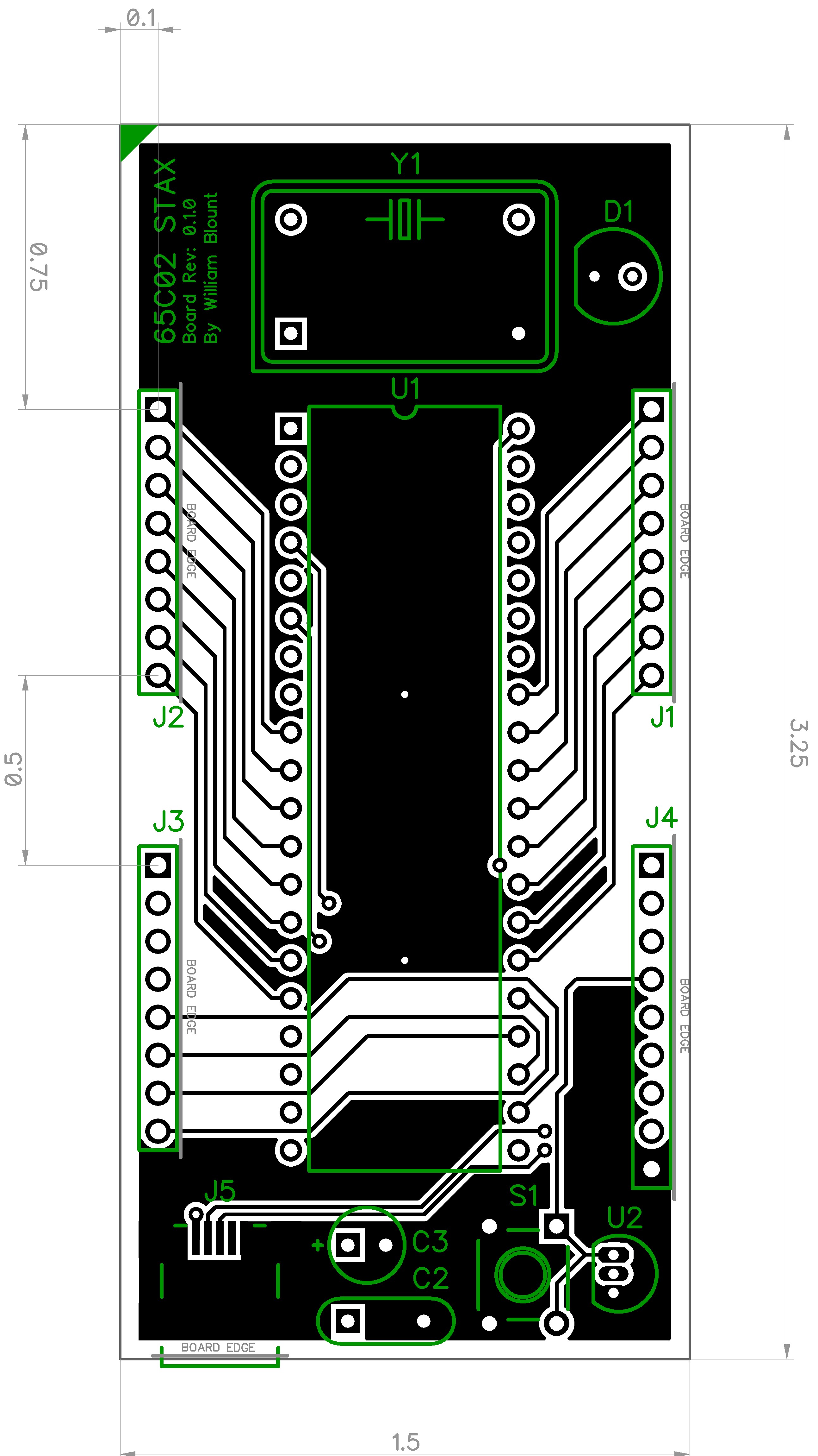

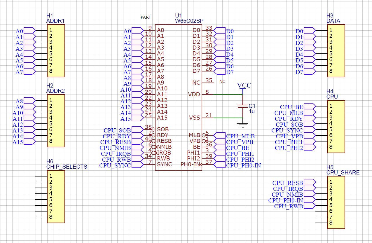

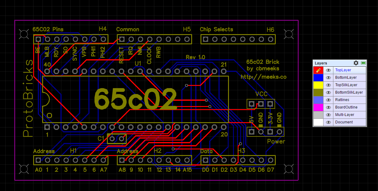

I've had the idea for a side project for quite some time. It's nothing new but I've wanted to prototype 65c02 computers as easily as the Arduino folks do with their shields.
My idea was to build modules (or "bricks") that would have common lines in the same place for each brick.
For example, the address bus, data bus, etc. would be in the same spot. Other bricks that use those buses would have the same headers in the same spot. So a 65c22, for example, would have the 8 data pins in the same spot. Four address pins (A0:A3) in the same spot, etc.
Now certain pins that are specific to the 65C02 and not useful for other bricks would be in their own section. Not connected to anything but a header for experiments. Of course, a custom brick could be made to use those pins as needed.
Finally, a section for chip selects is off to the side and not connected to the CPU. I haven't figured out how I would do this yet. But I'm thinking of several different "glue" bricks that would tie an address line and a line from a mux, etc. into a chip select. Or a glue brick could be a CPLD that ties all of the chip selects into address lines or where ever.
A ROM brick would tie into address pins, data pins, RW, etc. But again, the "magic" would be with the glue bricks.
At the very least, I would have a small board with a 65c02 ready to plug in with fewer wires.
Your thoughts are welcomed. I would love your opinions.
I used the EasyEDA to design my board. This is the first board I've ever designed so I'm sure I've made mistakes.
One thing missing is an on-board clock. I realize I forgot that. I have a pin for an external clock. I could use some ideas for that too. Perhaps having an on-board clock would be ideal. But keep in mind I'm not designing for speed. 1-4 Mhz tops.
Also, notice there is a jumper for the power source. I thought it would be nice if each board could select between 3.3v and 5v. All they would have to do is put a jumper on VCC. Of course, level shifters would be required on modules of different voltages.
https://easyeda.com/editor#id=u41trXf9qI
Just a quick note before I close up for the night. The two output clocks of the 65C02 should not be used for anything. WDC recommends that all timing be from the clock generator that is driving the MPU. WDC neither tests or guarantees timing between PHI2 (pin 37) and the PHI1O (pin 3) and PHI2O (pin 39) outputs, which will lag PHI2 by an unspecified amount.
Also, in the interest of reducing the footprint of the MPU, I suggest that you use the PLCC-44 version, not the PDIP-40. Aside from some space savings and potentially easier circuit routing, the PLCC-44 package has two VSS connections, which will help with minimizing ground bounce problems.

I've been giving this some thought for a possible future project based on the rc2014.
I'm thinking of putting some 74HC138 decoders on the motherboard and distributing them to the sub-boards (what you call bricks). Each brick would get (let's say) 16 pins from the address decoders on the motherboard (8 from each decoder). One address decoder is on A14-A12 and one address decoder is on A11-A9. Then, on the board, a few dip switches or jumpers (or a combination) can be used to set the address for the chip on the module, possibly in combination with one or two more TTL chips like a 74LS00.
Another option is to use one or two 74HC688 (8-bit comparator) on the module in combination with some jumpers. You would connect one side of the comparator(s) to the significant part of the address bus, and the other side to the combination of 0's and 1's you need to check for. With a smart jumper system, you can adjust the number of "insignificant pins" by connecting the "fixed side" of some comparators to the address bus.

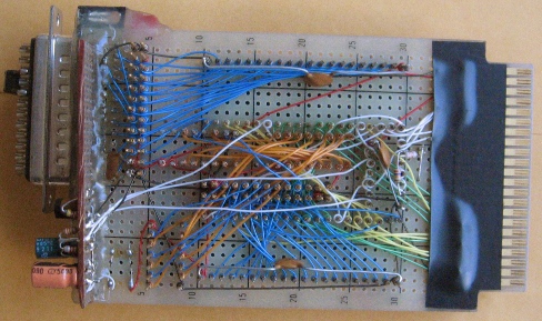

Vector (and maybe other companies) used to supply 44-contact prototyping boards that plug into the Commodore 64, like this one I built some extra I/O onto:
It shows up approximately actual size on my monitor. A card cage of those would be really compact and cute.

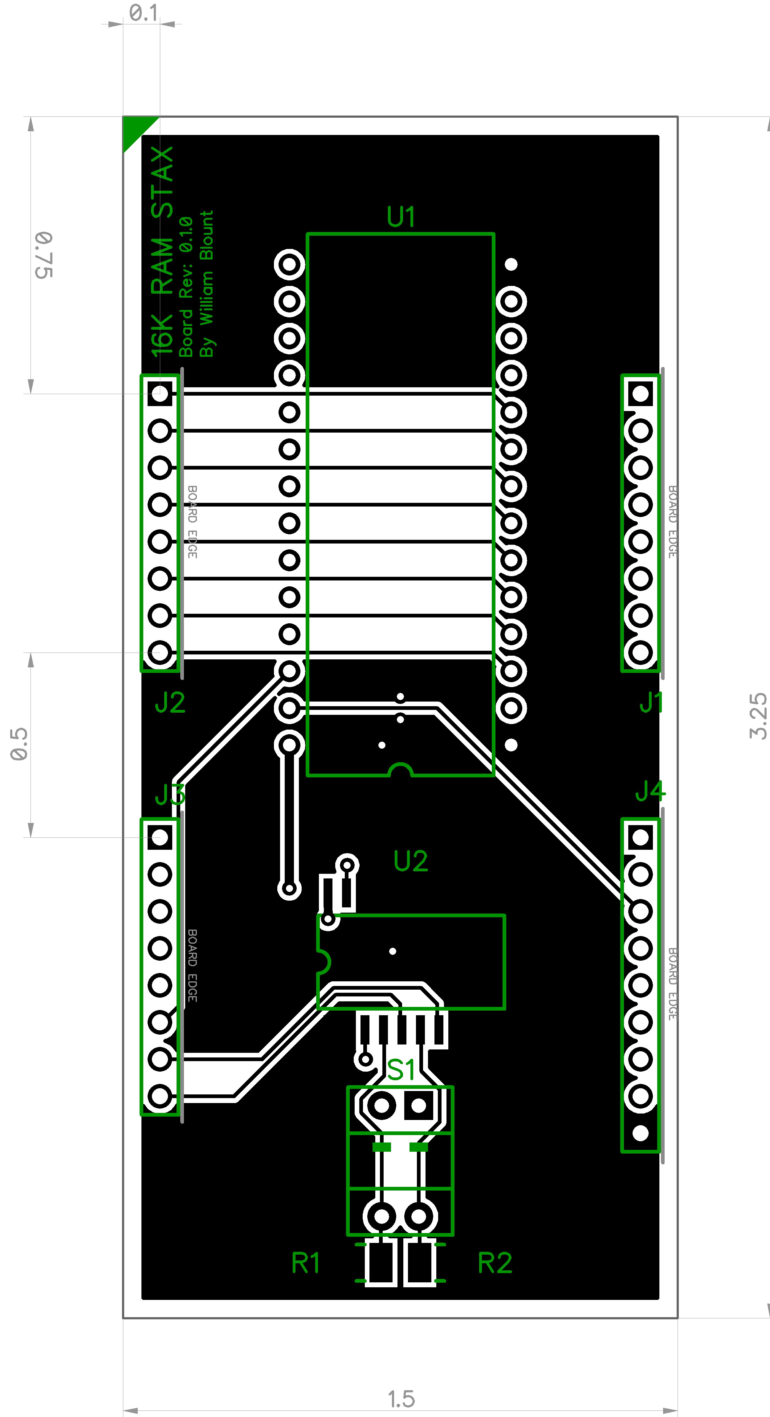

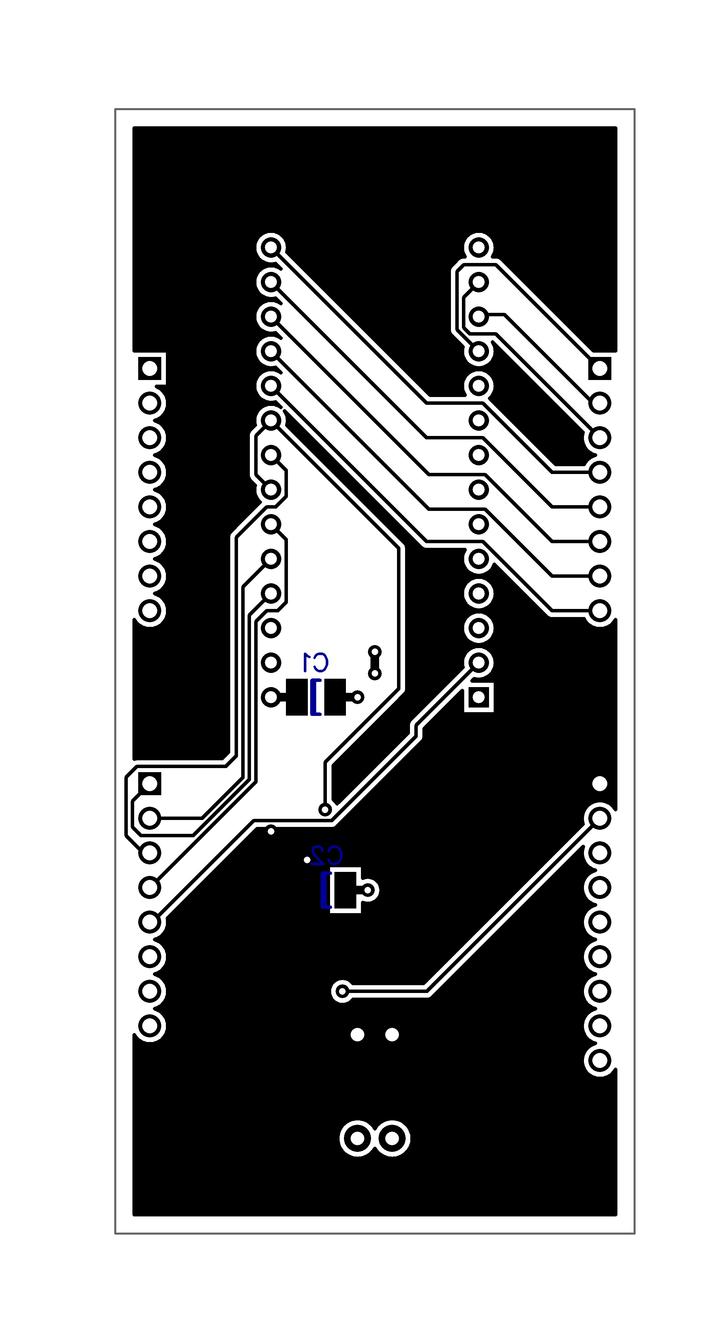

I played around with such a design prior to designing my SBC. It certainly is not the most cost effective design, but it has the advantage of being fully modular.
Here are a few pics of my take on such a system.
CPU:
RAM / ROM:
Isometric Rendering:
- Billy

Continued due to max attachments...
The system has headers for the data, address, and other 6502 bus lines as well as connections to the rx and tx pins of the USB connector (could be used by a serial board).
- Billy
