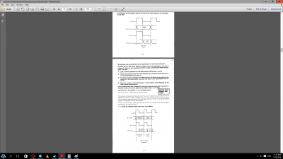

I'm a complete beginner and have started reading "An Introduction To Microcomputers" by Adam Osborne. I'm failing to understand the diagram in the attachment below.

I believe that's a book that I had and loaned out but never got back. I was hoping to be able to see what microprocessor it's talking about there. It is certainly not the 6502 which works a bit differently. The '02 starts each cycle with Φ2 low, not high, and ends the cycle with it high. When it's reading, the data is latched in on the falling edge of Φ2. Instead of a read\ line and a write\ line, the 6502 has a R/W\ line. (The trailing bar is supposed to be horizontal and go over the top of the "W", but there's no way to show it that way in the forum text. You pronounce it "read, write-not.") The address and R/W\ come out soon after the beginning of the Φ2-low time. There is time to set up memory or peripherals before the rising Φ2 edge which signals the actual read or write time. In the case of writing, you must ensure that no writing can be done while Φ2 is low, since that would require that the address be guaranteed to be valid and stable well before R/W\ goes down, which is not the case, and you could inadvertently corrupt other addresses on the way.

What your describing, is that for the 6502 or for the what the diagram is showing? As far as the diagram goes, I'm not understanding why the criss-cros.

My amateur opinion: I think that the criss-crosses indicate potential transitions, and the areas between the horizontal lines indicate stable binary states. The idea is to show that there are potential instabilities near the clock edges, so any bus sampling performed during those criss-cross periods may be unreliable.

Crossed lines in a diagram like this is meant to show the points at which data changes, or in this case, the point at which data, having potentially changed, is now valid and stable.
Another convention is to use a series of crossed lines, or cross-hatching, to the left of the period of stability to show that the data could be changing during that time.

It's a graph of the signals, with time in the X axis and logic state in the Y for each signal. The fact is that the signals take a little time to transition from high to low and vice-versa, typically a few ns for the ICs we deal with here. There is a transition time in which the pin is not in a valid logic state. This is true of any processor, not just the '02.
