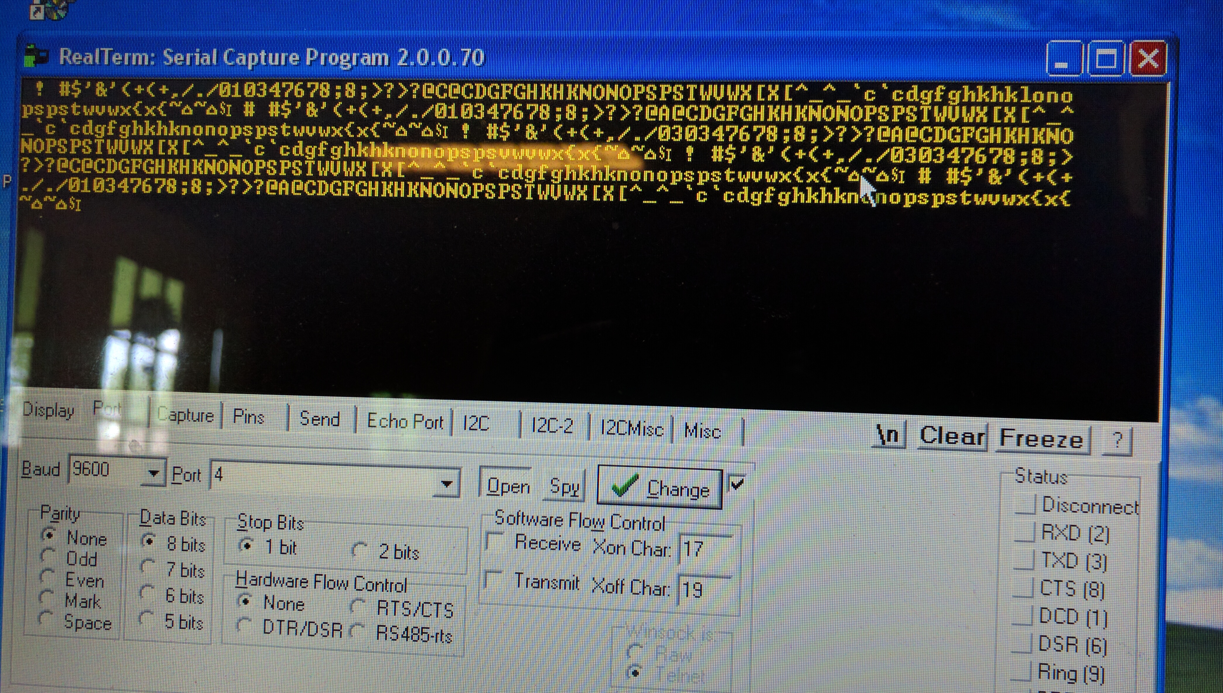

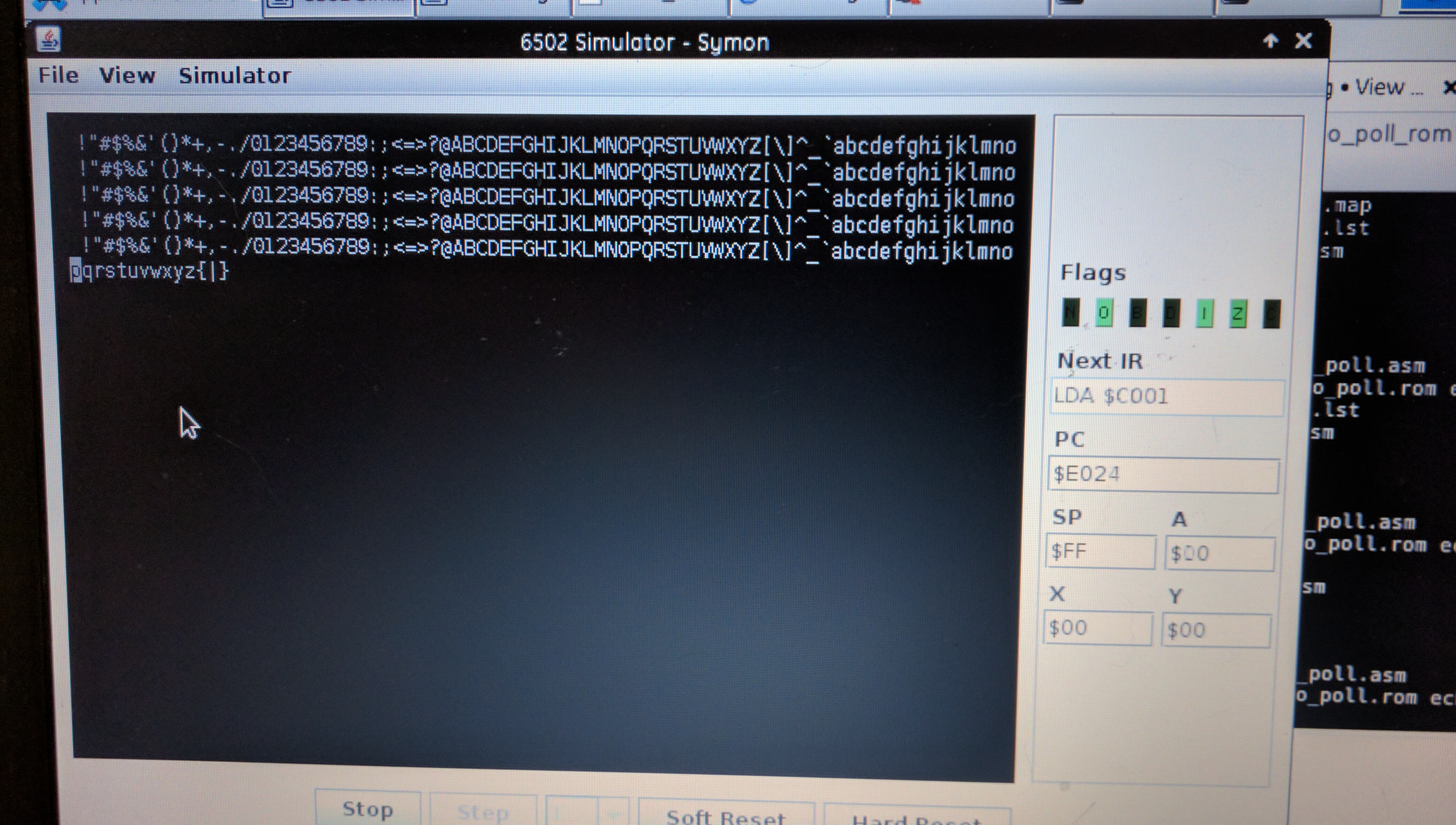

I'm having some serial issues, and I'm not quite sure where to go with it.
I've attached two pictures -- one expected output, and one actual output. I've tried changing baud rates and from a WDC 65c51 to a Rockwell 65C51, and both exhibit the same behavior. I don't have another MAX233 to try, but one is on order.
What is really strange is that after the initial patterns, I can type and hold down keys on the keyboard and I get no errors whatsoever. Its almost like it needs a few seconds to get ready...
Pressing the reset button produces the same output. If there were serial errors, I would have expected different output each time.
Has anyone seen something like this before?

File comment: The somewhat garbled output
File comment: The expected output
PostPosted: Fri Apr 29, 2016 7:34 pm
Oddly enough it looks more like a parallel issue - it looks like bit 1 is unreliable. The sequence
012345678
is mutating to
030347678
and that's always a flip of bit 1. Similarly for the alphabets.
Is the databus side of the socket for your serial chip well-connected?
(What kind of computer are you running? What kind of construction technique?)
PostPosted: Fri Apr 29, 2016 7:42 pm
Joined: Wed Apr 02, 2003 9:18 pm
Posts: 33
Ed,
Its all on a breadboard...and all run through a single 1.8MHz oscillator. It sounds like you are saying that D0 might be bad?
PostPosted: Fri Apr 29, 2016 7:44 pm
It's almost like D1 (which is bad) is getting the value of D0.
Edit: but not exactly that. Some of the sequences are coming out slightly different from each other.
PostPosted: Fri Apr 29, 2016 8:27 pm
Posts: 33
Ed, you're a genius! I replaced D0 and D1 and it works a charm :) Thanks!
