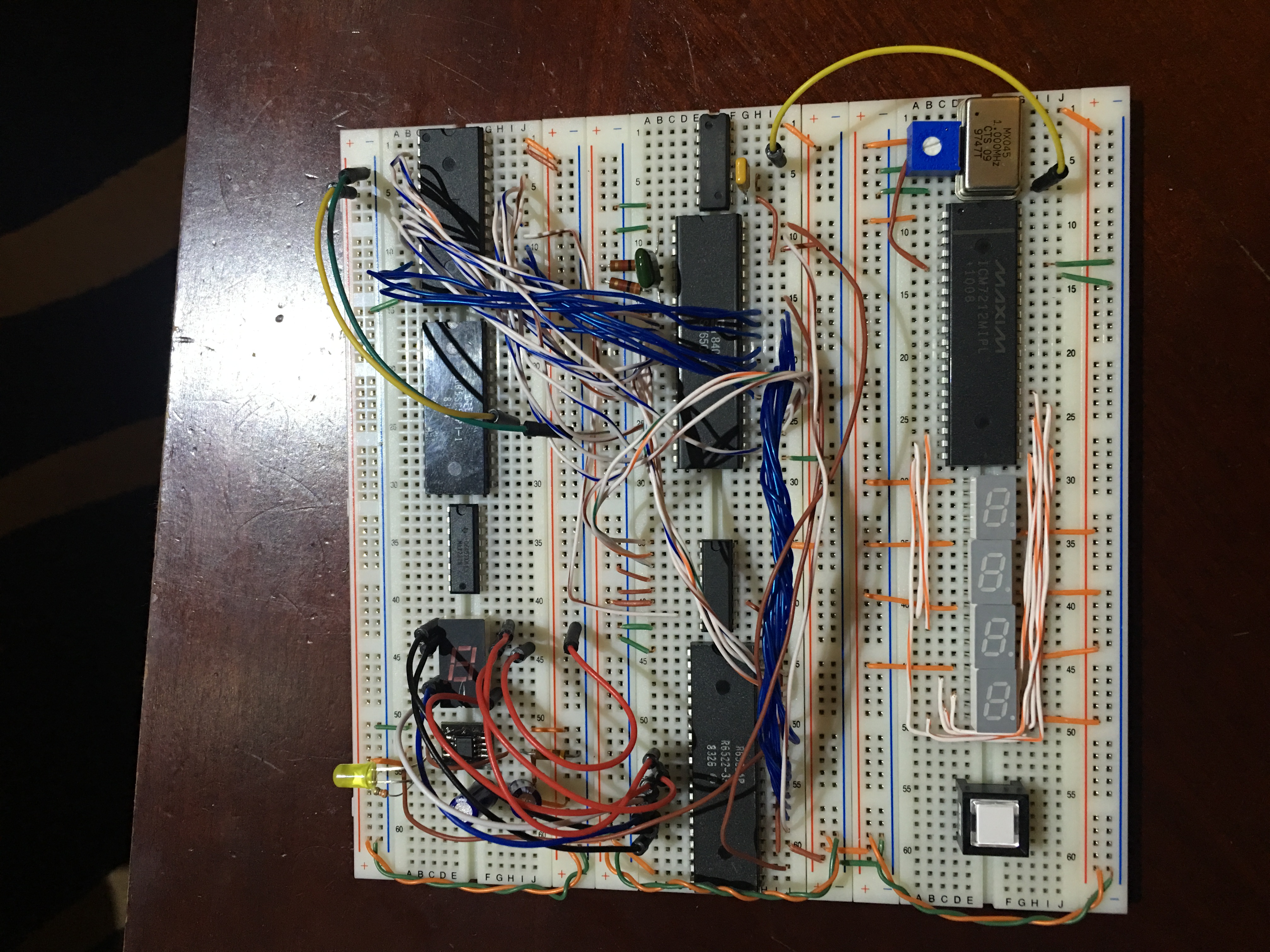

Hello all I am new to the 6502 world. I just started building my own SY6502 system. So far I have the SY6502 running at 2MHz with an SY6522 wired up on a bread board. I also wired up an 28HC64 EEPROM. Still working on the RAM (waiting on another breadboard to show up. I have also started to wire up the 6551 and some 7-segment displays.
I already tested the 6522 with producing a frequency at PB7 and some basic on off stuff on port B.
One issue I am running into is with the BNE instruction. I am trying to make a simple delay program to display 1-9 on a single 7-segment display attached to port B but it seems like it's getting stuck at the first point.
File comment: Code
File comment: Pic of the board

Maybe that LDA $50 at Next: should be LDX $50 ??

Update I programmed the ROM with a lot of NOP codes in place of the jumps commands to just retest to make sure it is not an hardware issue and I got it to change the display. So I think it may be something todo with my jump code that is causing the issue but just can't figure out what it is.

Remember that JSR & RTS use the 6502 stack. If you don't have RAM at $0100..$01FF, the stack won't work & RTS will jump to some strange address.
Instead of using JSR to call the delay routine, you could inline a copy of the routine at both places where it is used.

I was rereading GARTHWILSON Primer again this morning and realized the same thing. Tonight I am hopping to wire up the RAM but until then I made the following changes to test before adding more I/C's.
