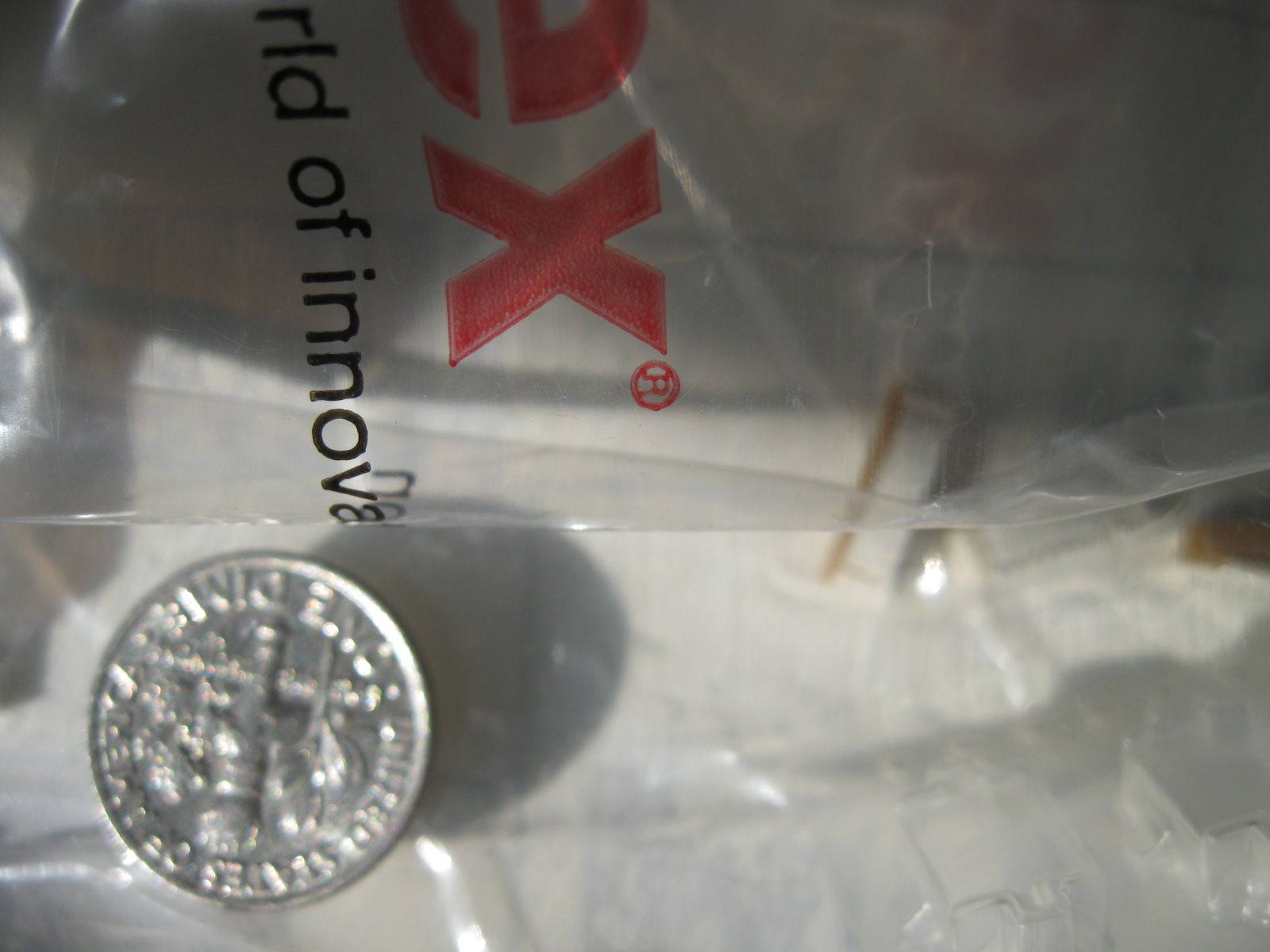

Thanks again, for all advice. Here's photos of my molex connectors; still finding the ribbons; misplaced them (I hope they are big enough conductors for my image sensor focal plane array projects "I-partial" and "II-still-a-dream"). And photos of my '816, in foam. And tomorrow have picture of latest on 6502-o-poly; will post then, but must go find lunch now.

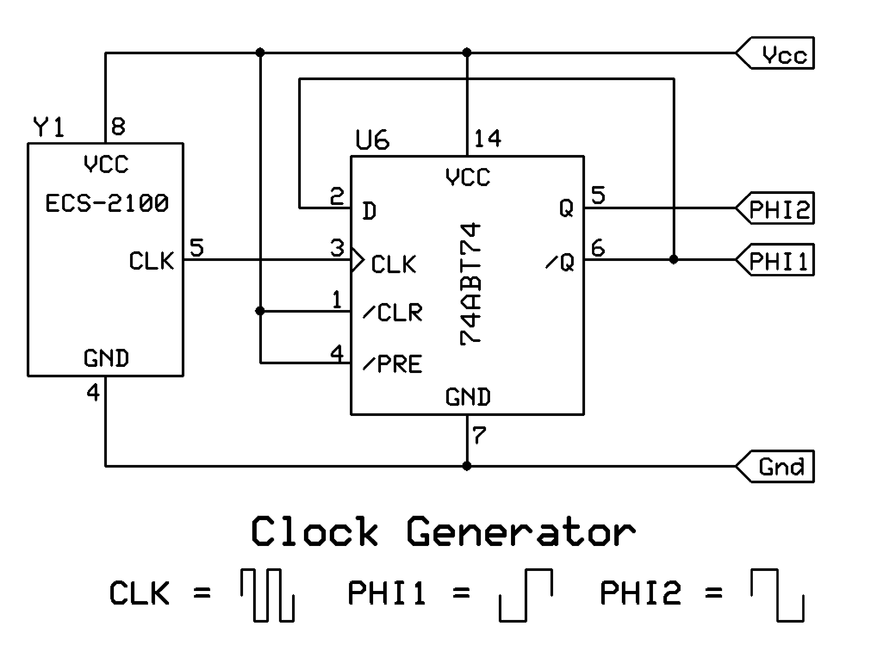

PostPosted: Wed Nov 18, 2015 9:03 pm
Posts: 8509
randallmeyer2000 wrote:
Regarding clock, your primer didn't seem to comment much on the '816. I will read it over again, but from the '816 schematic it seems there is only one clock pin, and it is an input (called Phi-2, I think?).
The 65C816 has only a Ø2 (Phi-2) input, which is the system clock on which all timing is based. It doesn't have Ø1 and Ø2 outputs likes those of the 65C02. Those outputs generally should not be used in new designs, as they slightly lag Ø2 in.
The "ideal" way to generate the Ø2 clock is with a can oscillator whose output is directed through a D-type flip-flop, such as a 74AC74 or 74ABT74.
File comment: Ø2 Clock Generator w/Flip-Flop
The above circuit can be used with a 65C02 (ignore PHI1) or the 65C816. If using bank latching with the '816 the PHI1 output would be used to gate the latch. The Ø1 and Ø2 outputs lag the oscillator output by 6-10ns. For this reason, no reference should be made to the oscillator output.
The resulting output is a very sharply-defined square wave with an exact 50-50 symmetry. The oscillator frequency must be twice that of the desired Ø2 clock frequency with this arrangement.
