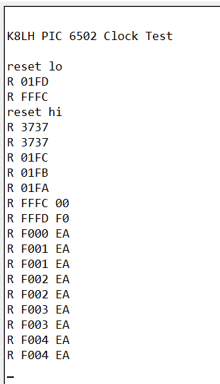

Do you have a way to monitor the data and address lines as well as manually control the reset line and clock the CPU a half cycle or single cycle at a time? Quinn Dunki did something like this and documented it in her Veronica computer project. Anyway, this might help you verify all of your control signals and watch the access to the FFFC-FFFD locations in ROM during the first six or seven cycles after you take the reset line high.
I used a 40-pin PIC to control and monitor an R65C02 when I was starting out and it really helped me get around the lack of test equipment. I used the serial port in the PIC and a terminal program to step through the reset sequence a single cycle at a time. Here's the output from an early experiment;
Later, I connected the SYNC line to the PIC and then I could monitor and display 'S' (Sync/Read) cycles as well as 'R' (Read) and 'W' (write) cycles.
