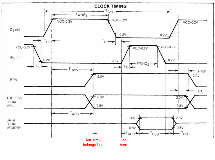

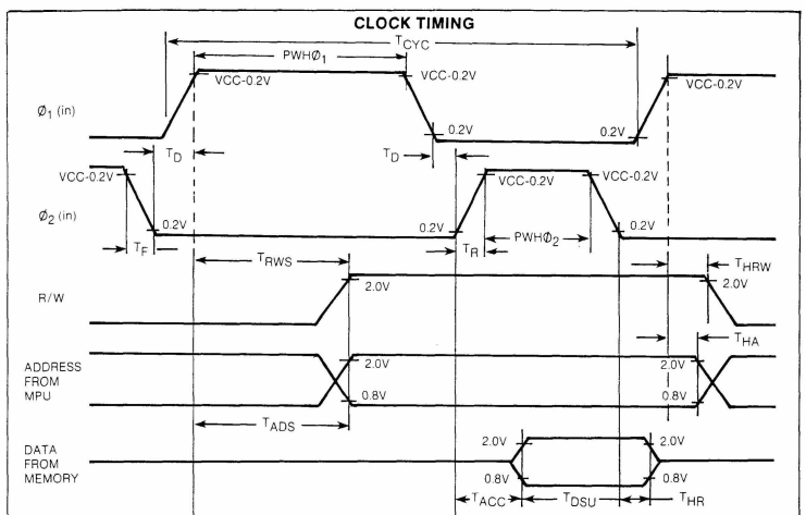

The 6509 datasheet shows TACC starting at the rising phase of phi2 - this should be an error for TACC>phi2 and the corresponding 6502 diagrams show TACC starting at the beginning of address setup?
Going from there to see if I'm correct:
Can I simply take TACC from the datasheet and this is the time I have for memory access time plus propagation delays?
Or do I have to calculate:
Cycle time (500ns @2MHz) - TADS (150ns) - TDSU (50ns - Data Stability Time - is that the correct value??) => Access time 300ns (which coincides with TACC).
So a 150ns RAM would leave me with comfortable 150ns for glue logic?

Bad datasheet! I think TACC has no place on that timing diagram. What the MPU cares about is TDSU.
Datasheet: http://archive.6502.org/datasheets/mos_6509_mpu.pdf

Yes, that was/is the diagram I'm looking on...
Is my calculation above right?
And in case of e.g. a 6522 VIA (@2MHz), which needs address being setup 90ns before phi2 rising, that leaves me with only phi1(215ns)-TADS-90ns(VIA)=35ns for glue logic? =:-O

Yes -- it seems clear there's an error in the diagram. The Memory Read Access time (TACC) begins when the address becomes stable.
