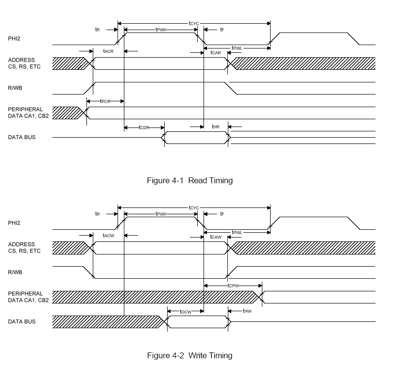

It appears that this is an essential requirement if any of the WDC periperhals (6521, 6522 and 6551) are part of the machine.
If you're not sure, perhaps your post would've been better framed as a question, BDD. Can you explain why any peripherals, 65xx or otherwise, mustn't see the bank bits which an '816 outputs on the data bus during Ø2 low? Although 65xx peripherals are somewhat quirky in that they need their address inputs, chip selects and R/W valid upon the start of Phase 2, that's irrelevant to goings-on of the data bus.
During the 65C816's Ø2 low cycle, and as soon as the address is valid (VDA || VPA is true), selection of a peripheral device is possible. If, say, a 65C22 is selected during what is a write cycle, it isn't in the high-Z state and hence will see the bank bits as data. The timing diagram doesn't really make it clear as to whether such a condition is an issue. Use of the bus transceiver as depicted on page 46 of the 65C816 data sheet would assure that the 'C22 can't be confused by the bank bits. Hence my use of "It appears..."
This should not be a matter of concern with peripheral silicon that has separate /CS, /OE and /WE control inputs, as the latter two can be gated by Ø2 so the device doesn't connect to the data bus when Ø2 is low. That is how I arranged it in POC.
PostPosted: Mon Mar 02, 2015 8:23 am
Now I see what you're getting at. :) You're contrasting the Ø2 and R/W interface used on 65xx peripherals with the /RD and /WR (aka /OE and /WE) arrangement used on many non-65xx devices. And it's the peripheral datasheet you need to be looking at, not the '816 datasheet.
It's true there'd be a problem if a peripheral device connected to the data bus when the '816 CPU's Ø2 is low. And, as you say, with peripheral devices featuring the /RD & /WR interface the problem can be avoided by gating those signals with Ø2 (externally, as on the POC).
The same principle applies with 65xx peripherals. However, with 65xx devices the gating is internal -- no external gates are required. They will not input or output data when Ø2 is low. The 65c22 datasheet spills the beans.
File comment: from page 46 of WDC's 65c22 datasheet
