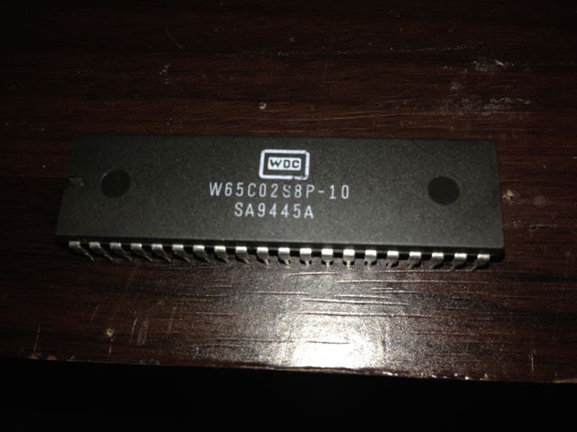

I'm also wondering if it could be a bad CPU, the markings are screen printed rather than laser cut like the ACIA and VIA I have, does this look legit to you guys?

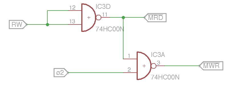

This makes me think the main issue I've got is some kind of hardware issue, here's the schematic for my CPU/RAM/ROM board and the schematic for my board with the ACIA on it
There's probably a bunch of stuff I'm doing wrong, I believe I'm not supposed to use the PHI2 output from the CPU but to supply that to the rest of the system from the oscillator instead?
Maybe there's too much delay in the address decoding logic too?

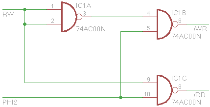

1- You're not qualifying read and write signals to the RAM/ROM chips.... that requires simple logic between the PH2 clock and the R/W signals from the CPU to generate the RD and WR lines. See Garth's site for details.

Would also recommend looking at Daryl Rictor's site and study his schematic for the SBC 2.5 board... it's about as classic as it gets and much simpler. Look at his I/O decoding and wiring up of the 6551 interface signals (RTS, CTS, RxD, TxD, etc.) to ensure you have it done right. Hope this helps.

*smacks own forehead* that probably explains a lot... if I'm not qualifying the R/W I'm probably filling my ram with junk!

I’ll re-do the ram selects, R/W signalling on the weekend to work the same as SBC. fingers crossed.

Well, that's just the WDC part number, what you need to look at is the LOT number which is below the P/N:
W65C51N6TPG-14
A6A749.1
1016G015
The above (and I also bought two from Jameco) are the ones which have the defect. In my experience I've yet to see any code written for the 6551 (including from WDC themselves) which doesn't use the xmit bit in the status register for transmitting data. In short, that means no existing code will work with these chips. That's why I added the simple delay routine, you just waste the right amount of time to allow the 6551 to finish transmitting before exiting the routine. It's just a band-aid and not an elegant one at that.
As for the hardware glitch, well, it happens. When starting from scratch, you can get into a catch-22, i.e., you're not certain whether your hardware is the problem or the software (both of which are new and untested/verified). To ease things a bit (which I did for my first set of boards) I used some (known good) existing code (with the I/O addresses changed for my design) to allow me to verify my hardware worked, then started on writing my own code for it. I still have a version of the old source code which has the delay routine and works with the bad chips. More than happy to send it along if you'd like to try it. It takes one unknown out of the equation.
I may be misinterpreting the above, but you don't want to quality the chip selects with Ø2. Only qualify RWB. Chip selects should become valid as soon as your glue logic can make them valid. This is especially important with 65xx I/O silicon, which must have chip selects and RWB valid before the rise of Ø2.
W65C51N6TPG-14
A6A749.1
1016G015
*snip*
I've had a look and the lot number is exactly the same on mine :(
If you could send me that code that'd be great, the whole time I've been assuming it's been a software issue because while I've done a bunch of programming before this is the first time I've touched assembly.
I'll find out on the weekend when I change things around I guess :)
Sorry you're right, I'm terrible at explaining my thoughts etc, this is what I've got and applies to the OE input of the ROM and OE + RW for the RAM

You should have this
And connect all /OE from ROM, RAM etc to /RD and connect /WE from ROM, EEPROM etc to /WR
That's essentially how I have POC wired up. cbscpe's circuit doesn't simultaneously assert /OE and /WE during write cycles, a combination that may be undefined in some hardware.
Note the use of 74AC logic in the illustration. Beware of excessive cumulative propagation delay, which can easily build up with 74HC or 74LS logic. 74HC ("high speed" CMOS) logic, despite the name, is on average no faster than 74LS.

Ahh ok, I've changed my design to match that now, and I've ordered some 74AC logic IC's
I can't seem to get the '85 or '688 comparators in anything faster than HC though, I presume that won't be a problem at 1-5Mhz?
