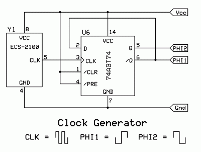

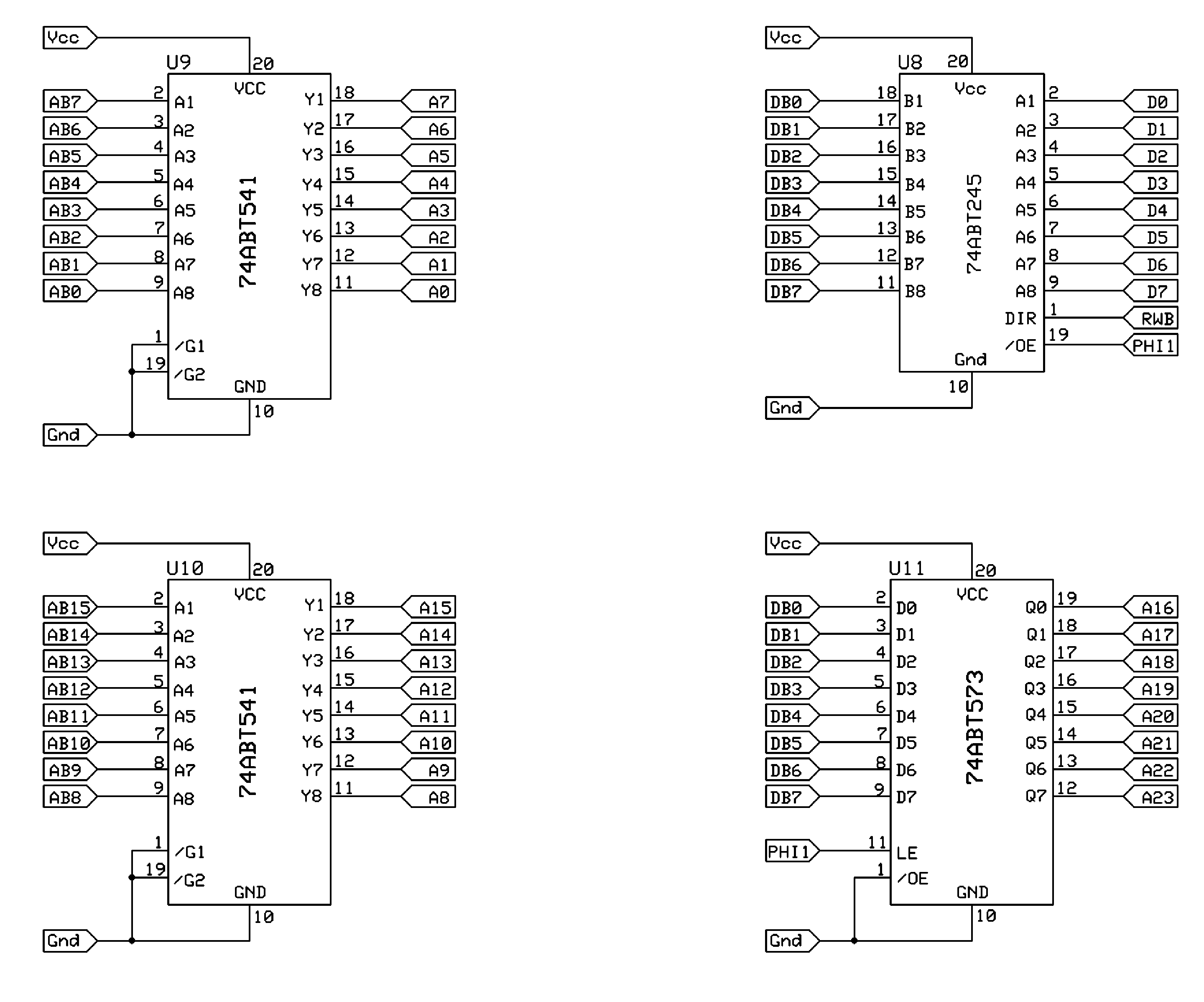

Okay, so I've reached a suitable stopping point for my current VCF activity, so time for me to make some more progress on this front :D!
In order to interface to a development board, I need to be able to route the 816 bus off the board unfortunately. If I design a preliminary bus "standard", would someone be willing to critique it for me? My dev board uses a 40-pin male IDE connector for GPIO, so I'd need to use a female IDE connector that solders underneath the PCB. I know this is explicitly not recommended in the primer- I'm willing to take the risks to life, property, and my assets in this case.
I'm actually doing the paper design now... I'll start out simple, as suggested in previous posts... '816, RAM, ROM, VIA, 6551, and two banks (mix of code/data, or one code and one data- haven't decided yet). Since this is effectively will become an exercise in creating a DMA controller, however, I want to get started on that as early as practically possible. Might be an odd goal for a project, but since this is a "toy CPU system design" anyway, I have no qualms about it :P. And besides, might as well USE the not widely used features of the '816 :).

In which case, I suggest you look at using drivers for the address bus (74AC541, for example, two required) and a transceiver (74AC245) for the data bus. The drivers and transceiver will help to mitigate the effects of bus loading. Note that everything should be on the "downstream" side of the drivers and transceiver to avoid inadvertent signal skew. Bus termination will likely be necessary to control ringing, an area where you may have to experiment to achieve satisfactory results. Thevenin termination may suffice if the aggregate bus length isn't too great.
You will also need a latch for capturing the bank address (74ABT573 or 74AC573, the former is the faster part) and a two-phase clock generator to control the latch and transceiver output-enables. See attached clock generator schematic, as well as bus logic example—ABx and DBx connections on the drivers, latch and transceiver are connected to the MPU's address and data bus pins, respectively.
Note that use of the clock to determine when the transceiver should be active doesn't automatically meet the requirement of not reading or writing during Ø2 low. That is accomplished by qualifying RWB with Ø2. Such qualification is not necessary with the W65C21x, W65C22x and W65C51x, and should not be applied—connect RWB of these devices directly to RWB on the 65C816.
Also note that VDA and VPA must be consulted in determining when to latch the bank address. A number of instructions cause the '816 to generate false address bus states during intermediate execution steps, especially when indexing is involved to determine the effective address. If the expression VDA | VPA is false (| meaning logical OR) then the address bus content is undefined and chip enables must not be asserted. However, during that time, your DMA controller could temporarily become the bus master by negating BE—the '816 will continue with what it is doing. If one or two "dead" cycles don't give the controller enough time to accomplish anything, then it will have to "forceably" kick the MPU off the buses by negating RDY and BE (in that order), do its work and then restart the MPU by releasing BE and RDY (in that order). The MLB signal would have to be factored into any bus mastering as well.

File comment: Two-Phase Clock Generator

File comment: 65C816 Bus Drivers & Bank Latch Example

One other thing I forgot... I was looking up whether I'd need bus drivers or not, and Garth's post in this thread states that typically, you do not need them for the CMOS parts:
Between bus capacitance and the output-buffer and timing specifications of WDC's 65c02 being quite conservative, actual use becomes much easier than one might expect. What you are proposing and asking is rather common for newcomers to the 6502, but far more complex than necessary. The bus buffer for example will only slow things down, and it's not needed even for DMA since WDC's 65c02 has a BE (bus-enable) input pin (pin 36 on the DIP), ML (memory lock) output pin (pin 5 on the DIP), and VP (vector pull) output pin (pin 1 on the DIP) so you can tri-state the processor's buses at appropriate times for DMA.
DMA aside, if you can get away with 32KB of ROM and 16KB of RAM (or vice-versa with a small change) and up to 10 I/O ICs, the diagram at http://www.6502.org/users/garth/project ... chematic=2 will do the job using only a single 74xx00 for address decoding, and even leave one section available for something else. Gate delays are minimal, so you can achieve high clock rates. I need to update my pages on my workbench computer to reflect recent expansion, but I am still using this glue logic scheme. With 4MHz parts, the first problems show up at just over 7MHz at room temperature, so I run it at 5MHz for some margin. I have hundreds of systems flying in aircraft with the same scheme, and none has ever had a problem.
For an initial system, even with DMA, I can see the logic. However, what happens when the drive strength of the '816 is no longer sufficient when you start adding more peripherals? Will the new delay from the bus drivers cause the initial design at the original clock speed to go kaput? And would a hypothetical DMA controller need to disable the bus driver as well, or would the BE pin be sufficient?
I can't think of any conflicts offhand, but just for "preventative maintenance :P", would the addition of a bus driver on the address/data lines cause any conflicts with the process of cycle-steal DMA?
I should probably look at the original IBM PC schematic for an example...
